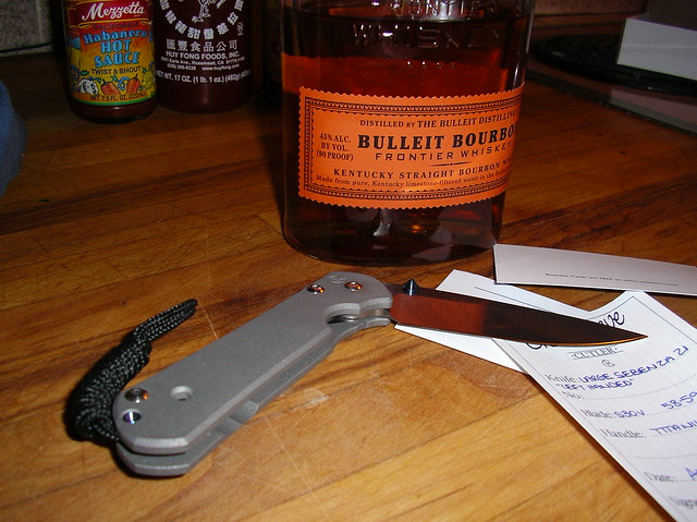

If im not mistaken it looks like the fake is missing the heattreat on the lockbar face.

As for the lock: it can be heat treated, but bead blasted over, that's why I say use the suckker and see how she wears, where the lock face wears and how the lock engages, those are key aspects of a real seb that is focused on in the production process.
When selling on the exchange request pictures of the date stamp on the inside scales. The fakes do not have them as well as the CRK logo, those are the first give aways when there are no papers.
Wow that is kinda of scary to be honest. It may not be good to test the knife and release the results, do you really want to perhaps promote a counterfeit product (even bashing it, can lead to sales this is the internet after all).
This is the box it came in along with the lanyard pin. As you can see the box is not even close and isn't even trying to fool any one I don't think. The difference in the finish of the lanyard pin is again the telling thing. You can see the out side edges on the CRK pin are much better finished and chamfered. It is also made of a different alloy as the colour is different. Not sure of the weight difference as my scales are out of action just now.
People are asking if the knife is more obviously fake in hand, well, it is and it isn't. It's funny, while the shape and proportions of the handle are the same one of the most noticable things to me is it makes a different sound when handled. It seems odd I know but I'm not joking. The most obvious thing anyone can pick out though is machining marks, CRK folders do not have machining marks. This is one of the main things people should be looking out for at this time, along with less than great finishing.

Thanks for posting. Obviously these imitators are getting better at what they do. I wonder how the fake knife performs? Does it have the same tight tolerance, F&F, and weight as the original Sebenza?
F&F is not as good as the Sebenza.
Tight tolerances are not going to be seen through normal use, at least I can't notice any difference. I predict the high tolerances will be shown with age and use, because of the tighter tolerances the wear can be planned and accounted for which is what I am seeing with Sebenzas.
Weight I am not sure, probably a bit heavier because of the thicket blade?
