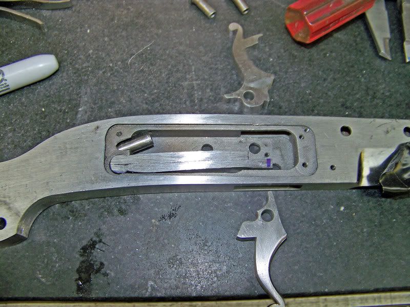

All the company left so I finally got back to work.

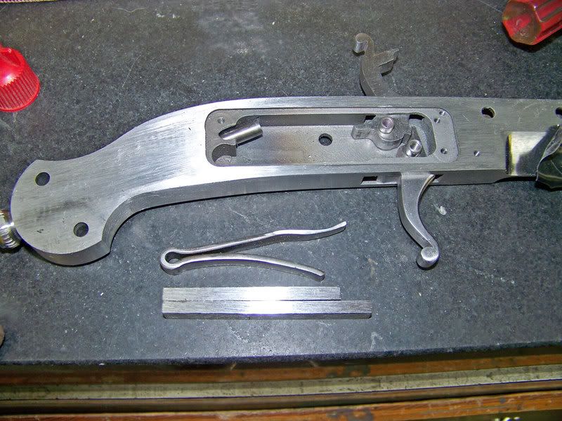

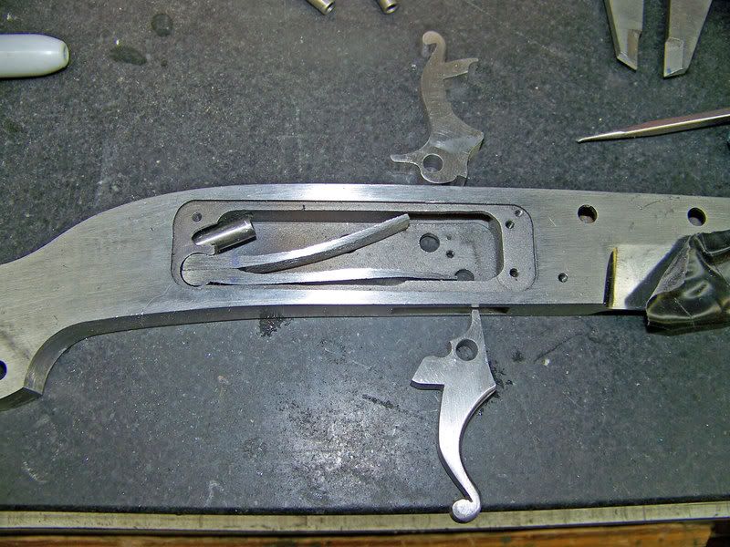

Here is the new hammer and trigger spring. This one is two separate 1095 springs that slide into place back to back.
Here they bent to shape, heat treated and the beginning stages of shaping. Before I can test them I need to remove the scratches (stress risers) and round off the square edges or they may snap.

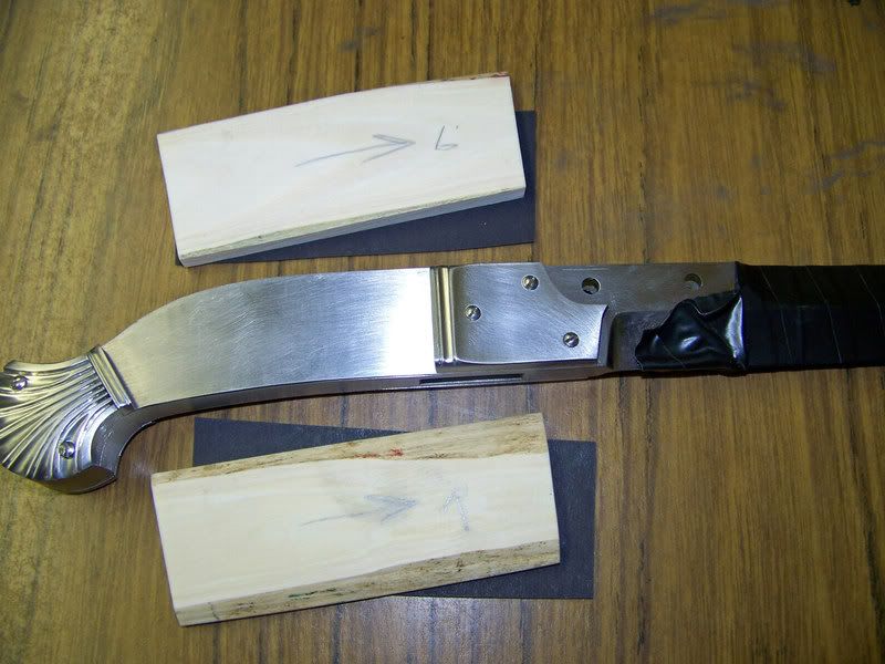

The pre-ban ivory slabs arrived so I can begin fitting them. I flattened the back sides and super glued on a thin black fiber backing.
I decided to use white ivory and have a border scrimmed on them instead of mammoth that is so hard to find just the right set.
Stay tuned to see if I take off to much and have to use them on a miniture
bruce...what is black fiber backing?.....do u just use it to make a contrast between the ivory and the steel or is it a structural thing.....thanks alot....it looks great....not like u needed anyone to tell u that!.....ryan
OH BOY IT'S GETTIN THERE! This is amazing Bruce thank you very much for sharing the most awesome process. Like any true master, you know what you are doing and make it look easy :) .
The spacer material is also sold as "Vulcanized Spacer" and is available in most all the knife makers catalogs. It comes in .015" thick and I use it to seal the back side of the ivory and to add a black contrast to the liner.
