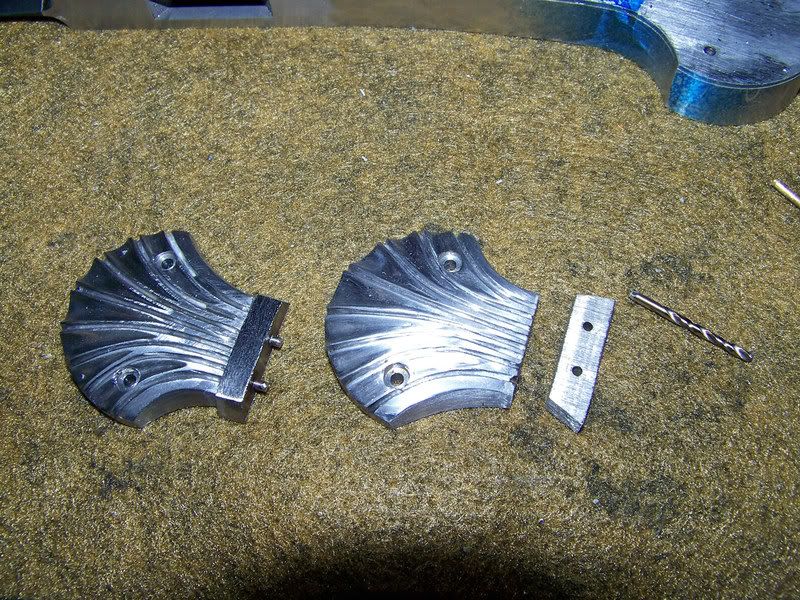

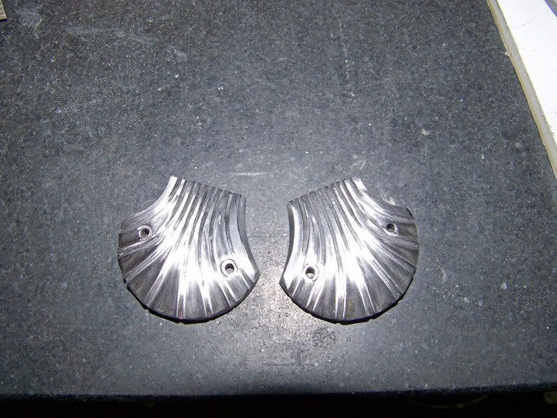

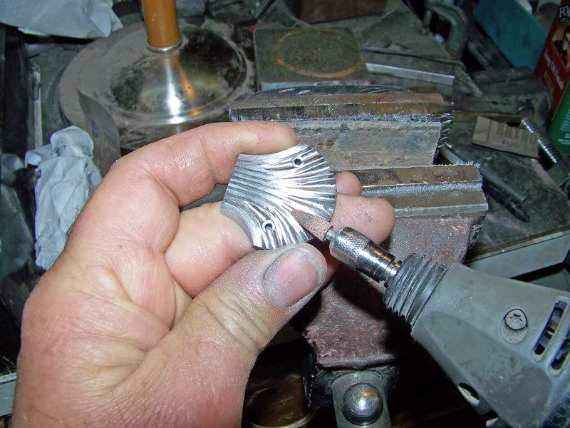

Whew! I spent all weekend on these shell pommels. They still need some final sanding and polishing but for now there done.
I used round files, the dremel with cone shaped stones, cratex polishing burrs, the scotchbrite wheel, buffer and hand sanding.
I need to counter-bore the mounting holes deeper
Sorry for the flash in the photos but later they will show up better. I hope.
Here are the spacers just ahead of the shells. These will give a good transition for the handle scales. Both the front bolsters and these rear spacers will be grooved to match. They are drilled and pinned with the same drill bit used as the pin.

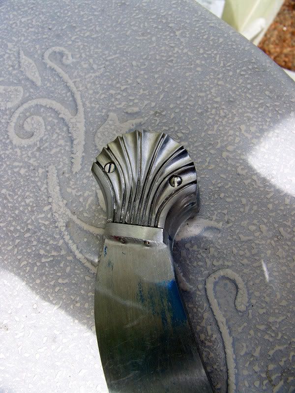

bruce.....i know you are the master designer here.......but a quick question....why the screws in the shells.....is it a feature like a take down that they have to be removed for cleaning...without seeing the piece i would think it would be cleaner looking without the screws......don't take it the wrong way....i was just wondering if they need to be there.....ryan
It is a "take down" gun. Everything is bolted together and can be dissasembled for cleaning and servicing. They also hold both liners in place at the pommel end. I agree it would be cleaner without screws and if this were a knife it can be done but its a gun and needs screws.

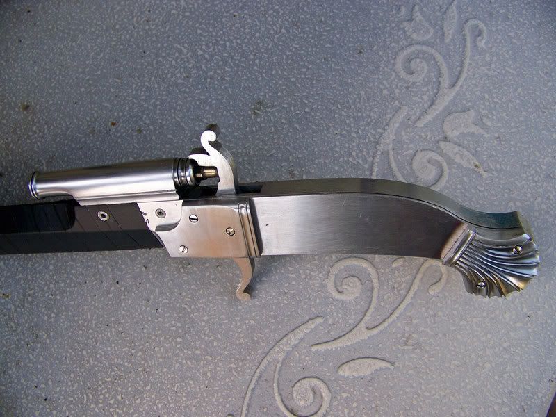

Heres the latest. I put a musket nipple in place of the standard #11. It has a cap that is large and easy to handle plus has the benefit of larger threads and doubles as a brass breach plug. The musket cap stays in one piece when fired unlike the smaller #11 that explodes and scatters fragments of copper sometimes embedding them into my hand. The disadvantage is the spring is now too weak. I never liked that spring anyway, besides looking like a cotter pin I just cant make it stronger so I will make a new one next week from Dans 1095.
I also have the front and rear bolsters finished.
It is just a couple days away from sending it off for the engraving.

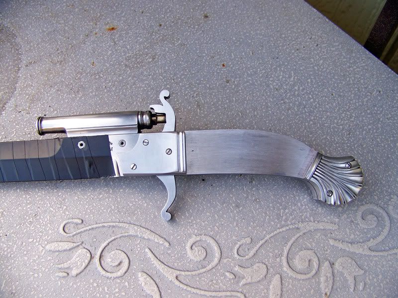

Im undecided on handle materials and finishes. I'm thinking about color-case hardening on the front and rear bolsters and the barrel. The frame and blade would be hand rubbed satin steel. I like pre-ban ivory but I think this one needs some color. Do you think amber dyed stag would look good? How about value? Ivory seems to put a piece in a higher value bracket than anything else.
What do you guys think?
I'd go with some mammoth with nice bark or the ivory. Especially if you could get some simple scrimshaw done on it. It really is just beautiful!
Thanks Eric
As for the scrim on mammoth it would have to be very light cream colored, which you dont see much mammoth that color. It would look good with scrim around the borders of the ivory and leave some bark in the middle. :thumbup:
My vote would be some colored bark mammoth with a framed checkering design on it for the scales,otherwise the scrolled scrim like on Deadwood would look really cool also.

Good suggestions so far. It's interesting to hear what others visualize. I have worked on this for a couple months so far and am almost tired of looking at it.
The scrim on the Deadwood handles is really engraved on. A good engraver can use the same tools on soft materials too. Its nice and deep.
You know how mammoth ivory is ground away and sanded smooth around the edges when fitting to the frame, I think a nice engraved border on light colored ivory would give this thing some style. The scales with the darker bark colors in the field but cream colored and engraved around the edges. Whew! I like it.
