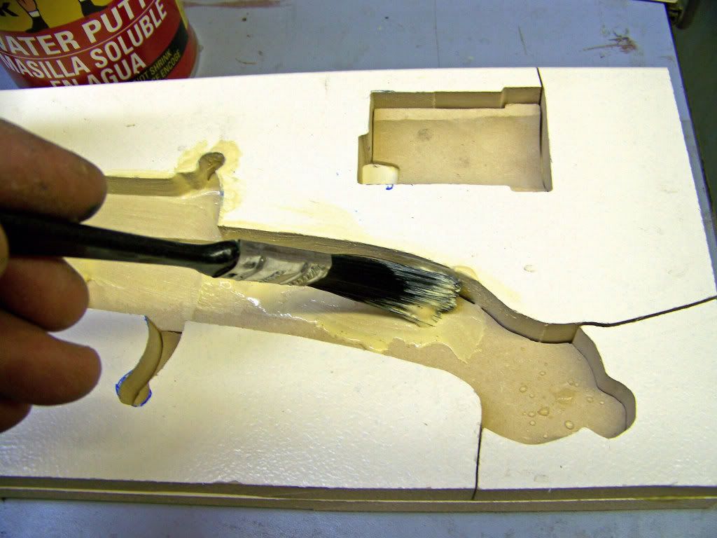

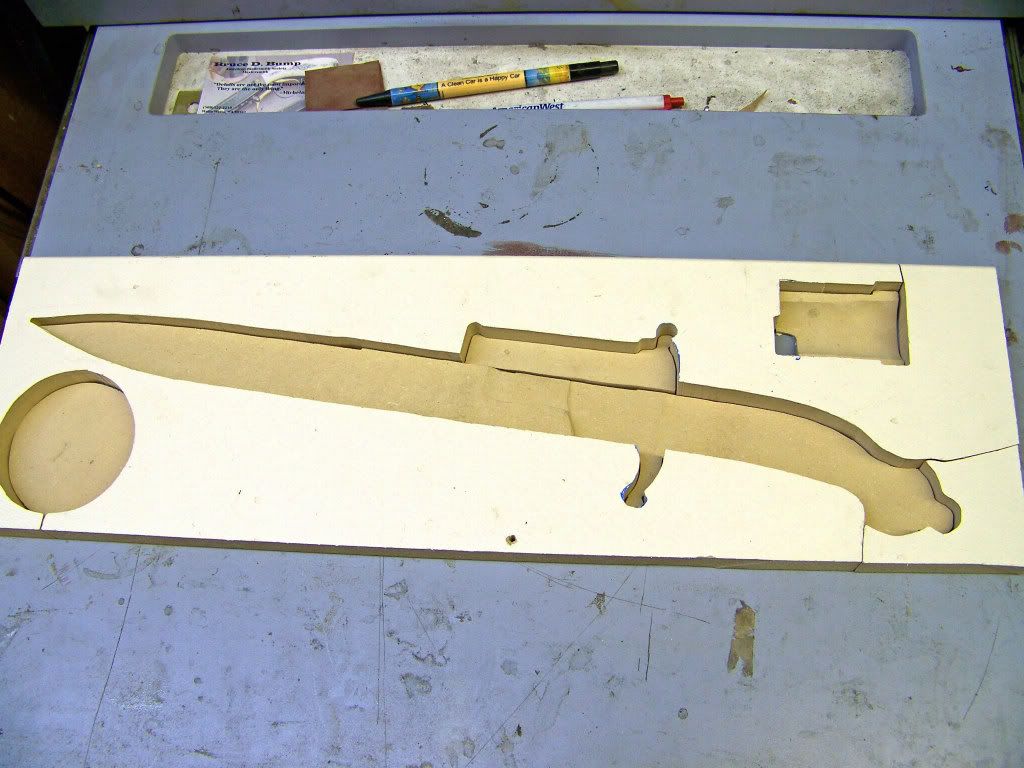

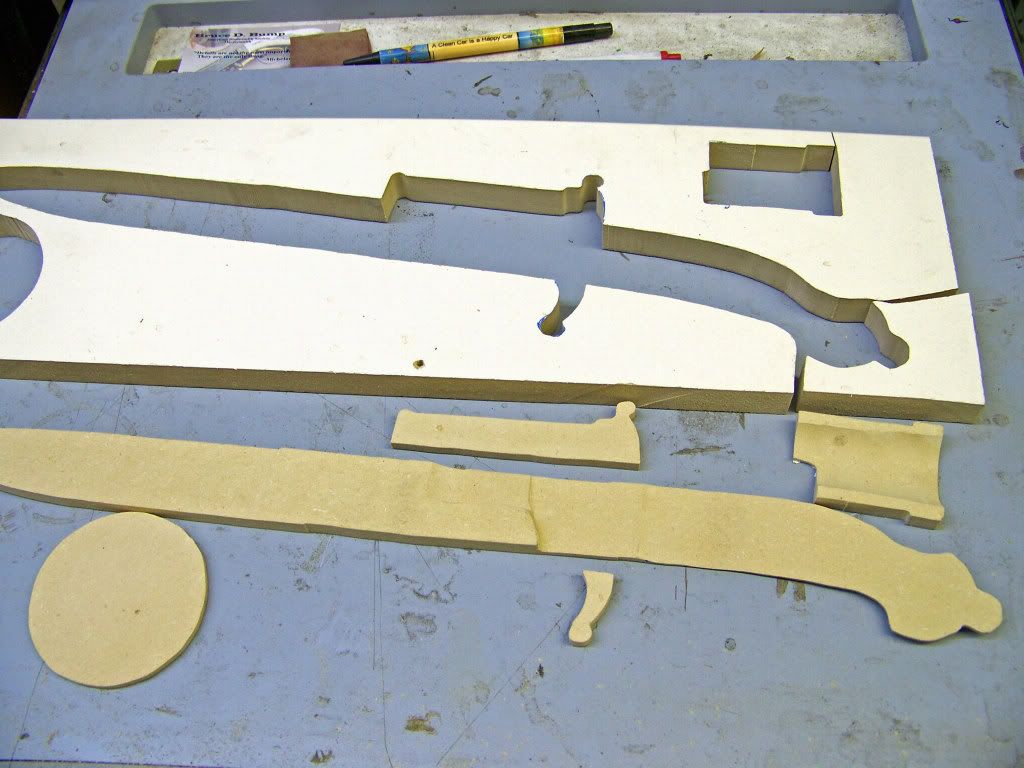

I use the Home Depot variety pressed sawdust interior only wood trim. I like it because it sands and shapes very well.
I just use a jig saw and cut out the tracings of the gun, powder flask and bullet box. Save the pieces because they will go back in the same holes after they get cut down to the proper heights.

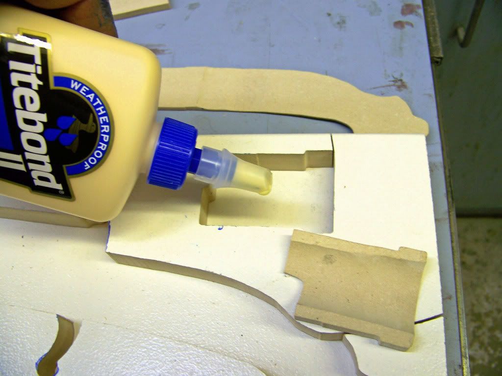

I use wood glue to put them back in after they are sanded smooth and adjusted so the gun and accessories stand proud about the same height
Nes I use wood putty to fill all visible seams and saw marks. I want the interior smooth.
I coat everything with the wood filler/putty and let it dry well. It will need to be sanded and all the sharp edges will need to be rounded slightly so the flocking will not chip off.

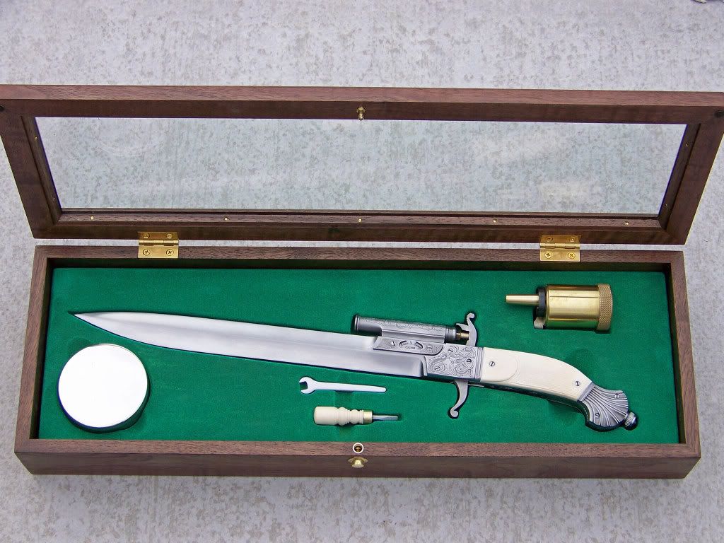

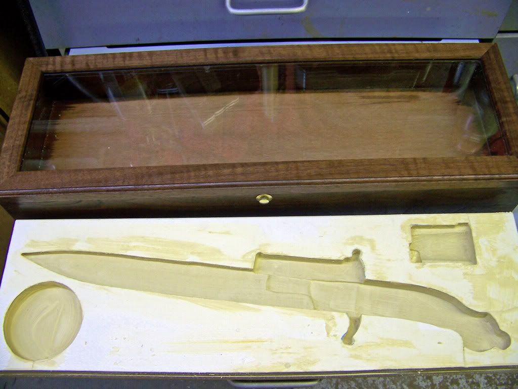

Here is the walnut case I had made for it. I also had a name plate engraved with the title "Tortuga"

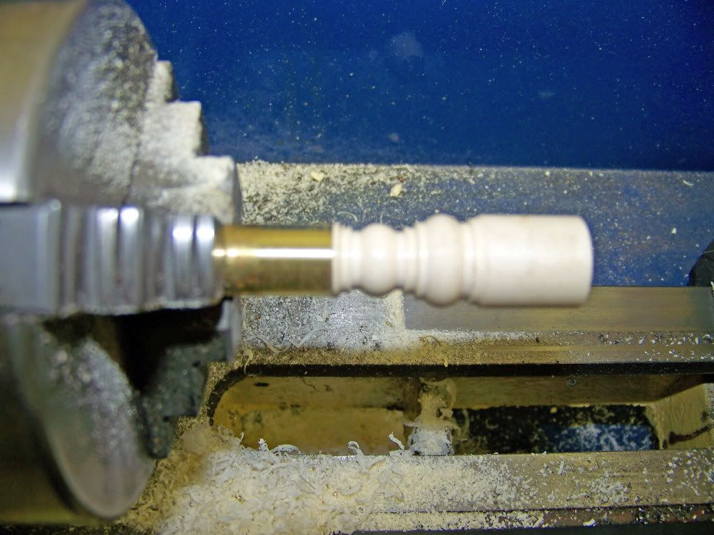

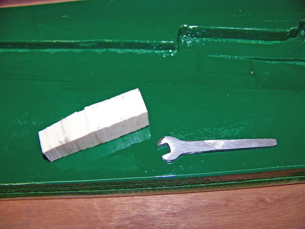

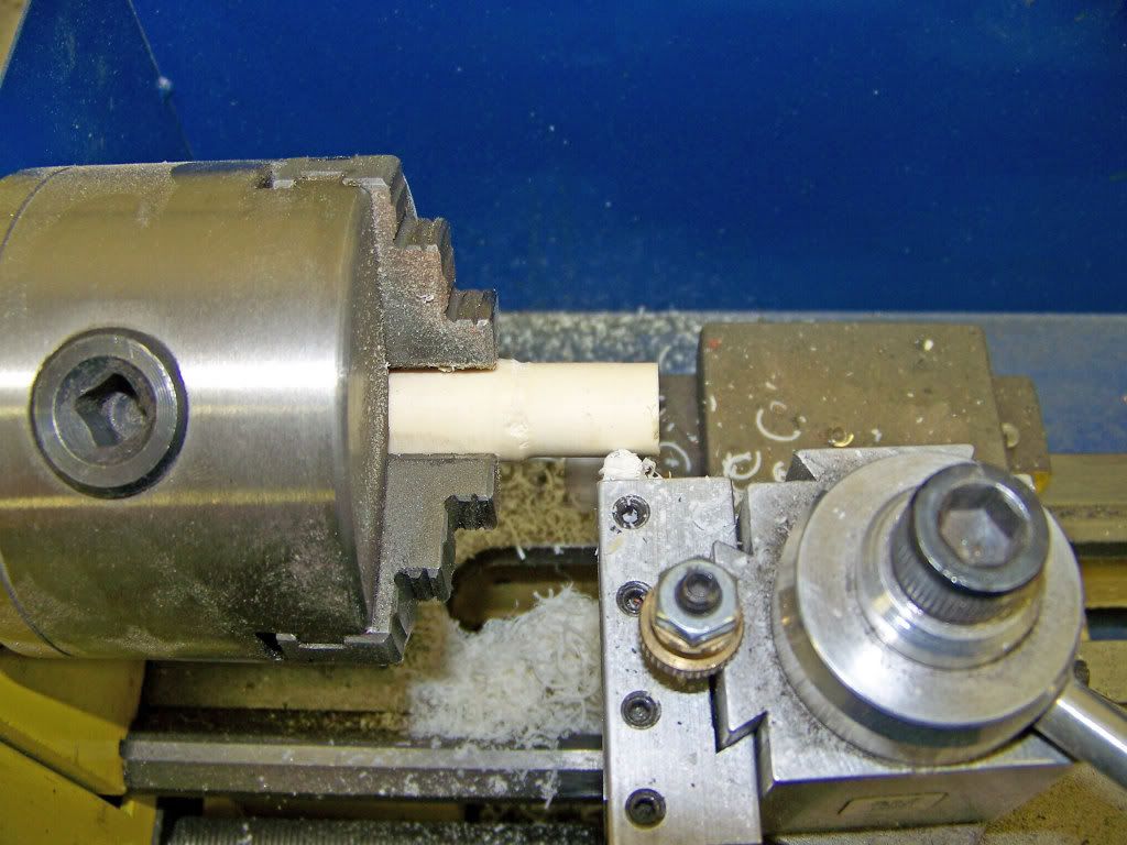

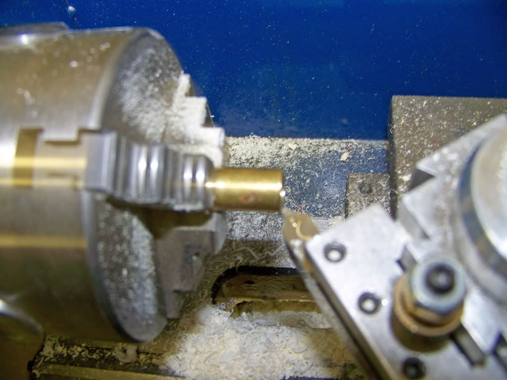

I decided to add a screw driver and a nipple wrench to the set. The wrench is a modified 1/4 open end and the screw driver handle is made on the lathe with an allen wrench ground into a flat tip.

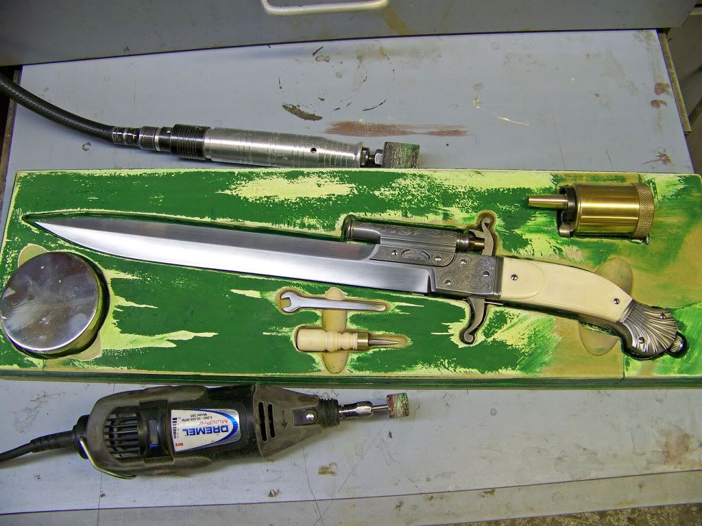

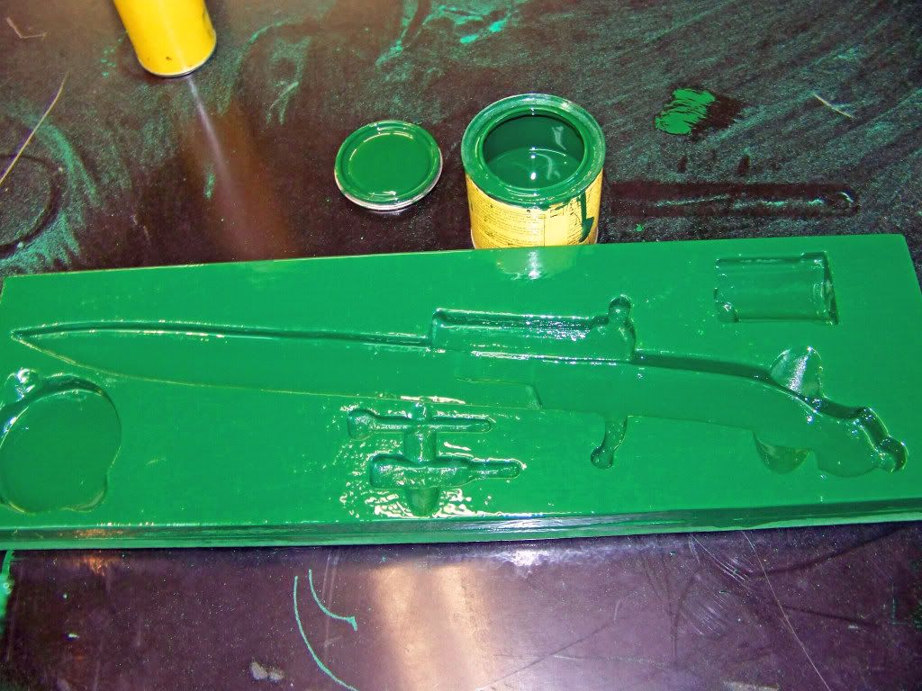

Here I have the interior block sanded, primed and sealed with clear laquer and all ready for the flocking. Everything finally fits.

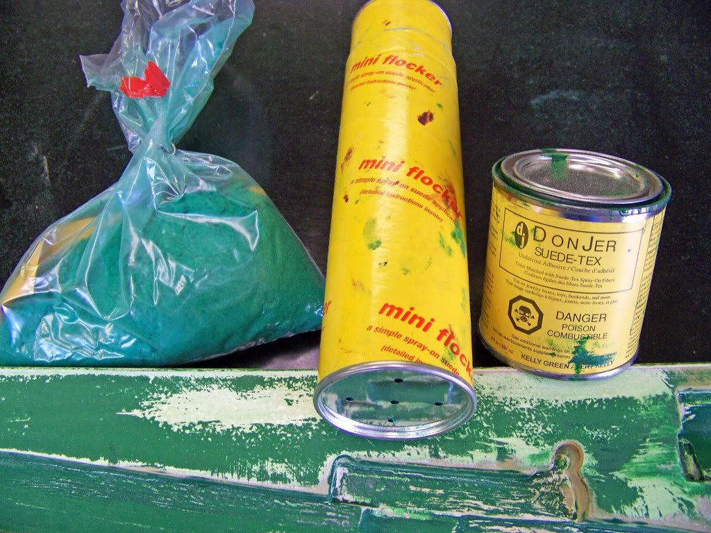

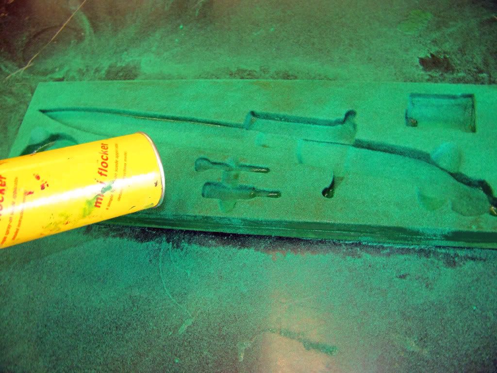

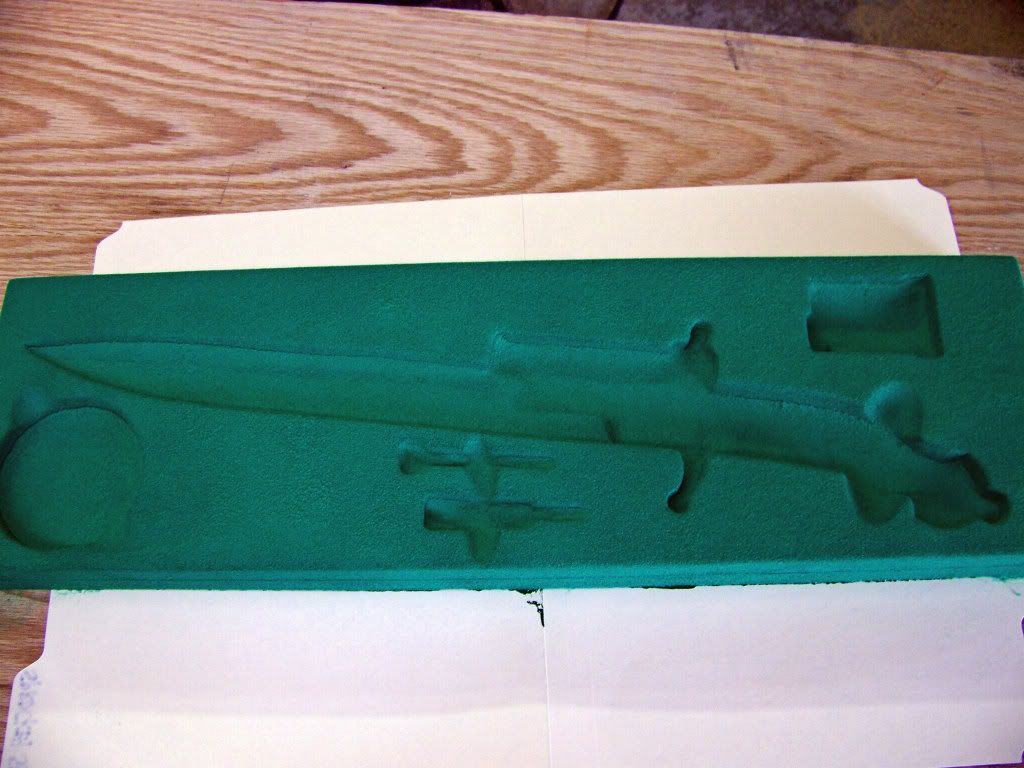

The flocking I use comes from Lee Valley. This stuff has been around for many years but is kinda hard to find nowadays. It comes in several basic colors. I used to have maroon but they discontinued that color. I like the green.
The adhesive is exactly like the old lead based paint and needs thinner to clean the brush. Simply paint it on evenly and pump the flocking particles on the wet paint. I put it on very heavy and blow out the excess after it dries in about 24 hours.

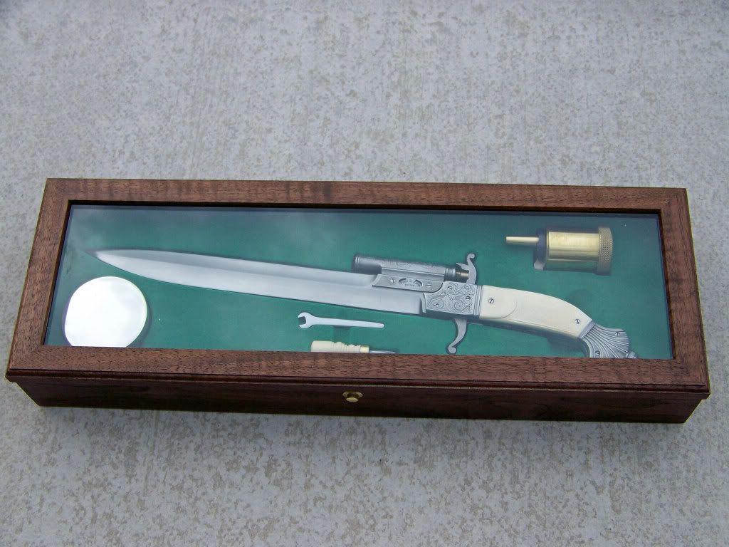

Its been 24 hours now so I can set it together and see how it looks. I like it.
There is some finish work to do on the gun but I still have two days. No sense waiting until the last minute.
What do you think?
