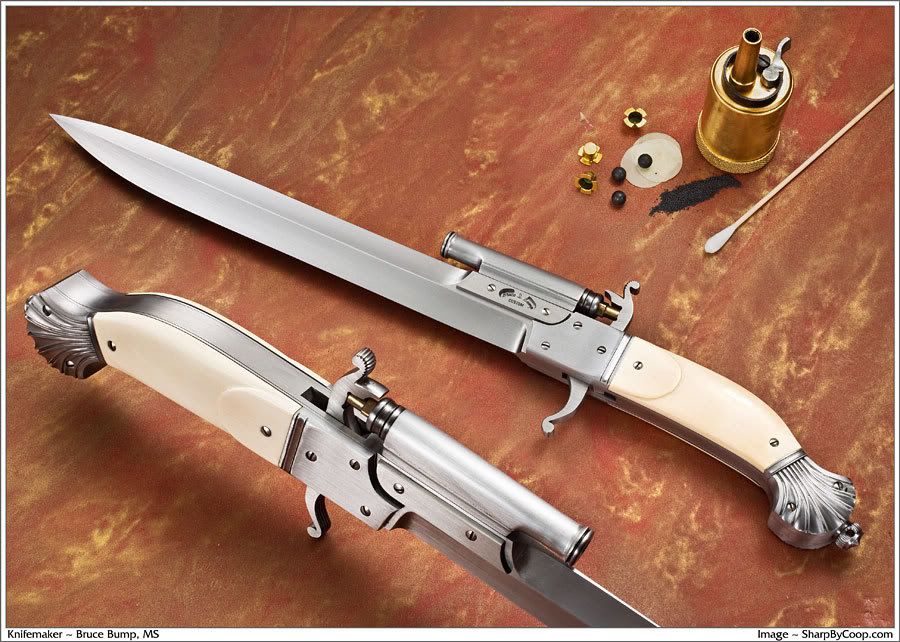

Here is nice image of the finished piece taken by our own Jim Cooper at Josh's Hammer-in last weekend. Its the last picture you will see of it until I get it back from Jere Davidson fully engraved. I can hardly wait to see what Jere does with it. I told him it was French and I didnt want gold anywhere. He should be done by the first of August for the Montana Show.

I've followed this thread since it's begining and it has been the first thread I look for when I come to BF. Looking at all the cool pics of this piece as it has progressed has been a real treat!
The last photos are simply stunning!
Great work from a great artist!!

The finished piece looks incredible. I'm having a hard time imagining how much more amazing it will be with the engraving!
