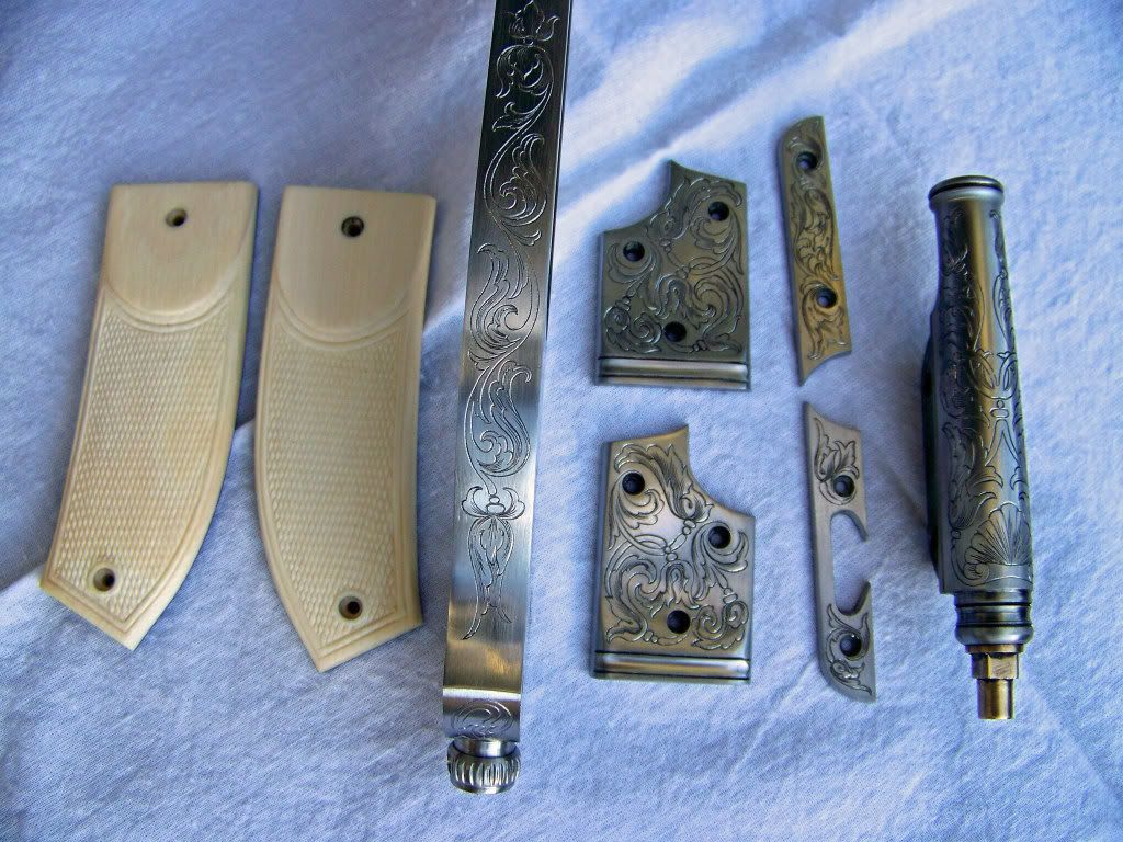

Bruce, I love your work, I go to your web site often to admire. I Love what you've done with this one and can't wait to see it engraved. Thanks for posting, Dwayne
The engraving job came back yesterday from Jere. He searched and found an original 1700 century design by French engraver, Jean Le Pautre. It looks very different from the scrolls we see now.
The same day the grips arrived from Blaine Barlow. He did a most excellent job on the checkering. He said ivory doesnt checker easy and charged accordingly.
Next comes the French Gray process, which I've never done before so I hope it goes well.

good god almighty!.....it looks beyond great....could u describe what french greying is bruce.....i would assume it's similar to blueing.....are they similar....any major differences....ryan
Its a process that doesnt turn anything blue, instead it turns shiney metal grey. The parts have to be finished to the same very fine grit (in this case I'm going to 4000) and dipped in a weak solution of Nitric acid for a few seconds until they turn grey and quickly into boiling water/baking soda to neutralize the acid. While still hot they go into oil to lock out rust. Care must be taken forever to prevent rusting. I think thats why museum pieces are in such bad condition.
I'm nervous about it but bluing wouldnt look right on this one.
Bruce, Now you learned all this while being a prison guard and I thought it was all about getting the most out of your toothbrush. I can't imagine the tremendous amount of patience not to mention the skills that went into creating this Masterpiece. Just another bump on the log for you. Where's the picture on the final finished piece?
:D I learned all this from prisoners!
I want to have another picture taken after all is done. I have a walnut box being made for it too. Thanks Ray!
Bruce, that is just outstanding! When Ray called this a Masterpiece, he nailed it. I can't wait to see the final pictures. You've really inspired me - get ready for my dumb questions in a few months! :D
bruce...are the pices already finished to that high grit before they are engraved?....i would think sanding them now would ruin the engraving....thanks for the info....not like i'll ever have the skills to make one but it's still interesting learning about it....ryan
They are finished to 600 before engraving and afterward need to go up in grits. Some of the lines are fine enough to be sanded away if I were to go back below 600.
