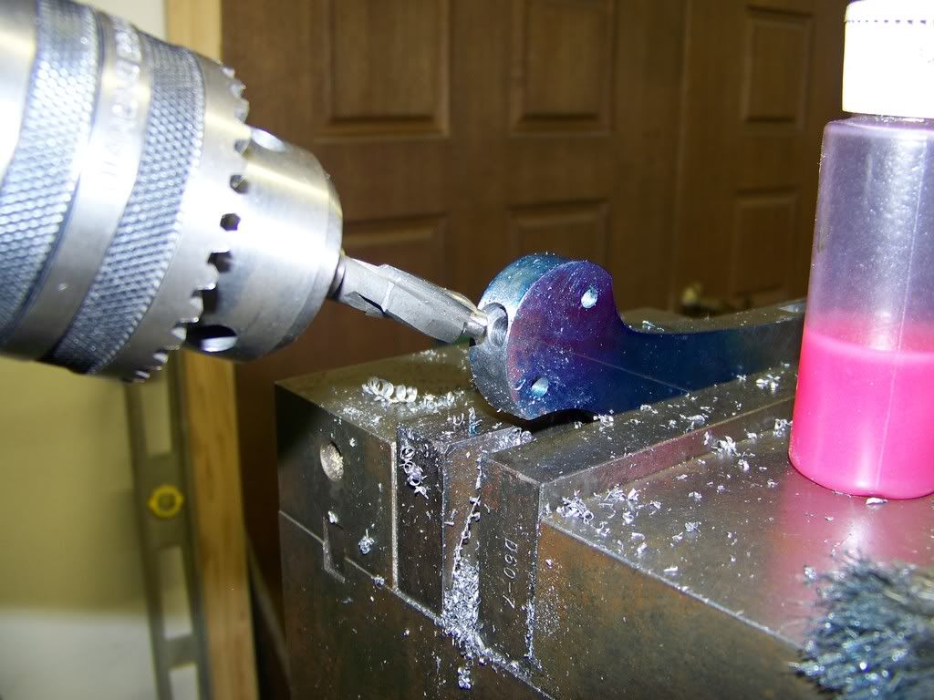

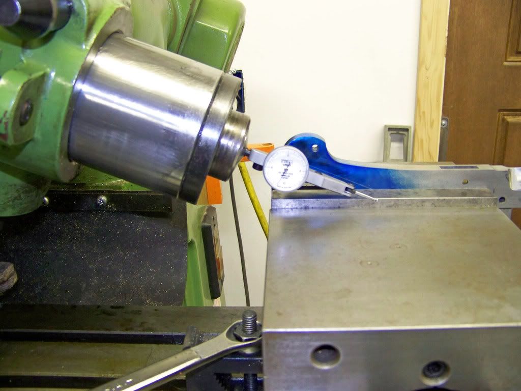

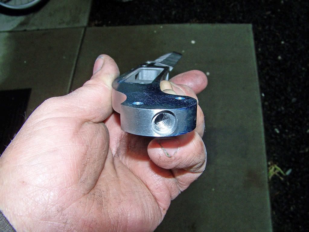

I set my Grizzley mill to an angle and drilled the butt to accept the ram rod.

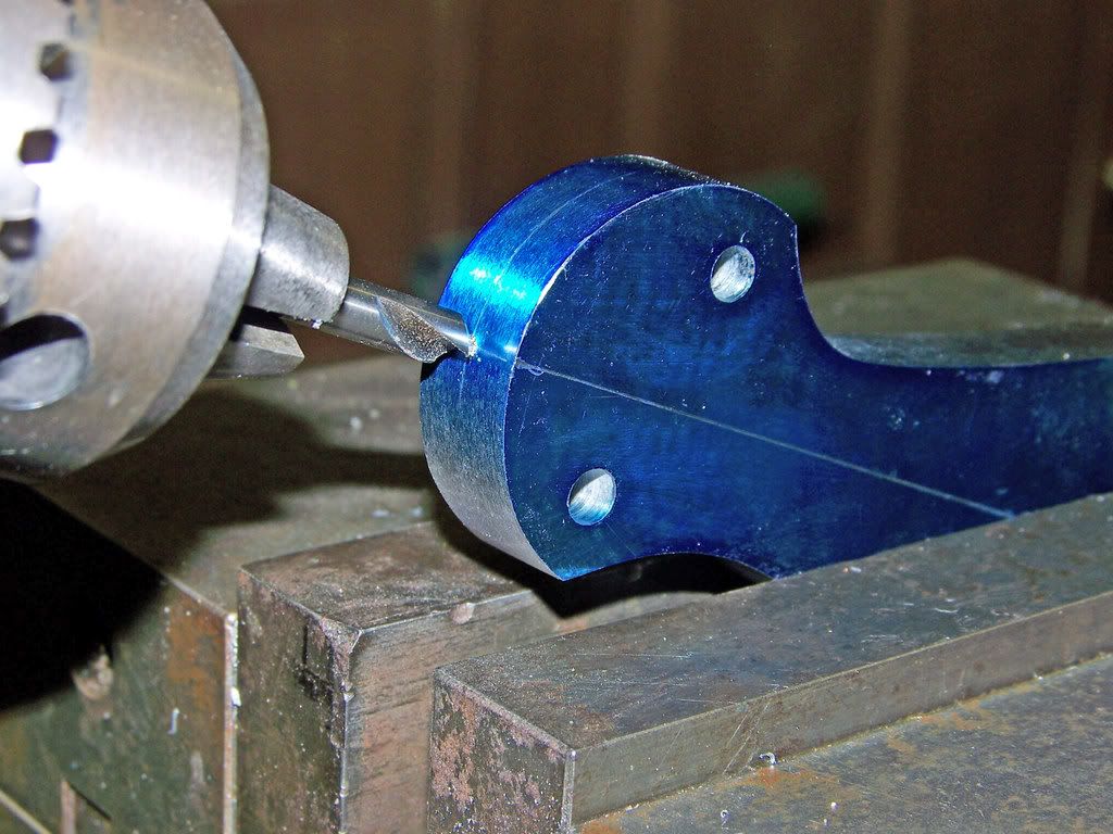

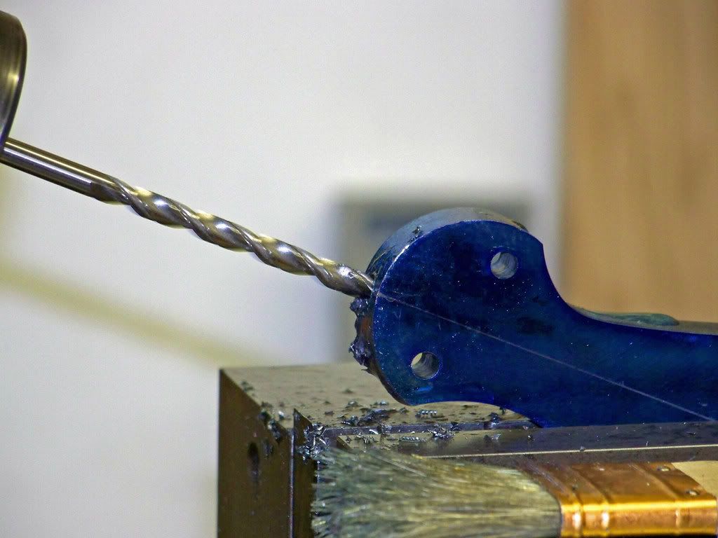

Here I have the hole drilled and tapped for 5/16 coarse threads and counterbored to accept the ram rod.

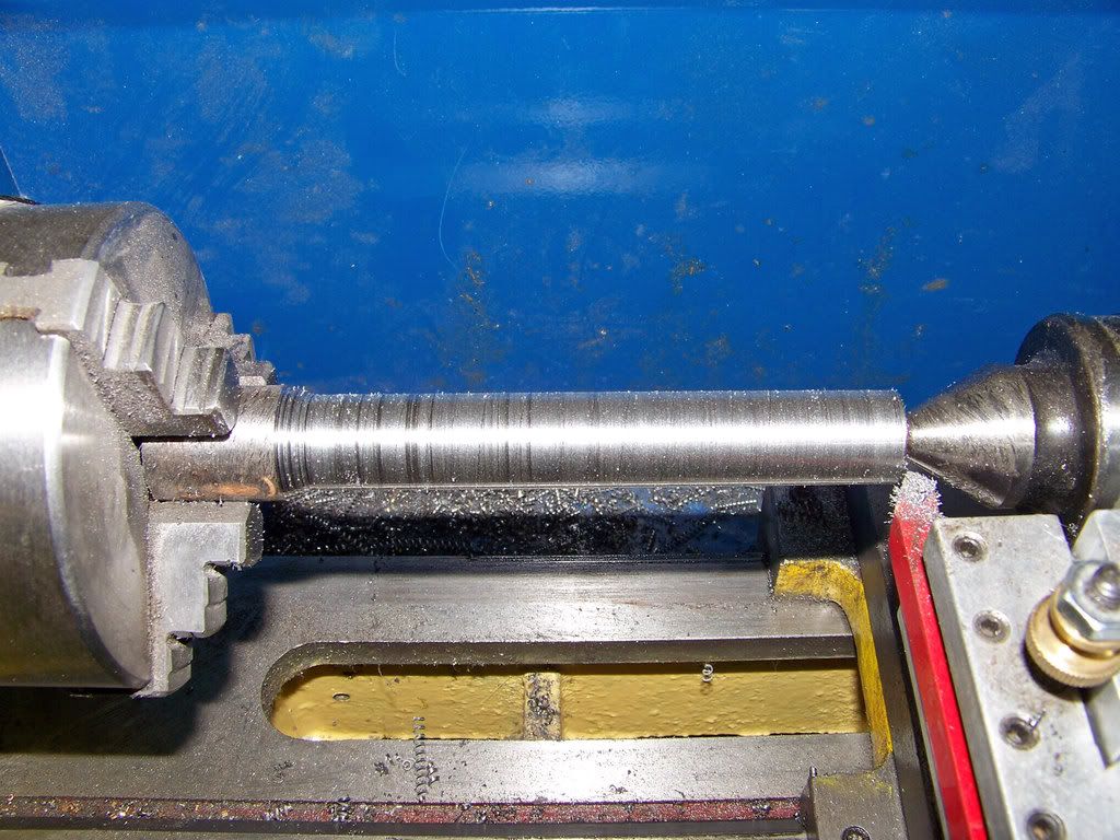

Here is the ram rod in its early stages on the metal lathe.
