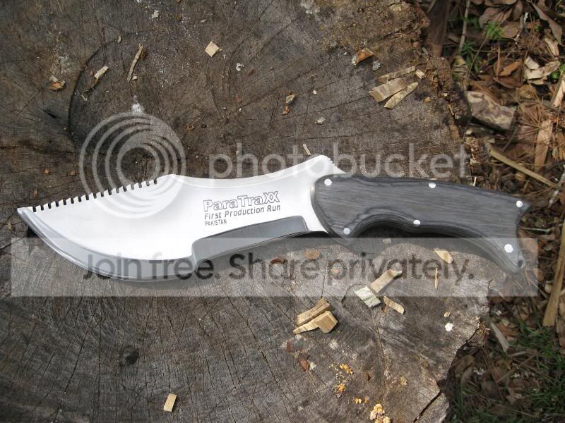

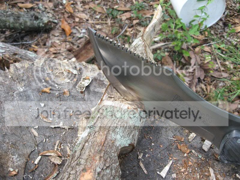

Here is the Pakistan copy. It is called the ParaTraxx. Steel is 420J2. The sheath is plastic. The wood composite handle is pinned on. These sell from $15 to $60. This model has a longer blade of 7.25", so it has better balance for chopping. This knife is lighter than the TOPS version and made of thinner stock, about 3/16" thick. I sanded the sharp corners of the handle for comfort and gave it a decent edge. I lost the little knife that fits in the handle. It fell out during testing some place.

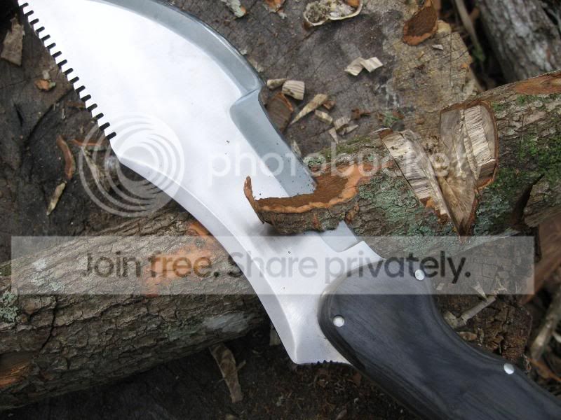

The sawback works well for making nice square notches.
The knife actually chops reasonably well for the size and weight of the knife. The sweet spot is right in front of the curved part of the draw knife section.
The draw knife cuts well enough.

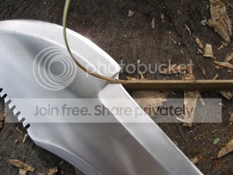

The "hook" is useful for rounding out a peice of wood, as I did on this skewer made of palmetto.

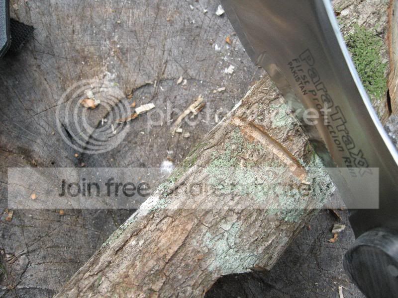

Things started to go wrong when I beat on the knife with my baton to split some maple.

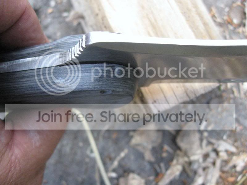

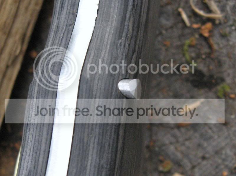

The handle started separating from the shock, and the pins started working loose.
I suppose I could just remove the handle and epoxy it back on, putting some on the pins, too. But I just don't like this POS enough to do any more to it. I know Pit will have better luck with the TOPS version.
