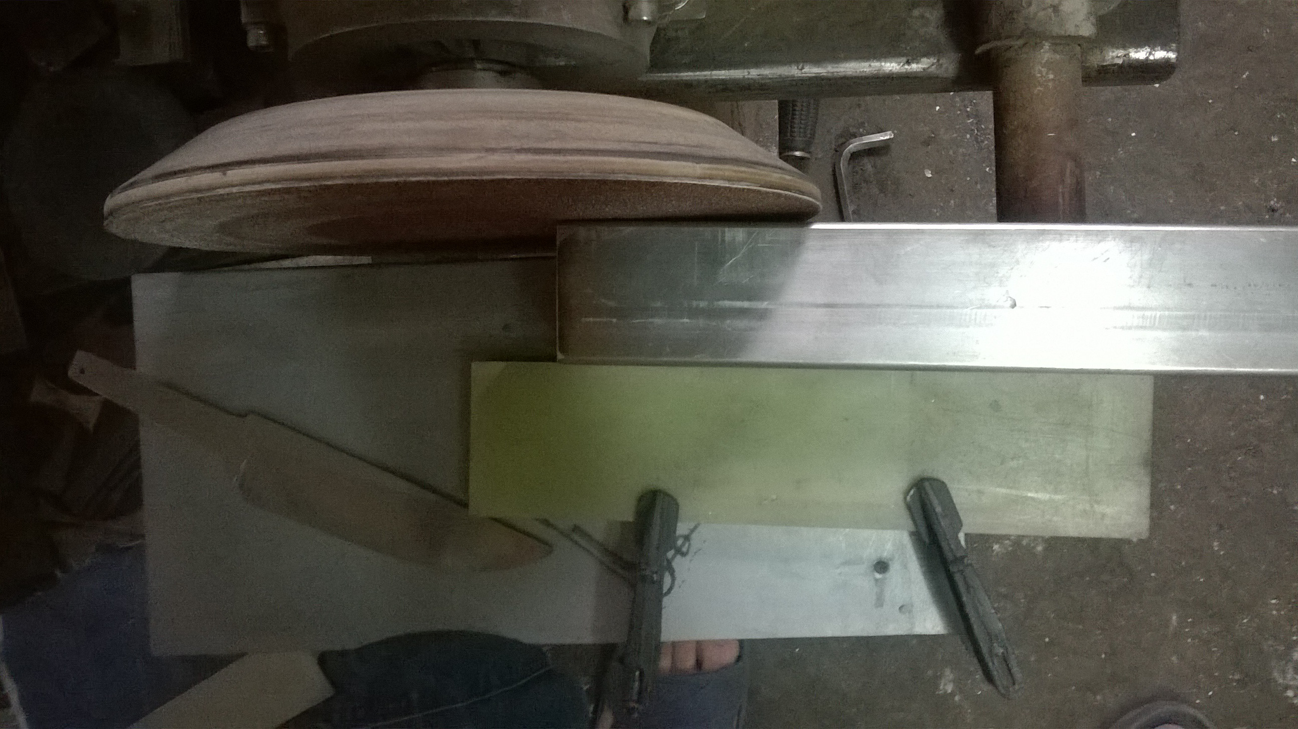

Why do you guys complicate such a simple thing? Every honor of yours craftsmanship , but........................This is how I would taper tang if I decide to do that . You can do this on 2x72 Belt sander , but I think it is more easy on disc sander ......
Set rest plate on 90 degree to belt , calculate the angle , attach some piece as guide for jig on rest plate , scribe two line on tang , fasten the blade on jig and grind that taper ? 100/100 repeatable and 110/100 accuracy !
My English is not very good and I think this picture will explain better .....
You'd be surprised how fast and easy it is to freehand.
Its like grinding bevels. At first a jig is a lot faster and easier, but if you take the time to really master freehand grinding, freehand will be faster.
Guys like Bob Engnath could completely rough grind a knife just in the time it would take to attach a blade to the jig. Obviously he wasn't exactly the average knifemaker, but I'd be willing to bet a lot of makers could taper tangs faster freehand than with a jig or fixture
I move my grind up from the butt. Scribe my lines and work from there and push it higher and higher. This way I can stop when I have reached where I want to be. To me a jig is just to ridged. Knife making is a art and takes skill, so many people are trying to remove the skill part of it. We work hard to learn the needed skills. I'm not saying jigs are cheating I'm just saying spend more time learning and less time trying to get around learning.

i see the pics. someone earlier suggested he taper up to the front of the bolsters, and he went a bit farther by accident i think. i do it like loveless, taper stops before the guard so the guard has a flat spot to rest on. natlek, how does that jig work ? are you getting perfect ( to the eye anyways) results with no gaps ?
