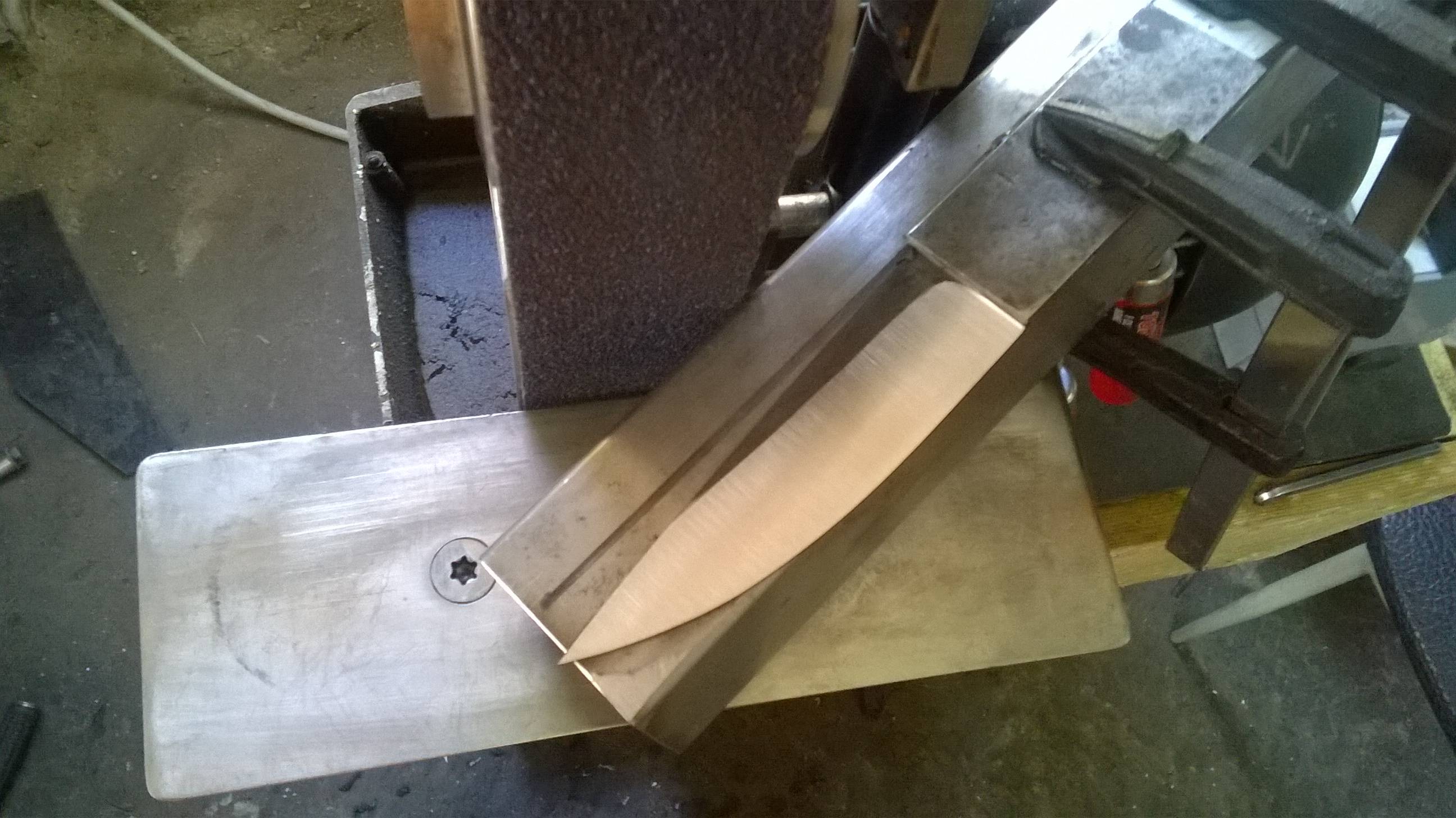

I move my grind up from the butt. Scribe my lines and work from there and push it higher and higher. This way I can stop when I have reached where I want to be. To me a jig is just to ridged. Knife making is a art and takes skill, so many people are trying to remove the skill part of it. We work hard to learn the needed skills. I'm not saying jigs are cheating I'm just saying spend more time learning and less time trying to get around learning.
Words of someone who build new machine every month :)Why you build forge press ? I know that you have skill to do that with hammer :D Look , why I would spend my time learning something that need very very long time ....here we call that ... experience .Experience don t come in a day ..... Ten minutes ago I grind this up with jig and all that on 6400 SFPM and 40 grit ceramic belt , take minute . How many vaste steel and time I will lost till I get there freehand ? .Jig is so simple , grind too , make feel good :thumbsup:
Where not taking the time to learn freehand becomes an issue is on more complicated blades. For things like that a jig works great.
But what if you wanted to make a recurve hollow grind with a sweeping plunge line? I'm not aware of any jig that could do that
Took these pics as I was working on this today. Tapering is the last thing I do before sending it off to heat treat, may blade is completely finished prior to tapering. To protect the finish I use several wraps of masking tape. The layers of tape offer protection against damaging the blade should you present it badly to the platen. Also the tape offers remarkable resistance to the grinding belt creating a little more control as you move the taper up.
As already explained by everyone, a hollow grind down the guts of your tang removes metal quickly and makes the actual tapering easier. Once the hollow is established I find it easier to start the taper by holding the blade at right angles to the platen. Once I have it started I present the tang to the platen with the tip up. The magnets that have been mentioned are a must have.
The bulk of the tapering is done with 50 grit and I finish with a few passes of 100. Final hand clean up starts at 320 Rhino and then on to finer grits. Another point to remember is the more you taper the less likely you are to shoot to far forward.

Well ,if I tried one more time to grind free hand most likely I would have destroyed this blank :) How do you grind free hand thin steel in the name of God ???? This blank is 1.5mm 1.2519 hardened steel and it is too flexible for me to grind freehand . No that I know to grind free hand , but on thicker steel i can grind close and then with the jig to make small correction so I do not throw it in the waste basket all that previous effort .
It's easy to see on the picture what is free hand and what is grind with jig :) But I like challenges, I will learn that too ,the left side is a problem, right side I can do even now on thicker steel .....:mad:
