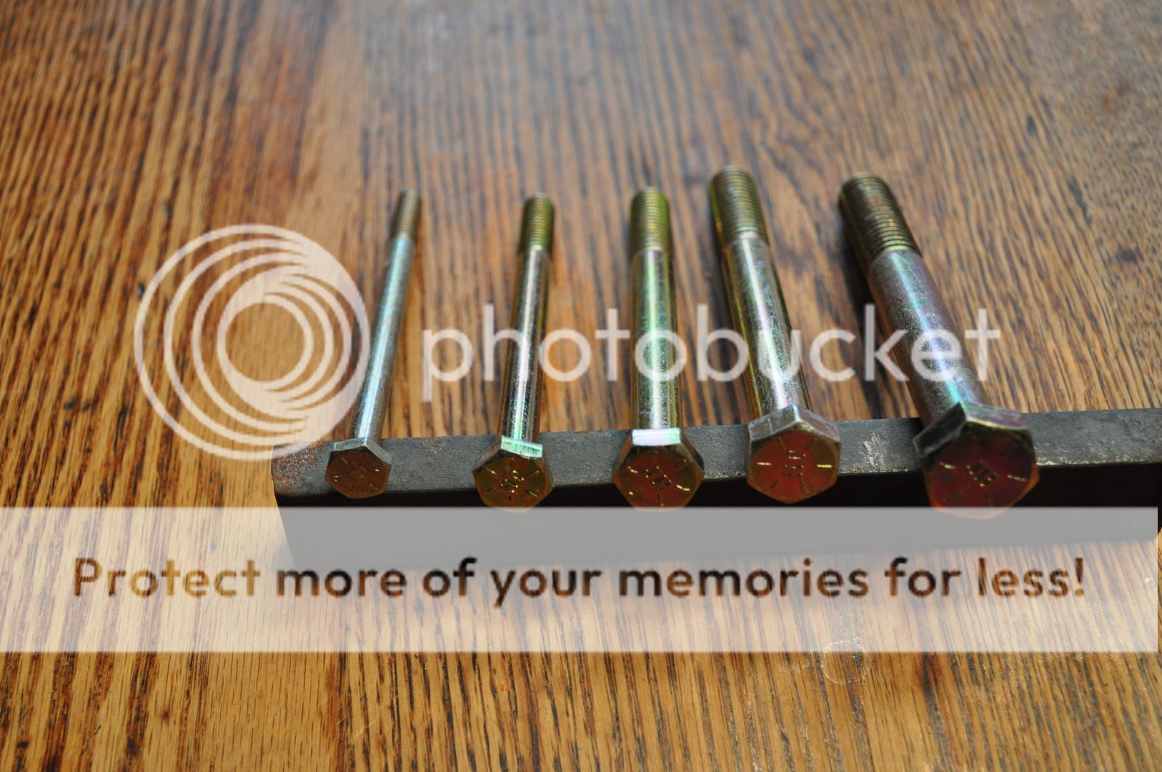

Hope this helps you out. I use grade 8 bolts of different sizes as a punch to drive out handle remains from axe heads. Grade 8 are strong, you can get them from any hardware store. They are rather cheap and have worked well for me. I also have a few pieces of scrap steel that I use as a drift. I found those at a garage sale.

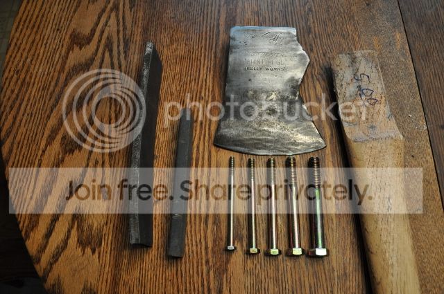

BTW, a 1/2" bolt as a drift got the remaning crud 3/4" of the way out before progress stopped. I'll attack it again next weekend.

I'll try the bolts. I was using a 1"x3" piece of metal from something else, but the bolts would probably work better.
A short section of old axe handle makes a decent punch, too. Just rasp it down so it'll fit through the eye.

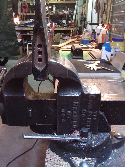

I've removed only one permabonded handle. The haft was so chewed up by misses that sawing it off caused me no pain. Then I drilled through it from the bottom several times and pounded out the bits between the holes, also from the bottom. There was no metal wedge, only more permabond in a kerf. The PB surrounds the haft and fills any voids in the eye, but there was still a layer of rust which probably helped in breaking the bond.

In this pic the haft is still attached and I've just drilled the first three holes.
