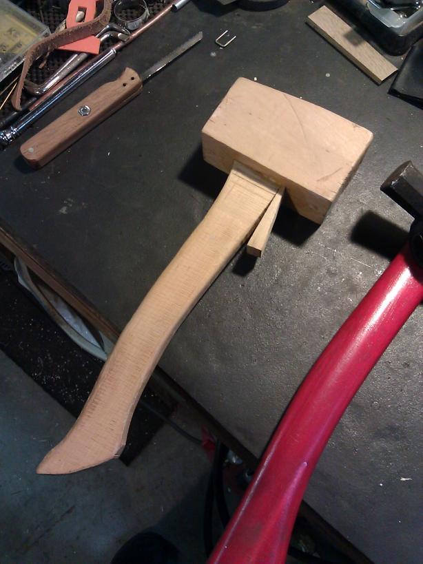

Here's the little one.
After I made the BIG axe mallet, I had to make a smaller one that was actually a usable size. This is it. You can tell I didn't spend a lot of time on finishing since I was already behind due to having made an un-wieldable mallet the first time...
After posting earlier, I realized I can probably improve the little one's handle mating. There's a major engineering flaw in that the socket in the head isn't nearly deep enough, and the parallel, socket-length area on the handle is similarly too short.
However, it can be re-done a little and probably be good for awhile.
Tonight I pulled the silly nails, wrenched out the handle, cleaned the glue out a bit, loaded it back up with a LOT of glue, and gave it a new wedge. It's drying now. Tomorrow I'll cut the wedge off about 1/2" from the head.

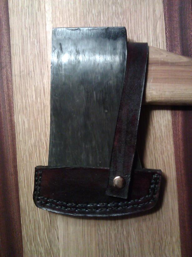

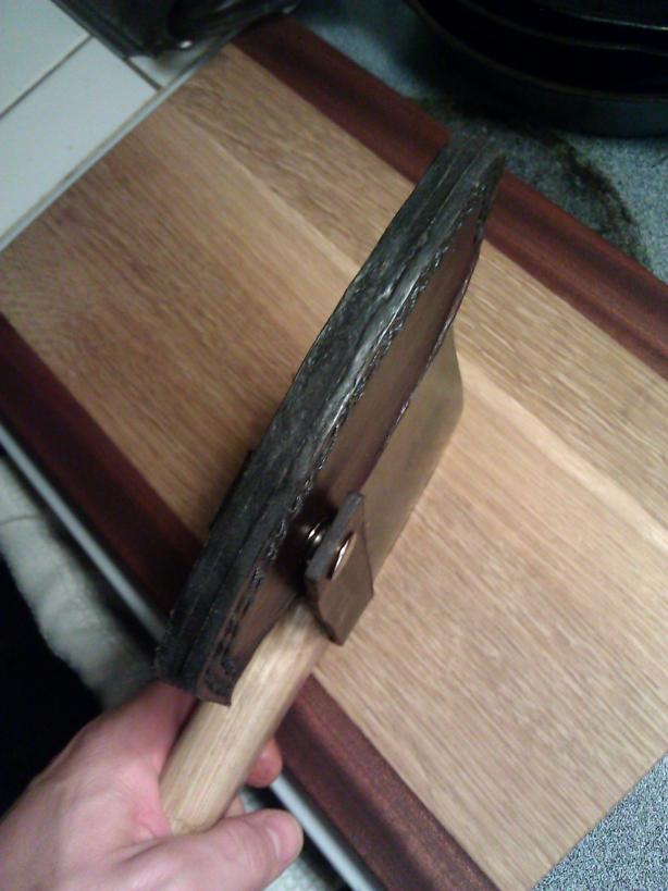

made a simple edge cover for the Plumb.
Next one will be even simpler...
No super fancy work here. No edge skiving etc.
That'll work!
I really don't like the fact that the Swedish axes come with masks/sheaths without a welt. Very poor design.

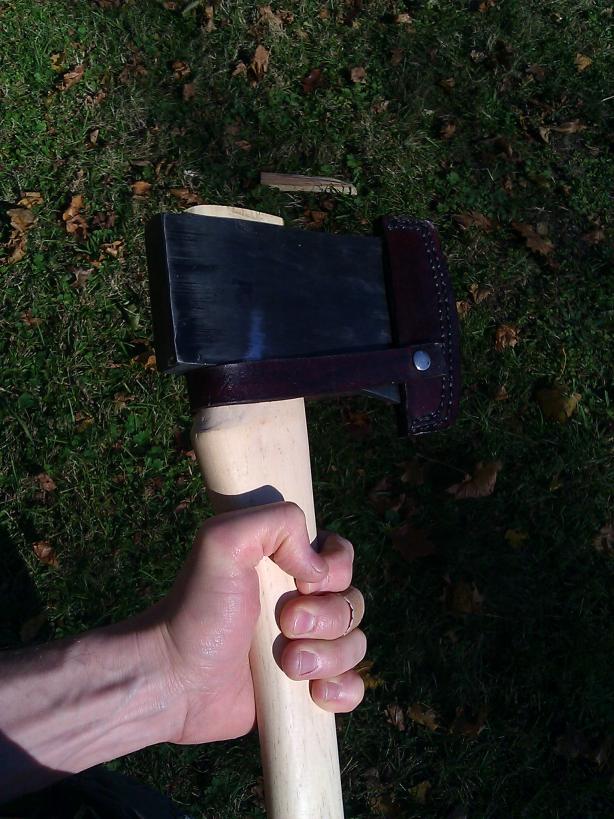

I learned a lot in the last few weeks on this subforum and working on new-to-me axes. So I went back last night and re-hung the first one on a real Tennessee Hickory handle.
The lady of the house liked it so much she insisted on taking a picture. I'll post a couple others later:
http://instagram.com/p/RnRovlGeYi/
Bright new haft on the Plumb. Too bad I caught the shadow and the mahogany of the edge cover didn't really come out.
