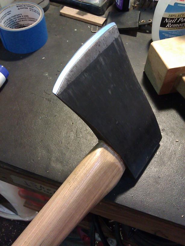

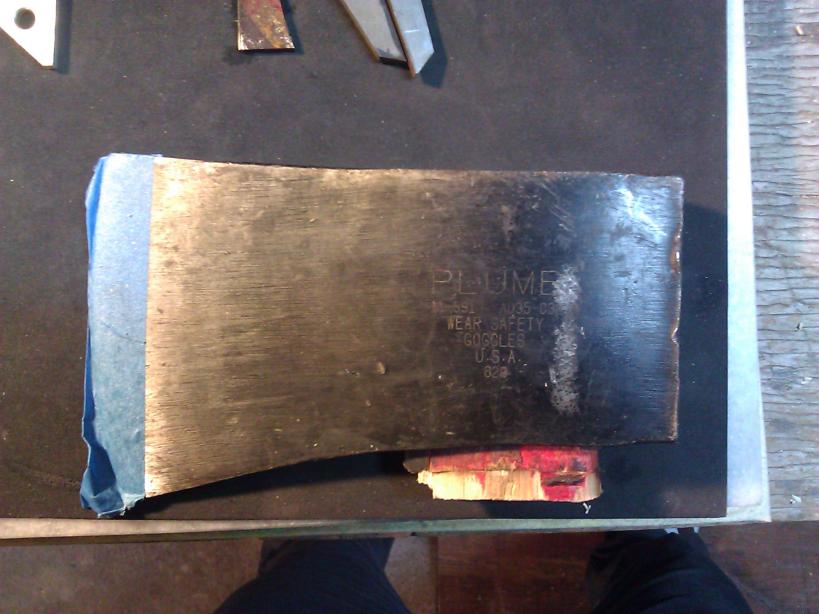

Here's the picture. I haven't drawn a possible cut line on it that you can see, but I was thinking it would go just below the bottom of the text markings.
I have thought about getting a flea market axe head and cutting it into a kind of Hudson Bay style. If a shorter eye makes for a bad hang, how do the HBs make it work? Now I'm confused....
Not a bad hang. Just a weaker hang than a traditional length eye like a Dayton or Michigan has. The HB is designed for medium duty work and bushcrafting. Traditional American axes are designed for heavier chopping and splitting. The HB might well be superior for most modern axe users. But it's design is inherently weaker than full sized eye designs.

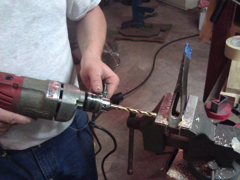

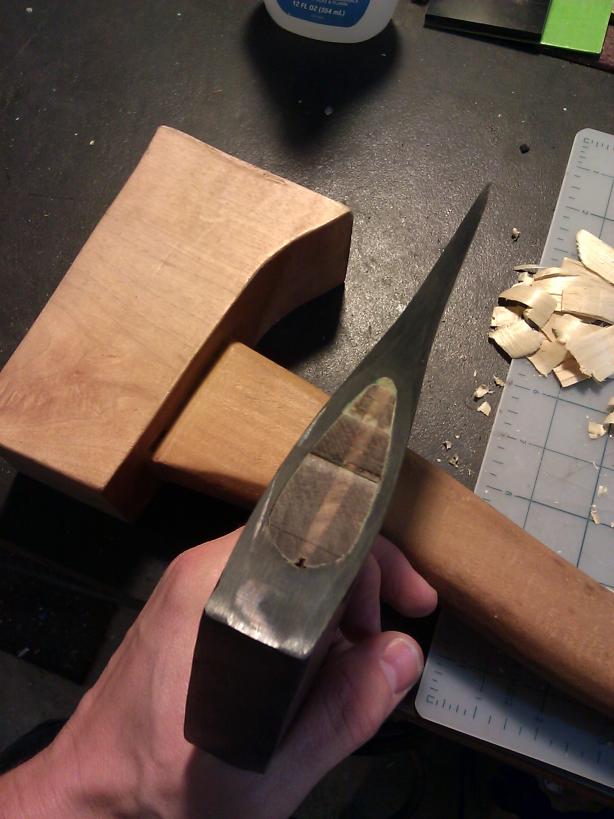

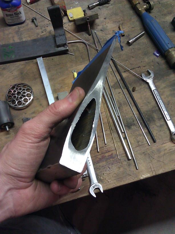

So I took the Plumb head to Knife Night over at Rock'n'Roll Knife & Tool, and while I was grinding bevels on a couple paring knives with my muffs on, unbeknownst to me, Mr. M went to town on the axe. When I turned around, this is the scene I found - perp and victim:
There's just a tiny bit remaining to be knocked out in the narrow part of the eye:

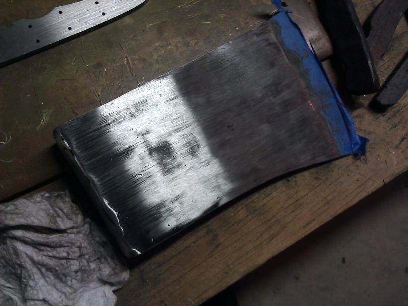

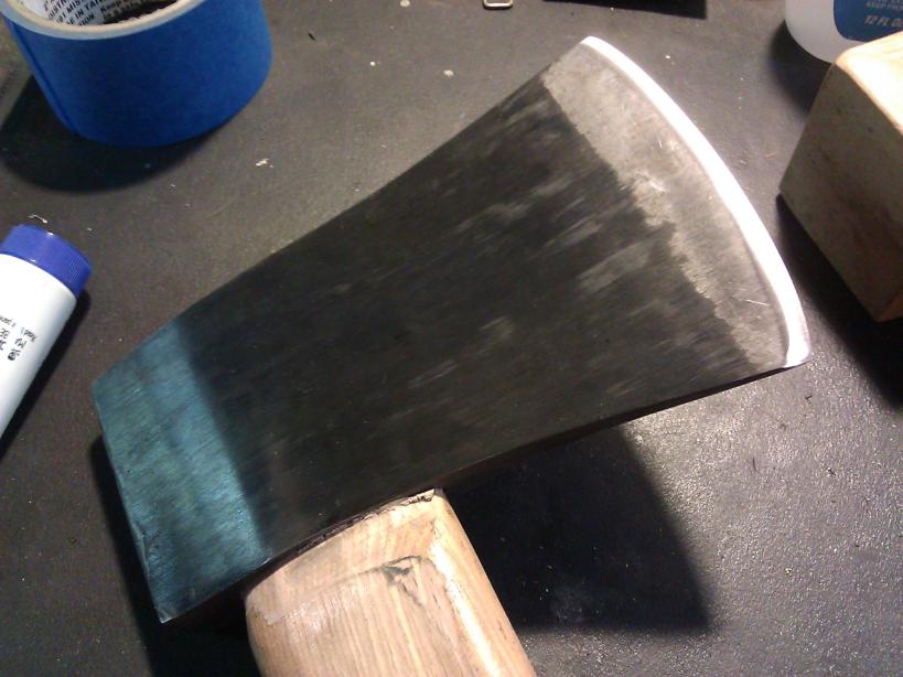

So I decided to clean up the profile on the grinder. The original die/marks around the perimeter were ugly.
Then hit the faces with 220 to smooth them out a bit - I didn't want to take out ALL the markings (most are gone now, alas :():
Then I hit the whole thing with Brownells oxpho blue - no pic.
At this point you may as well give the cheeks a full polish and get the mushrooming off the poll. You'll have a fine user when you're finished with this axe.
I knocked the worst of the mushrooming off and cleaned up the poll a bit too, but I think that's it for fancy finishing. I've got a dozen knives in the queue to work on...

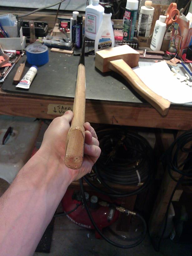

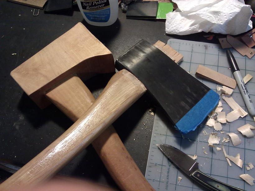

Did I mention my wooden mallet is the bestest? I made it when I was 15 and it was too big to swing. I can barely handle it now, but the haft is a bit thick. It's now sharp enough to shave a little - I stropped it after the slack belt. Dang thing needs an edge cover!

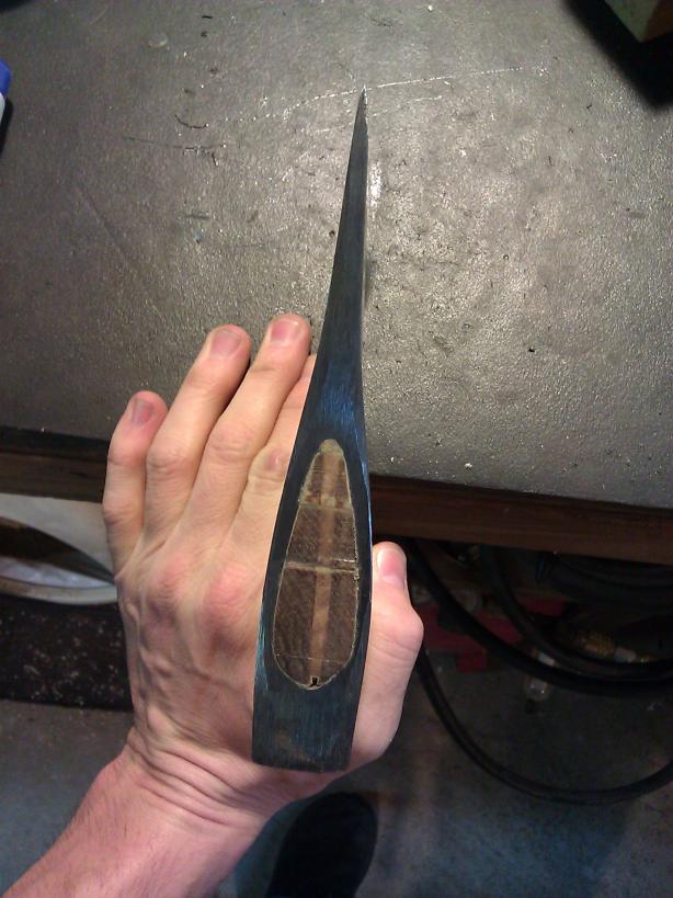

The axe is seated:
Wedged and cut the extra off on the bandsaw with the dull blade which burnished the top nicely - mussed my finish a bit:

top view post sharpening:
don't forget this side:
not the world's greatest handle, but the grain direction is decent:

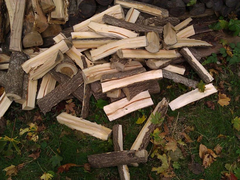

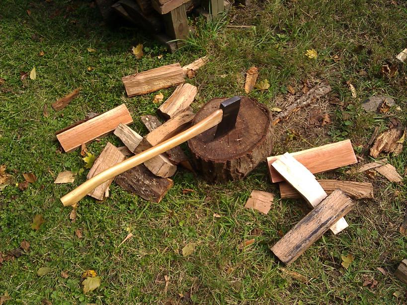

it works!
Actually, it splits like a dream - this was unexpected. I split a pile of 3-4" rounds from a couple trees I took down this summer. Not fantastic hardwood, but it'll burn. Then I split some of the actual firewood down a little smaller; oak and maple mostly. On the other side of the stone wall I did a little chopping on a downed trunk, and that was nice. What a difference a good well-tuned tool makes! Yay!
It needs a longer handle to be ideal for a house axe for me. For the truck this length would be great, but I never need an axe in the truck. At any rate, I'll leave it as it is and use it.

And please tell us about the mallet!
*lol*
I made that mallet in a summer wordworking class when I was 15. Our first task was to make our own mallets. For some reason mine had to be shaped like an axe... The head is a couple pieces of hardwood (maple?) laminated together, and the handle was shaped from a piece of poplar (I think.... it's been 20+ years). It was SO heavy that I made a smaller one in a similar shape - shoulda thrown that in the pic too. But the smaller one's head loosens, so despite it's more convenient size, it doesn't get used much either.
