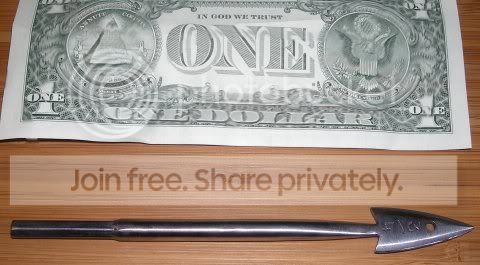

How about turning a 3/4" spade drill bit into a harpoon point?
