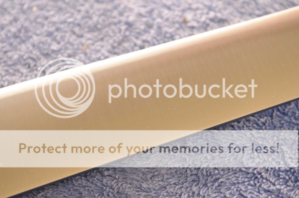

Thanks for the kind words boss. Yeah, I am giving three away to buddies at work and one here at the forums. I am trying to learn to put a satin finish on a blade. I ordered some 3m belts from 40-500, a few leather belts and buffing compounds.
Here is what I came up with after a real quick attempt with the belt that came with my little kalamazoo sander on my old machete:

Rich, that satin finish is looking pretty good.
You realize by doing this you are going to have your email flooded with requests right?
If you don't mind, while you do it let us know your process and equipment.
