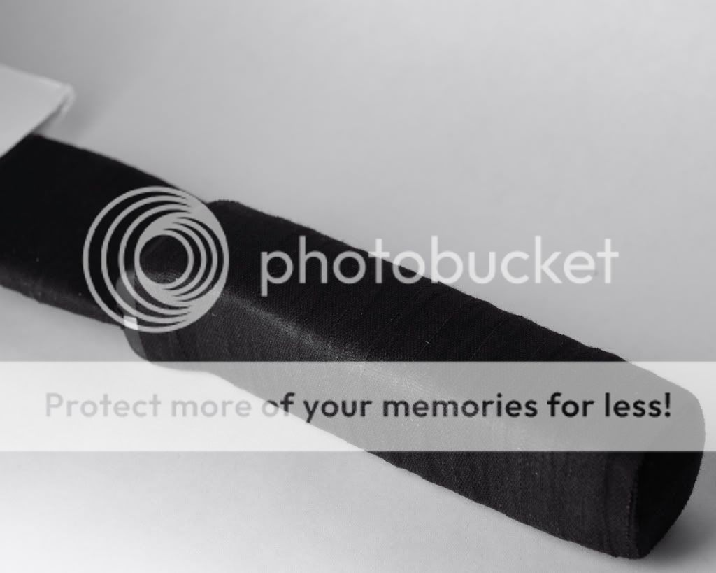

Okay, here is the handle for this one. Not going to do anything more with it. I wrapped it with Howies Hockey tape (it has worked for me for many years). I will put a roll with it so you can wrap it to your hand size. If you are talented then take it right off and make your own handle:eek:

Couple quick points:
1. While hockey tape offers lots of grippiness, you may want to look at the handles of traditional kukri's for another approach. The flaring butt of the handle works against the kuk taking a flyer when chopping. I'm not sure how needed this is with the light whipping strokes usually taken with a machete, but as long as you are experimenting.... ;)
To attach wood or, preferably, micarta scales, you could use Chicago screws (screw & hollow post), which are very commonly used for handle attachment. If you can machine a recess into the wood (plunge router or a Forstner bit in a drill press), a nut-and-bolt ala' Becker knife handles (now made by Kabar) can also be used. While plain rivets have been used for a very long time, I don't recommend them due to the loosening that can occur, especially with the swelling/shrinking of wood with seasonal relative humidity changes.
A planer will make parallel-sided slabs, assuming one side is already flattened with a hand plane, jointer, or even sandpaper taped to a flat surface. For the sandpaper method, you can use coarse grits like 60- or 80-grits for hogging wood off, then work up through finer grits like 100-, 120-, 150-, 220-grit for smoother finishing.
2. If you do stick with the straight-profile handle slabs on the machetes, the link below is for a paracord lanyard loop that is resistant to snagging on branches. It does this by dissolving from a loop into two straight strands.
