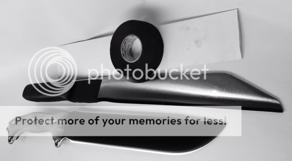

Here are three different angles of it so far. Sorry for the lighting.
I am done all that I am going to do with this one. I kept the sides flat and the edge convex. I tried to make that little fuzz maker or whatever that is for near the handle.
Foo, I am sending you everything in this pic but the NMFBM:D
Thanks to everyone who helped me do this:)
I figured out a lot and my next attempt is bound to yield much better results:thumbup:

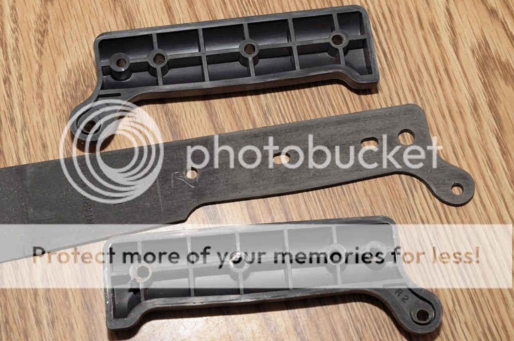

I am moving on to my next one. Trying to take all of my mistakes from the first one and learn from them. For this one I am going to fasten black canvas micarta handle slabs and try to produce an actual satin finish (Not just the varying sized scratch marks of the first attempt:D)
Anyhow, here is what the inside of these high tech handles look like:

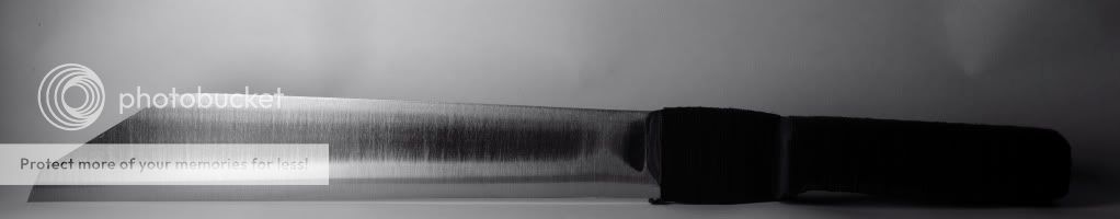

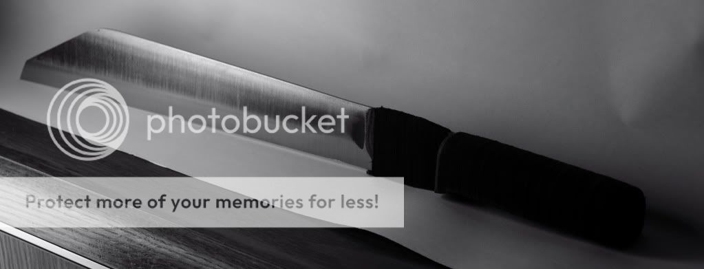

I went over the blade finish and the edge a little more and put black canvas micarta handles on. Not completely finished on the handle because I realized the micarta dust was making its way out of the basement and into the rest of the house so I stopped. Going to switch to wood for the next handles. Thought you all would want to see what I finished up with for this one.

That last one looks almost like a mirror finish. What grit/compound did you leave off at?
Thanks a lot guys! The idea of people wanting to PAY for one of these is flattering. I am not doing this to sell any though:o Just for fun and practice.
As far as how I did it and the finish I can answer that I think. For the handles I didn't use anything fancy, just a handheld jigsaw clamped upside down. Can't find a blade for the OLD floor standing jigsaw:confused: I just cut a piece of micart in half, drilled ¼ inch holes, then I figured how deep I wanted the shoulders of the fasteners to go and I drilled 5/16 inch. I attached the handle slabs. I used a 40 grit belt to shape and then a 180 belt to finish it a little nicer. I didn't really finish the handle like I wanted but I am not poisoning my entire family and the pups, they don't have respirators:D

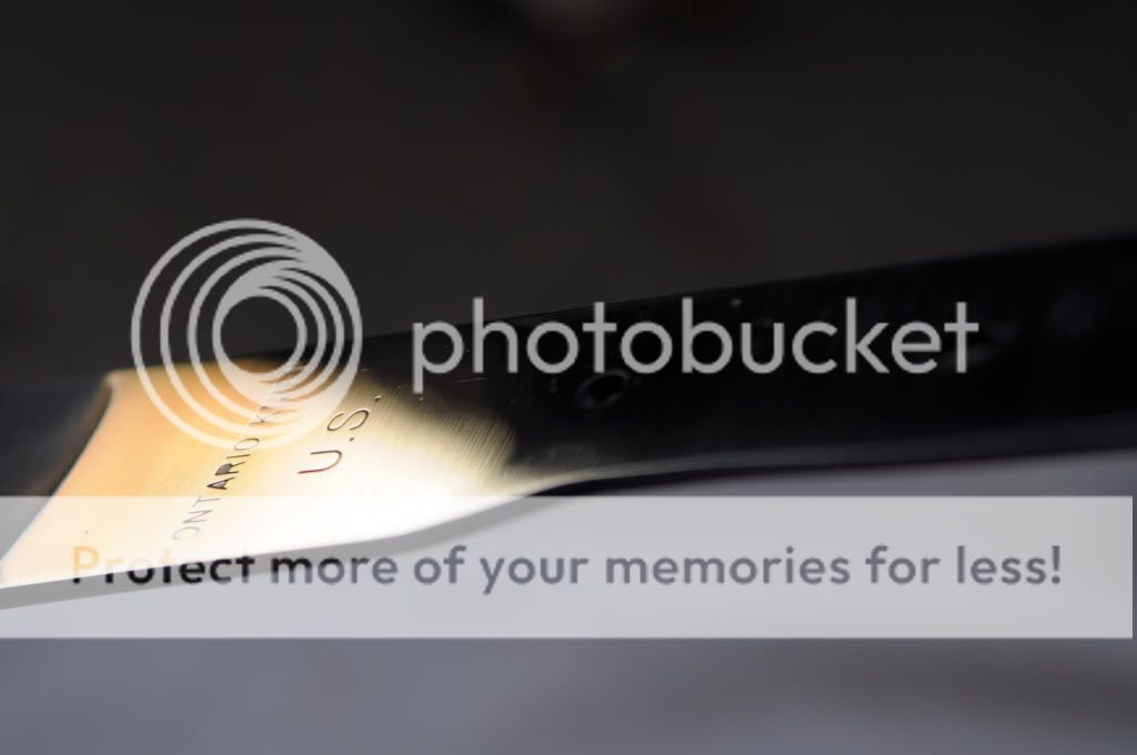

For the blade I am not sure how I would repeat that but I can tell you what I did. While experimenting and trying to help 230 I found some things I liked. Basically I went 40, 80, 120 with zirc belts on the platen until all of the original HEAVY grind marks were gone. Then I used nothing but cork belts. I used 180, 240, 320, 400, 600 and then plain cork. I tried different compounds with these. Going all the way to plain cork did give me an almost perfect mirror finish. I actually went all around a few times until I went right from a mirror polish to a cork 180 with green compound and it gave me this. The pic actually shows what "satin" is there you just have to look hard. In person it is a really cool finish. Hit the light just right and it is a neat satin and the rest of the time it is basically mirror.
For the edge I also tried a lot of different things. What I ended up liking best was to stop with a 3M grinding belt at 320 grit and finished with a leather belt and white compound. Very sharp and polished.
