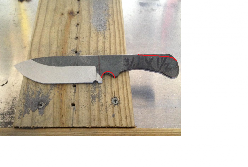

I think the Count meant to send it out for heat treatment. 440 C is a lot more difficult to HT than 1084.
You're putting good work into that knife, so I would recommend putting a good heat treatment into it as well. You're not going to be able to heat treat 440C in a homemade forge. It needs very high temperatures (1850F minimum) without overheating and a long hold at temperature to get all the alloying elements in solution. How do you know if you got it hot enough or if you over-heated it? A heat treating oven is pretty much required to do it. Also, you need scale protection at that high of temperatures for a hold of any length of time or you risk serious pitting and decarb.
We're not trying to bust your balls, but the Count's advice on sending it out for heat treating is spot on. Most stainless steels and several high alloy tool steels really require an oven or a controlled forge. For home heat treating, I'd recommend 1084 as a great carbon steel to start with. It can be heat treated very effectively in a forge due to its lower austenitizing temperature and no real soak at temperature needed. It also makes a great knife.
Like I said, great work on the knife, and I do think it's great that your jumping right in to figure this out. However, heat treating is the most critical part of making a knife besides basic geometry. If you don't get the heat treatment right, you really just have a knife-shaped-object that won't hold up to use. Find some 1080 or 1084 to play around with, and you'll be surprised how well it works. There are lots of threads on how to do heat treatment for these steels, and if you have questions, feel free to ask.
And thank you for your service.
--nathan

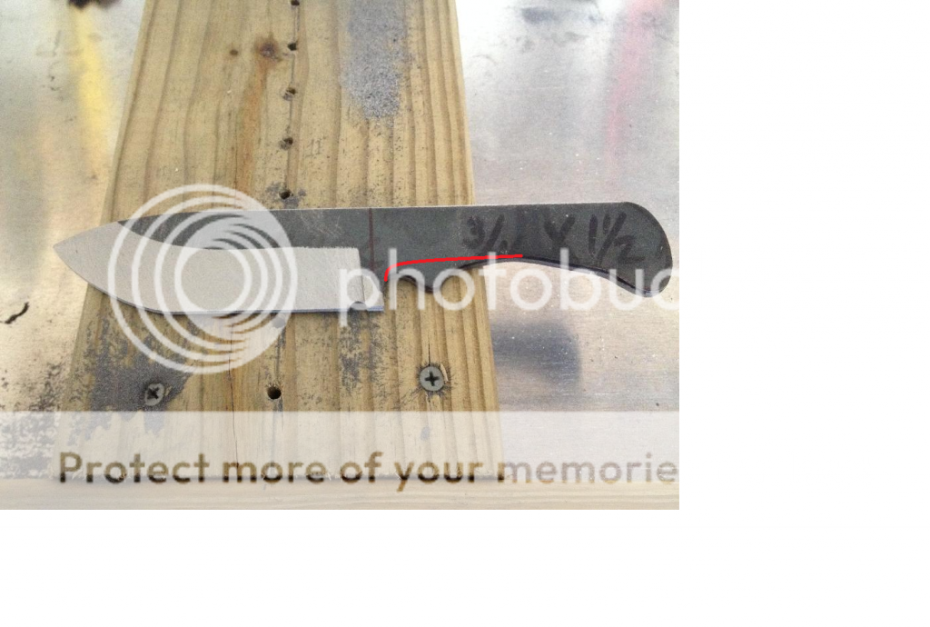

Before you send this out for heat treat, may I offer some suggestions? The bottom of the tang is uneven and should be smoothed out otherwise it will be uncomfortable to use, and much harder to smooth out when the blade has been hardened. The finger choil also looks uncomfortable. I think you should either make it a more circular radius, or grind it off altogether. For comfort, you could also curve the top of your tang towards the rear. Overall I like the overall design though. Should be a nice functional blade.
Good luck, and welcome to the forums.
Here's what I mean for modifying the blade:
Just to state something obvious that you seem to have missed.........You can not HT stainless steel in a forge. It takes a HT oven and heating to 1900-1950°F for 30 minutes to an hour to do it. tempering is 400F for one hour done twice. Also, it is an air hardening steel.
The blade you have may or may be ruined after your attempt to forge harden and oil quench it. I would just start another one and this time read about the steel before attempting to do HT.
For stainless steels, you will need proper equipment or will have to send it out for HT.

The bottom of the tang I will adjust, te finger choil is pretty comfortable,
So I will leave that as it is.
