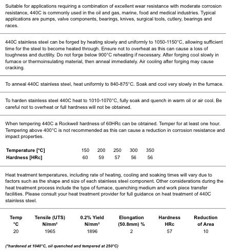

Is this correct?
After reading about 440c until my eyes were bleeding, It seems the most common HT formula is as follows, Ramp to 1400F soak for 10 minutes, Ramp to 1900F soak for 30 minutes, air or plate quench cool to room temp, sub zero in dry ice/acetone 1 hour, Temper at 350 twice, cool to touch between cycles
The only gray area I found was the temper temperature some say 350 some say 400, I was unable to find a compelling argument for either temperature
Go with 400°F temper and if available, use cryo after the initial quench ( before the first temper).
