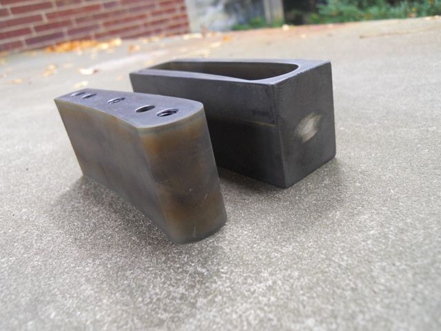

This set of pics will either give you sweet dreams or nightmares, depending on your technical leanings!:D
Either way, it shows you a small part of the work that goes into your Forum knife, and all GEC knives for that matter.
It's a wonder these guys can make a buck! (Pun intended):D:D

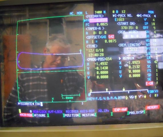

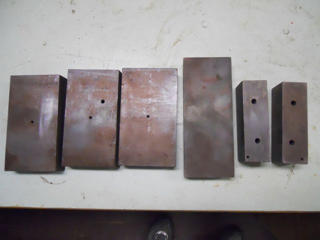

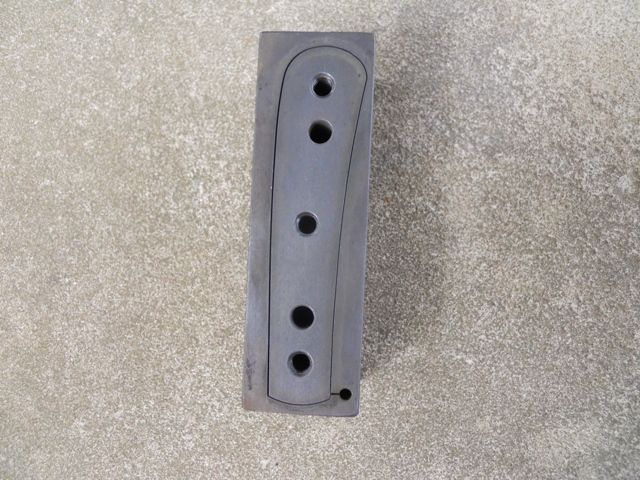

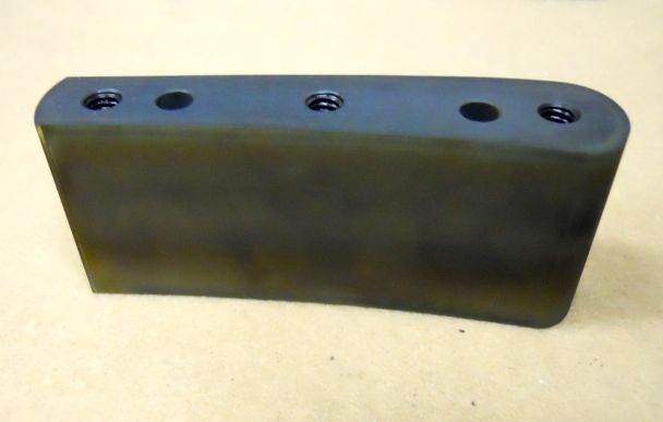

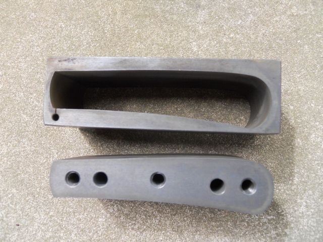

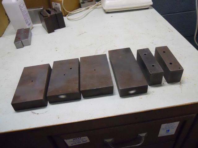

The pics start from tool steel blocks, fresh from heat treating, and ends with machined dies that punch out the scales for our new pattern!

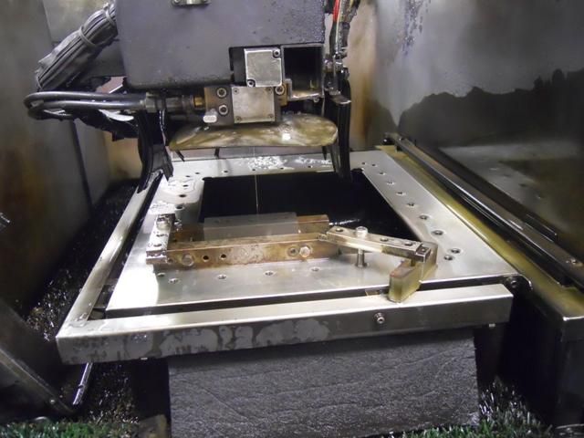

I will leave technical questions to those smarter than me, so, please contribute if you are qualified. I do know the machining is by EDM! And that water flows downhill!:rolleyes:

I have one question though, why do they do heat treating before they cut the die, wouldn't it be easier to heat treat it after it has been cut so that it is easier to cut out?

My understanding is that heat treating causes some distortion in the steel. Insofar as the distortion has already occurred prior to being cut with a laser, the end product is much more "consistent" throughout. In other words, the laser eliminates most shape distortion caused by the HT. Also, cutting with a laser creates more stresses on steel than cutting say... by waterjet. Generally speaking, the thinner the steel, the more impacted it will be by laser cutting. I ***think*** that because the steel has been hardened, it is less susceptible to laser processing distortion than its softer "un-heat-treated" counterpart.
BTW, I am NOT an engineer, but I do play one on TV! :D
This would be my assumption as well, whenever I cut steel 1/16' or smaller with a plasma cutter it seems to warp a tad if not heat treated prior.

I am assuming they mount the male piece over the female piece, and "punch through" the scale material.
EDM machine uses a wire with elect. current running through it to make more
precise cuts. It does better than a laser.. My best friend owns a machine shop and those things are
expensive.... Makes it easier to make dies and punches. I guess...:confused:
