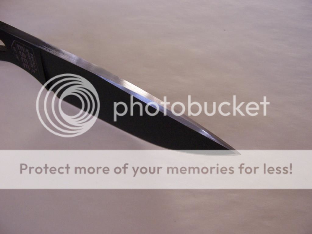

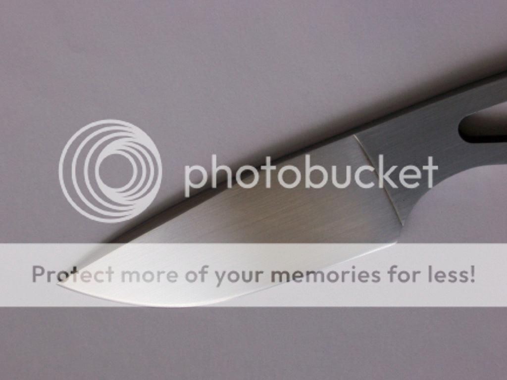

Proposed customized BK14
Step 1. Satin finish 600 grit + green compound and WD40 as a lube backed with aluminum block polishing in one direction. Step 2. Will be 800+green compound.
When Step2. is completed, I will finish the scales and sharpen the blade.

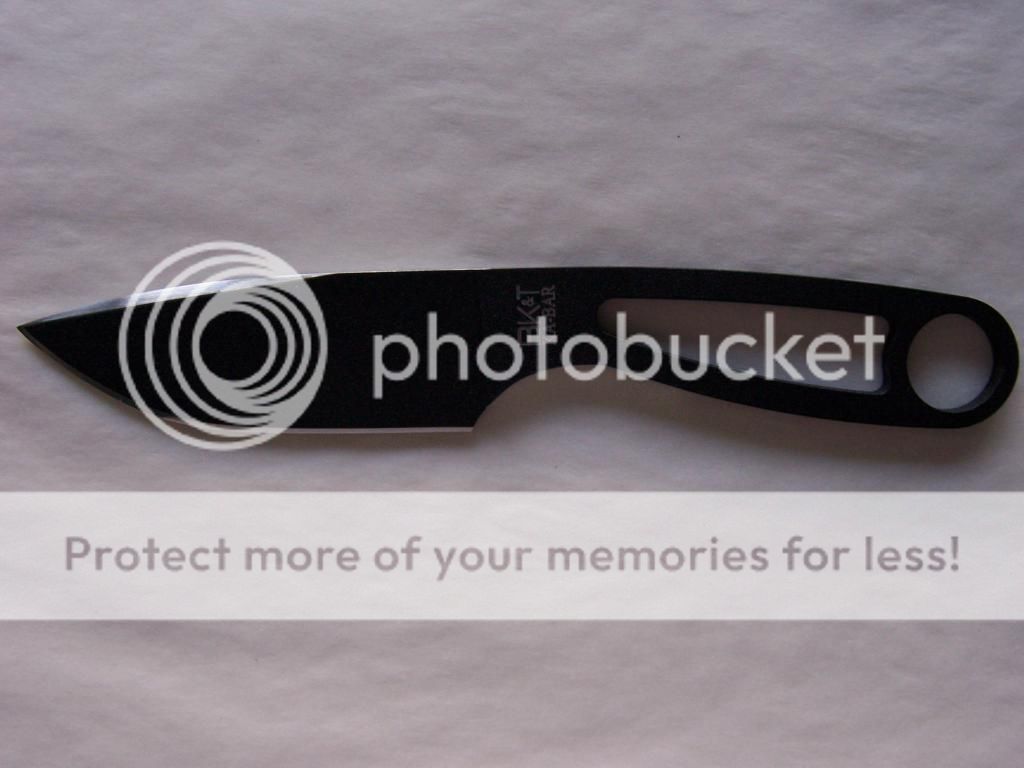

Notice is says ESEE on it not Becker.
The shape was wrong so I looked a bit closer. :)

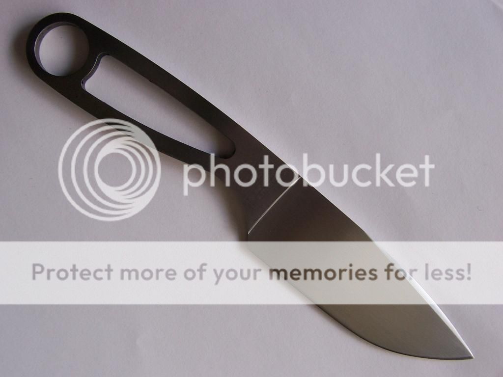

That's the Esee side. The other side had the Becker logo. Dex has already pointed that out. The ghost of the laser etch shows slightly although it cannot be felt. I have reshaped, stripped and satin polished my BK14.

I took the polish to 1500+green compound. There are no tool marks on the blade or edges. Next stop Micartaville for pins and scales.
