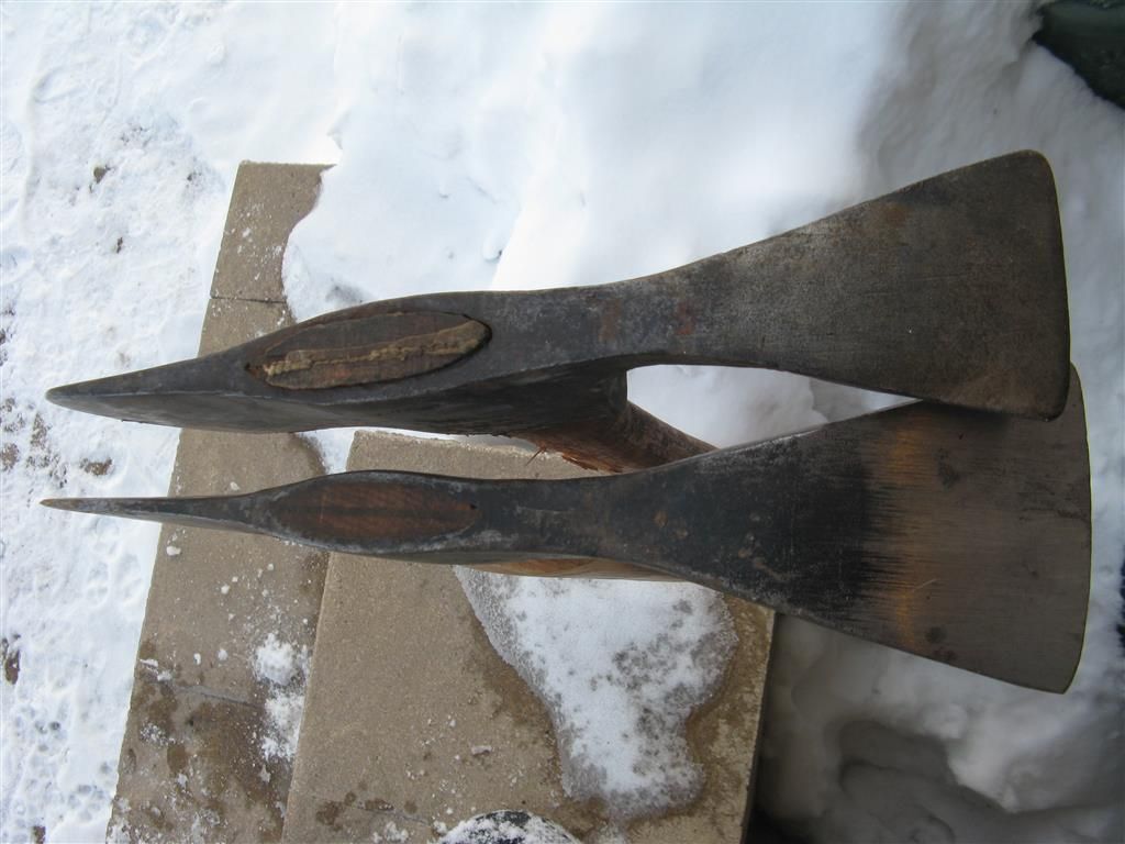

Well I did venture out to my snowed-in rural storage locker and retrieved whereof I spoke. Narrow eye is of a current production Barco Pulaski that was re-hafted (by me) 2 years ago and next to it is the vintage (likely 50-60 years old) Morley Walter's version that I spoke of. I found that particular Walter's (only the head) nearby an abandoned Park Ranger cabin in central B.C. (Bowron Lakes) in 1980. It had already seen a lot of use!. Eye on the Barco is 2 7/8 x 11/16 and the eye on Morley's Pulaski is 3 1/8 x 3/4. By my thinking: 10 points go to Mr Pulaski for the wonderful original design and a few Brownie points to Morley Walters for deciding to improve upon it. Really too bad that Walter's Axe permanently closed up shop 41 years ago.
