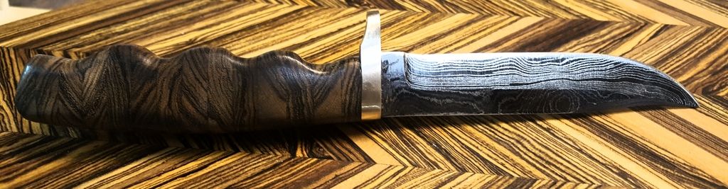

For a friend's son Christmas, inspired by John Conner.
Alabama Damascus with stacked Bocote handle.
That's what I hear too just plum crazy,That bocote turned out sweet, great idea with the laminated blocks. I love the way end grain looks in bocote. I hear that John Conner guy is nuts, but I'm sure he's honored to be any kind of inspiration. Congrats to your friends son, I'm sure he'll be floored when he gets it.
That is very nice. I love the Damascus. Handle looks nice and comfy too.
Edit: just went back and looked closer at that handle...that sir is amazing. It would be nice to see a little tutorial on that :thumbup:!!
Thanks Laurence....I just got some dark blue in. I looked everywhere for navy blue g10 or micarta and no luck. So I'll give this a try. I imagine it finishes like a paper micarta?? We will see.
That's what I hear too just plum crazy,but I heard he's a helluva guy and makes a damn fine knife.
Thanks Tim, I have some I'll be sending John I will make sure there's some extra in there for you, as far as tutorial I have one other pic. I have more Bocote than I'll ever use in a lifetime, so I laminated a bunch up and cut it as you see in the pic. The board I took the pic on is the same laminated stock I did in a herringbone pattern. I modeled the handle after the skinner John did for me a few months back.
This was my second attempt, the first I tried to sand the finger groves and ruined it. On this one I laid it out, drew the finger groves and rough cut them on the band-saw. Then finished it up with a Dremel and hand sanding. Finish is carnauba wax.

Damn fine looking knife & Handle! :thumbup: That laminate Bocote would make a super cool Cutting board for the kitchen!
I really like the way you did that Scott. I'm looking forward to using some of the bocote you sent on one from the batch I'm working on. I was never a big fan of bocote until I saw it in person and started working with it, I think its a wood that pictures just can't do it justice.

That herringbone layup looks pretty cool! I can see why the handle looks so neat now! :thumbup:
That was an amazing score Scott, those barrels of bocote are awesome. I bet you were like a kid in a candy store when you found that, I know I would have been.
