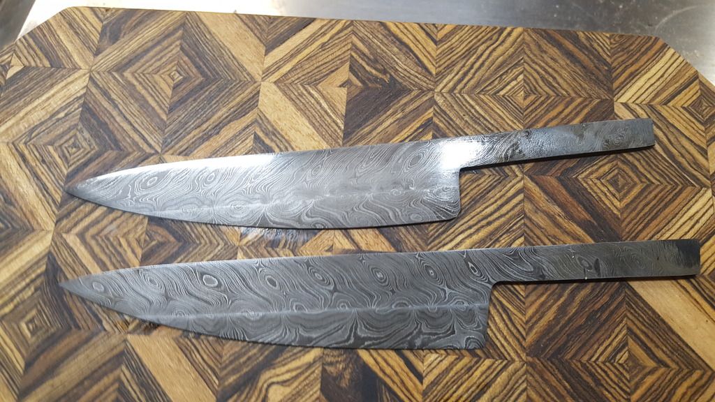

Two mini chefs in Thunder Forge Damascus getting ready for heat treat and Christmas presents.
I'll do finish grind once their heat treated
Look forward to seeing that.
That Dennis ain't no menace:thumbup:
Those are looking great, Scott! The damascote bocote will look awsome!

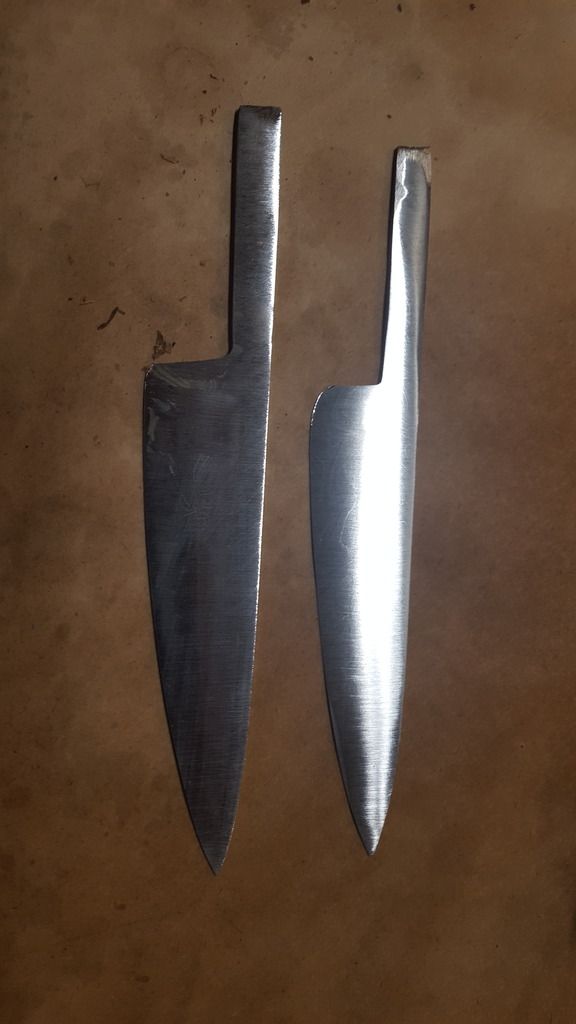

Oh, baby. If those aren't useful in the kitchen, nothing is.
Dang, those are knice. What will the handles be?

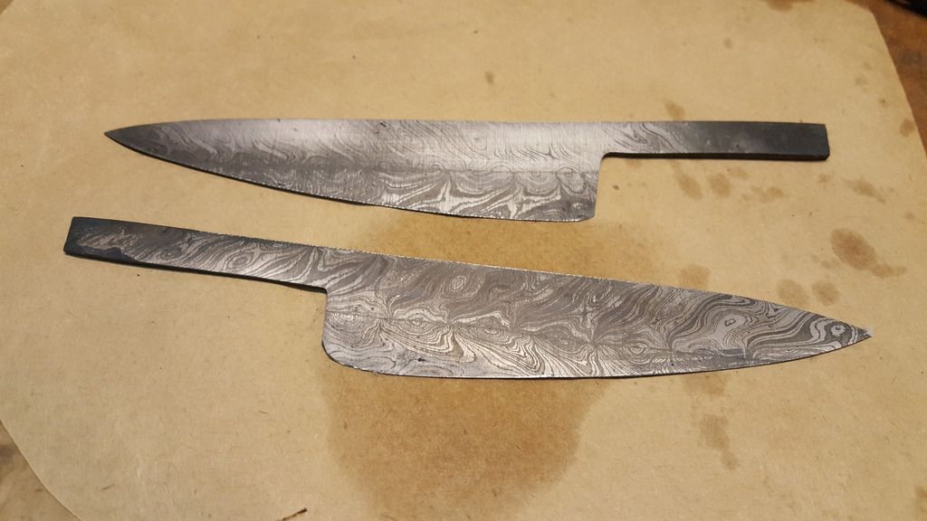

Finished grinding, etching note to self DO NOT USE FERRIC CHLORIDE IN ALUMINUM PAN! It's reactive to aluminum
Etched and oil, had to redo them as the aluminum screwed up the first etching.
Did you make the cutting board/table they are sitting on?
Looking great, Scott!!
For the FC, I used a short piece of PVC pipe, ~8" or so, put an end cap on the bottom, then a threaded fitting with screw cap on the other. Hose clamp it to a stand made of 2x4's or what ever you like. Then keep your mix in there, unscrew cap when you are ready to use. Works a treat, and no metal contact or corrosion.
