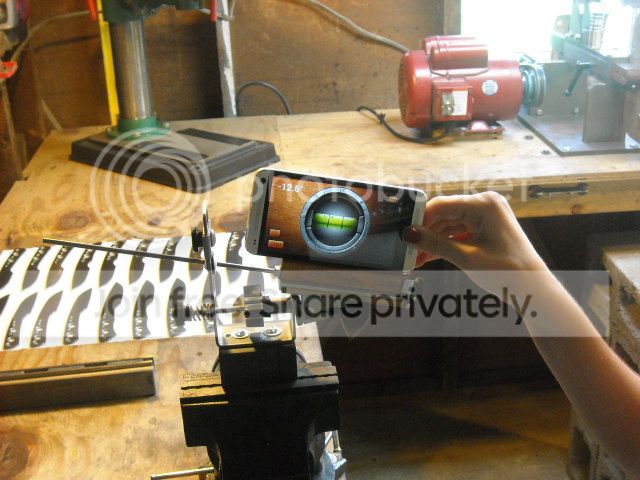

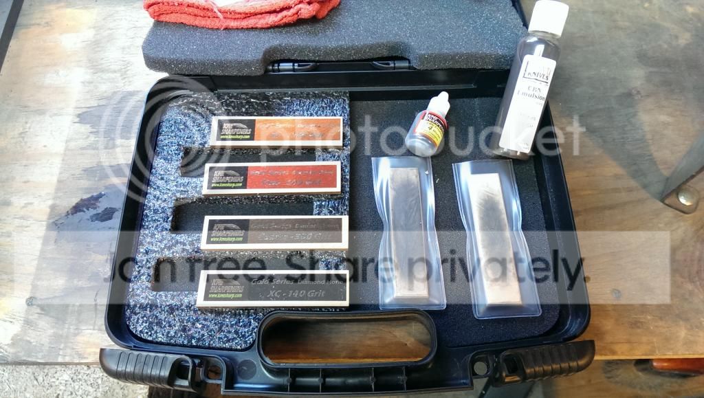

I've gotten away from using the grinder to sharpen my knives with. It's just too easy for me to botch it up and I only have the 3 speed control. I've been using the KME diamond system on the last half-dozen knives and I'm really pleased with the results. Minimal effort with a high degree of accuracy. The knife doesn't need to be removed from the clamp when switching sides because the fixture allows the knife to rotate over. I work my way through the 4 diamond stones and finish off with 8 and 4 micron CBN emulsions on kangaroo leather strops. I attached the clamping fixture to a small piece of angle iron so I could use it in conjunction with my bench vise for stability. It puts an accurate, very sharp edge on my knives every time. I chucked up a blank in the photos to illustrate.

Adam, nice post, I like your fingernail polish in the pic of the phone showing the angle. :) What app is that?
That's my daughter's hand Fish, not mine :p. The app is called iHandy Level Free. I use it quite a bit in the shop since I don't have an angle cube yet. It works well and is pretty accurate when verified with a square. You can zero out at any angle and it also has a hold feature as well. Since the KME system is basically infinitely adjustable for edge geometry and I like to use a 25 degree inclusive bevel on most of my knives, the app helps me find exactly 12.5 or so degrees. I chuck up a couple of blanks and use my phone to verify that the fixture is locking in at 0 degrees first and then pick my angle from there. I then lock the fixture at that setting and I know precisely what edge geometry I'm applying.
