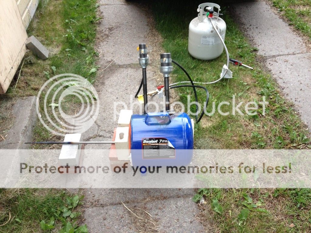

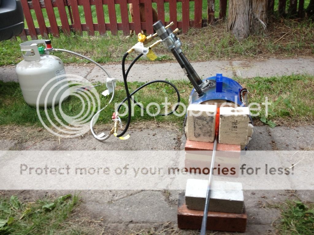

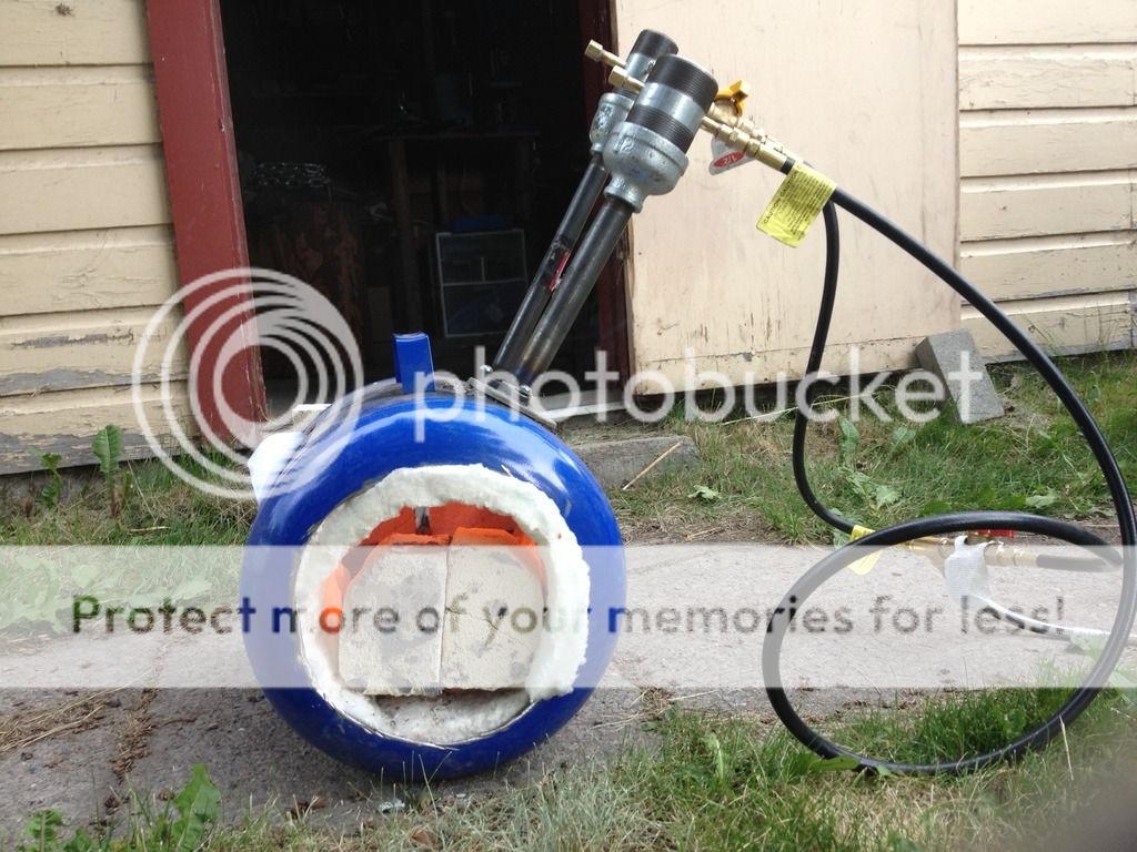

I would definitely build one. I built my forge, burners and all, and it only took me a few hours. If I could weld, it would have gone a lot quicker than that, and would look a lot less "homemade." For the body, I used a brand new air tank from Autozone (about $40 IIRC) b/c it already had legs welded on and a handle on top. I just cut the ends off w/ my angle grinder using a cutoff wheel and smoothed the edges using a flap wheel.
If I had it to do over again, the only thing I would have bought is the venturi burner kit from hightemptools for $45. It's embarrassing to admit, but I spent two or three times that amount in random pipe/LP fittings and several trips to the hardware store trying to get my burner to work just how I wanted. There's so much info online, and so many different versions, and I kept changing and tweaking my design with different pieces and configurations, but in the end I wound up with something essentially the same as what's sold in that kit.
Here's the one I built:
Not the prettiest but she gets the job done!
-Mike

Mike, just a suggestion, but I'd consider lining that kaowool with satanite or something similar to keep tiny little refractory fragments from blowing around everywhere as the blanket breaks down over time. Especially if you ever forge in a building, as you don't want to breathe that stuff over time. It would be worse with a blown forge, but even a venturi will have some decent air current through it.
