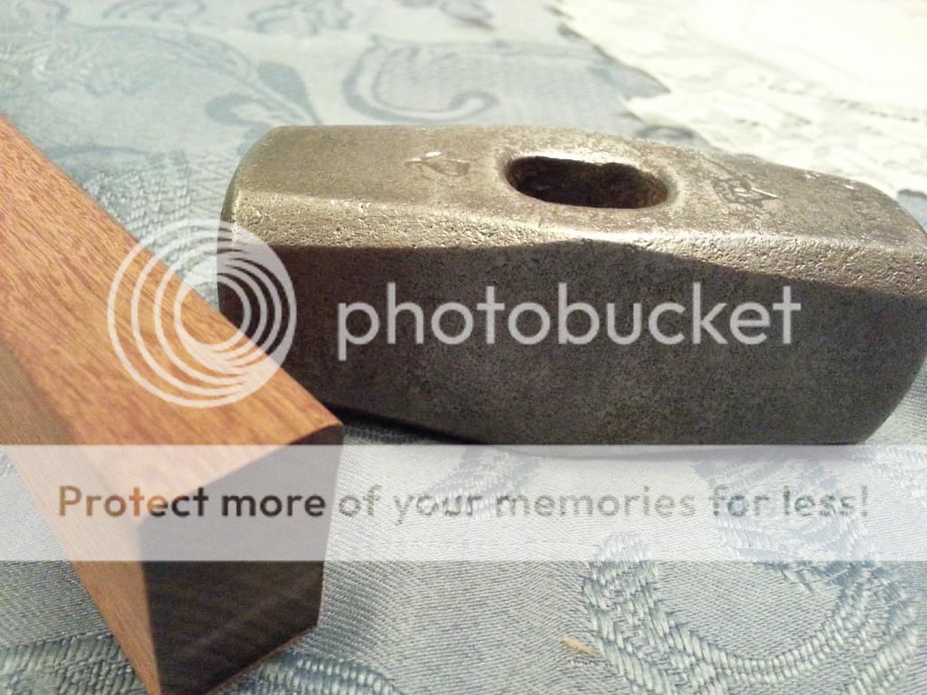

Here it goes. I'm going to hang this 2lb Iron City hammer head. I have a bunch of wood that was given to me. It was called "ironwood" and is a decking material. I know that there are several woods called ironwood, I do not know the actual species here. If anyone knows an "ironwood" that is a common decking choice, let us know the species. It is heavy and dense, noticeably heavier than mahogany of the same size. I don't know it's properties, but I have been using small pieces of it for wedges and it turns VERY dark with oiling. I'm thinking that 11 inches will be just right. I will post when done, let's see how this goes.
Pics arent showing up for me, but if it's used as decking material and referred to as ironwood then what you have is ipe. Ipe is sometimes
called "Brazilian Ironwood," but don't call it ironwood because it's just too confusing. There are probably over 30 species that some folks somewhere
would call ironwood. Ipe makes an interesting axe handle, might not be the greatest wedge material because of it's oily properties. Definitely lather it
up with wood glue before slamming a wedge in.
You nailed it, it's ipe. After looking that up, it's all over the web as decking, and it's a visual match. After reading some of the properties, no wonder I had a tough time with the saw. Apparently it's one of the toughest, hardest, strongest, densest, most rot resistant woods known. I guess it sinks in water. And it looks nice. Probably perfect for short handles. The piece shown is half of a board that I cut, I have some 2x2 but it's mostly 1x4 in lengths from 3-4' up to 8'. I have maybe 100' of it, and more of mahogany boards of the same type. I like the contrast of a dark wedge, maybe that will work better.
