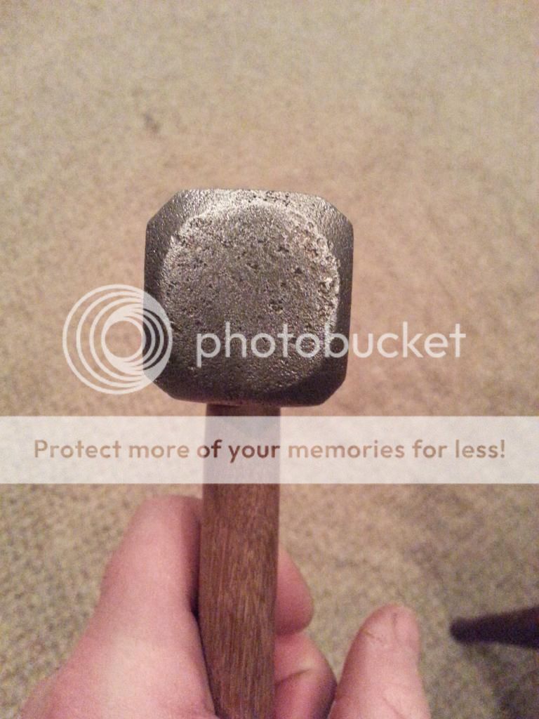

question about handle making

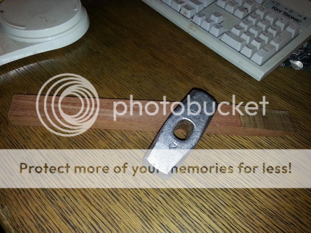

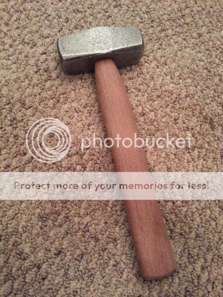

Starting with a straight 11 inch hammer handle. Keeping it simple, will see how it goes.

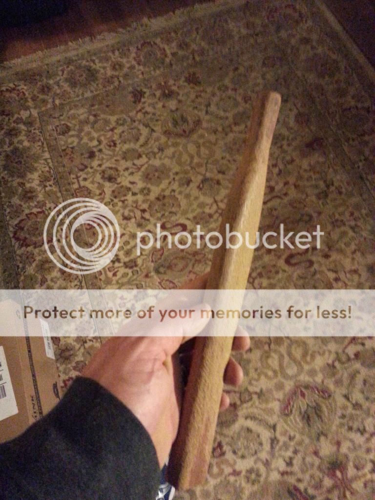

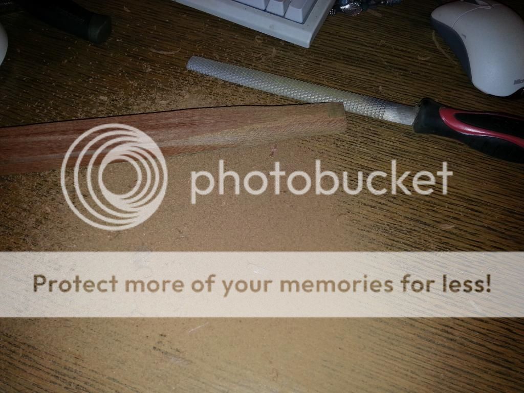

Seriously though, I'm going to start with a rasp and see. I'm going to take it slow and try to stay with that and files and sandpaper.

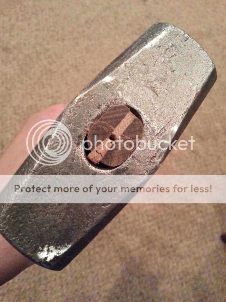

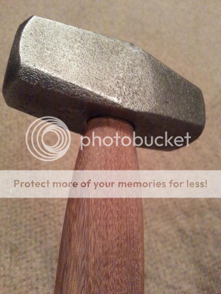

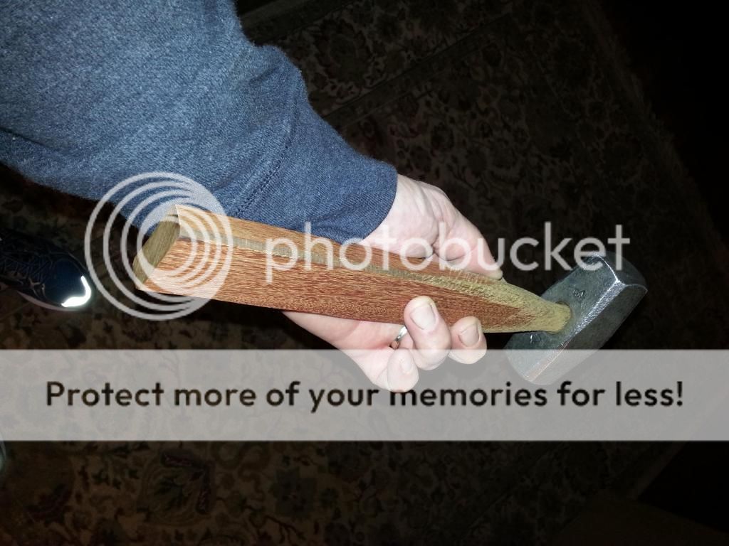

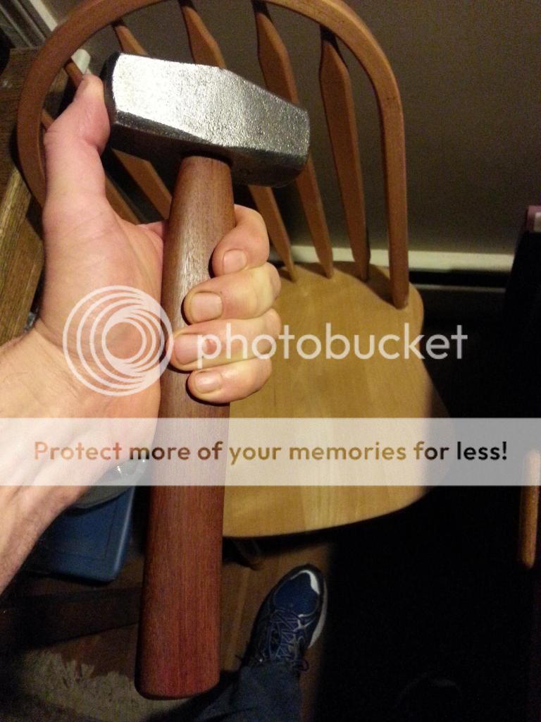

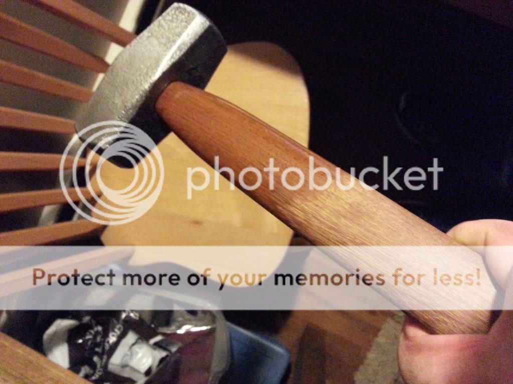

OK get ready for some pics. It is done, except maybe for a metal wedge and some oil.

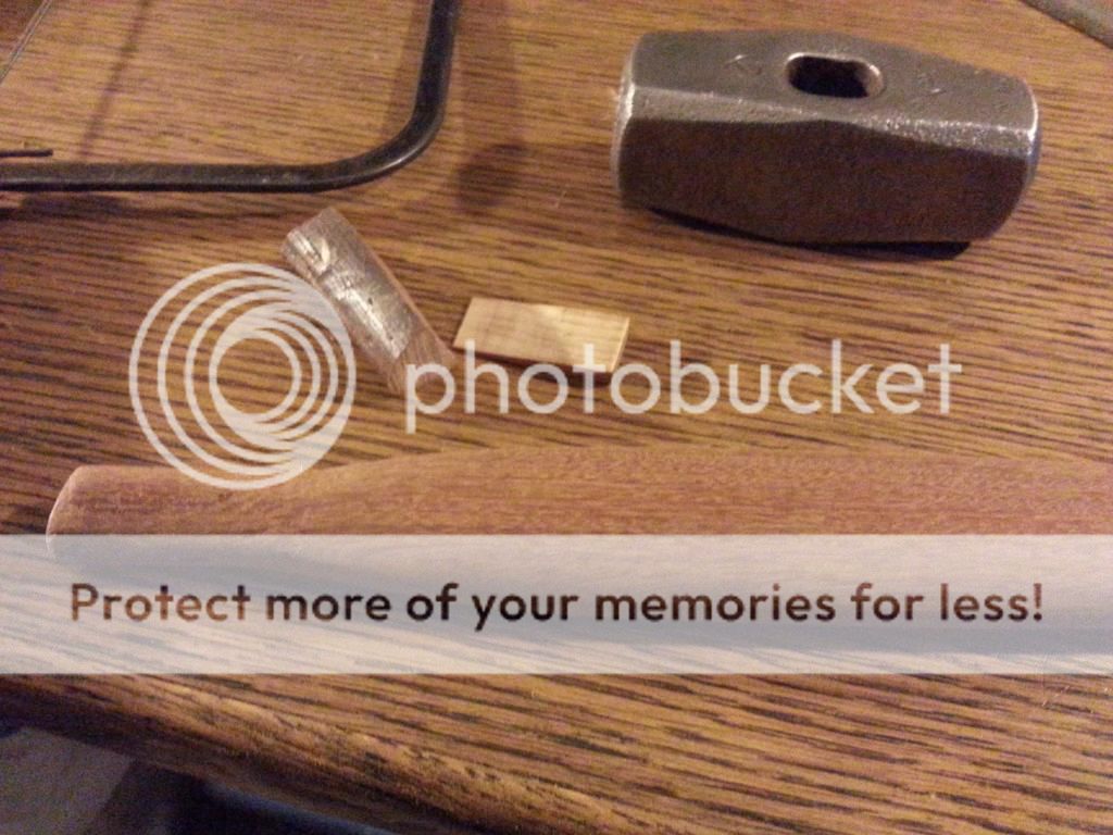

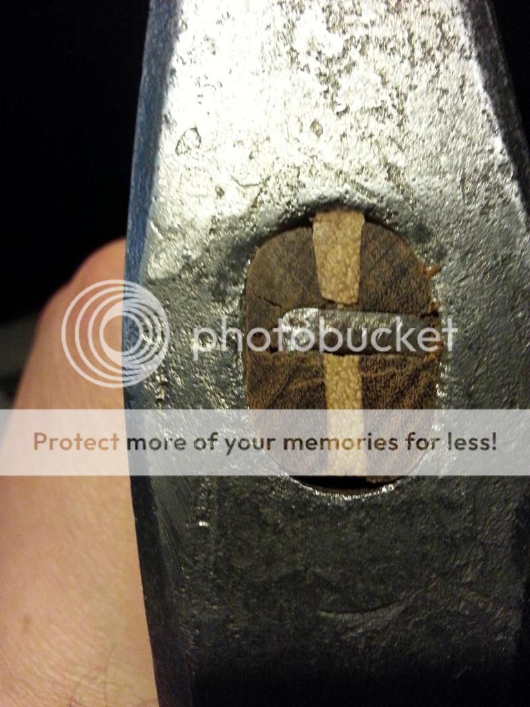

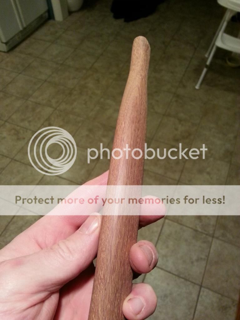

This was done solely with hand tools except for cutting the kerf and beveling the butt of the handle. Mostly with a rasp, some with a half round single cut file, and sandpaper 60-100-150-220. I never used a clamp or a vise, this was handle in one hand, rasp in the other. The wedge was made from a slice of of an old hickory hatchet handle. The only flaw was when that split when pounding it in, but I think that I can cover that with placing a metal wedge right in the split. After 220 grit, this hard handle feels like velvet. The only thing that I can't decide is if I should leave this tough wood alone or linseed oil it. It will darken with the oil. This hammer ended up weighing 36 ounces and being 10.5 inches long. I call him...Mini Mjolnir.
I could never recommend this ipe wood for commercial handle applications due to the time it takes to shape, but I HIGHLY recommend it to individual crafters looking for a good project material for their own products. It was easy to work as long as scraping/sanding was used, blades would never work- I tried a Mora and although it bit the wood easily enough I could not control the shape/way that the wood came away. Rasping/filing/sanding was fine. The wood is beautiful and I enjoy knowing how tough it is. I have rehung older handles and hung new handles, but this is the first piece of wood that I have shaped and hung myself. I enjoy knowing that this tool could outlast a couple of generations if treated properly. It should be noted that aside from my time and the excellent learning process, this nice new hammer cost me $1.

That turned out awesome, and thanks for the heads up on using rasps over blades. I assume you could rough a bowl out with a hatchet, but I have heard that trying to carve it is difficult, and you've confirmed that as well. I definitely like the linseed oil on it. It will help with the feel as well when using the hammer. Ipe apparently has a 60-year outdoor lifespan (in or out of the water) without any chemical treatment, so that handle should last essentially forever if treated and stored well. Very cool!
Question: did it take a lot of linseed? I've also been told staining ipe and cumaru is difficult as the stain will sometimes just sit on top of the wood with very little penetration. Any issued with the linseed oil?
It took one coat and that was about it. The end grain took more but that's normal. I would say that it took less than half of what hickory would take, but where it isn't even really needed I'm don't care at all. I just like the darkening. I'll do the beeswax/linseed oil/turp finish over the weekend just for fun.
Thanks for the feedback everyone, it was fun. I don't have any with enough girth for big swells, but TONS of the stuff for straight handles. This won't be my last time working with it.
