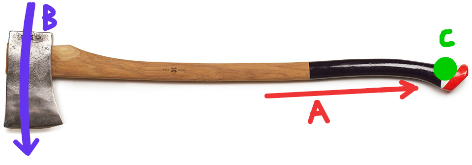

Square_peg, If I understand it correctly, what Cook says is that there is a difference the way a straight handled axe bit and a curved handled axe bit would pivot, if both are held with the same wrist position.
Held with the same wrist position, most curved handles position the edge of the axe "further down” from the edge position the same axe would be if hung on a straight handle, increasing this way the “effective length of the fore-section" of the axe (again, the wrist position and the axe head are the same, only the handle shape differs).
I personally think, that Cook’s argument is that at constant wrist position/grip, at same handle lengths and speaking of the same axe head, there is a variable effect of change in the effective length of the fore-section, which depends on the shape of the handle.
I think this argument is correct.
Now, if I understand it correctly, in addition to this, from this argument Cook concludes further, that this effect inevitably leads to variable degrees of inaccuracy during real life axe swinging and striking.
However, the wrist and grip can correct these effects, so in the end, the achieved accuracy might not be an issue.
The real question for me is, which handle shape allows for a more effortless, less wrist-straining swing and strike?

The snap comes from a pressure shift of the fingers (moving from forefingers to wring/pinky) and the wrists. It's not a matter of "pulling"--it's more like it's about squeezing, and the curve acts as a lever. Now, if you don't employ that shift then you're simply going to have the forward-offset effect compared to the same swing with a straight handle, in which case you're increasing your impulse.
Yes, about pressure shift, but it is absolutely a pulling force. You generate pull towards your body to increase the speed of the axe head. Note, however, that the fore may not be expressed as a pulling motion, but as a way of simply holding the swell as you reach the end of your stroke (your arms are straight and opened, they're not going any further, but the axe head is still in motion).
I also wonder about the effect of such a snap on the cutting edge meeting material. Does it add any slicing effect? Not a noticeable one, anyway.

I still have difficulty imagining this “pulling” force during the snap.
If we describe the motion of the axe during the snap as that of a lever in rotation, the forces resulting the actual rotation cannot be pulling forces, since this would result in only a movement of the whole axe in the direction of the pull instead of a rotation.
As I understand (or misunderstand) it, the pulling force here is one which moves the whole axe, including the fulcrum of the rotation towards the user.
The fulcrum of rotation is so close to the end of the handle, that any complex force acting on the axe handle has to have a strong non-pulling component in order to result in a rotation. And the pulling component will just tug the whole axe (the fulcrum included), instead of contributing to the rotation.
On the other hand, maybe to achieve this rotation, some joints in the arm/hand of the user are executing a pulling motion. Is this what you are talking about? If yes, then the effective forces transmitted by the hand of the user, i.e. the forces acting on the axe handle during the snap still have to be ones resulting a rotation rather than a tug.
