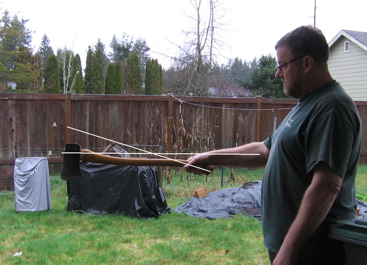

Cook is dead wrong. His error is that he's confusing the grip angle with the axis of pivot. You pivot an axe with your forearm. (Having two bones in the forearm is what allows this twisting of the forearm.) You don't pivot an axe by relaxing your grip and letting the haft twist in your grip.

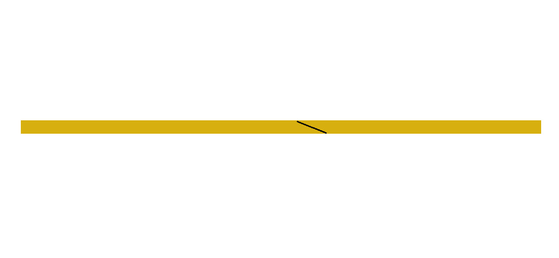

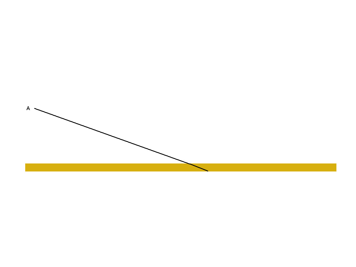

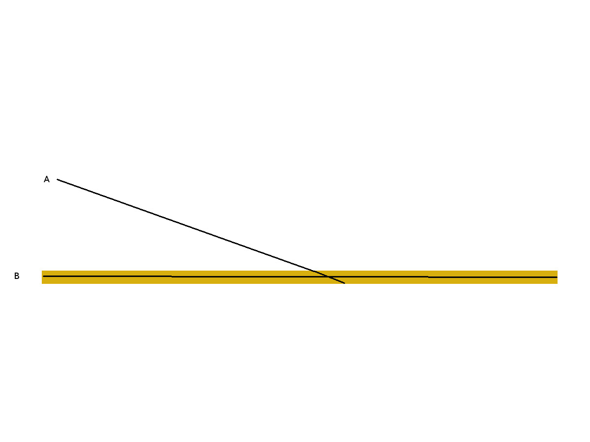

Look at it this way. Suppose you join to pieces of wood together with a miter joint.
Twisting on the right end of the stick results in the left end twisting in line with the stick not in line with the miter joint. Half of the stick won't twist on line 'A'.
It will all twist along line 'B'.
It's the same with your forearm joined to the axe handle via a curved grip.
The axe doesn't pivot along line 'A'. It pivots along line 'B'. Watch the video again.
Square_peg, actually this picture argues for Cook, and against the way you interpret it.
Imagine, that you are holding a straight stick or axe handle in the picture.
Along which line will it pivot?
Along line A, not B.
The determining factor here is your grip, and that depends ultimately on your wrist+palm+fingers rather than your forearm.
No. It can only pivot along line 'A' if you relax your grip and let it pivot on that axis. The pivot is in your forearm not your grip. The grip angle is simply the angle in which the two pieces (forearm and haft) are joined. It's not complicated.
If you hold a straight stick or straight axe haft then you will naturally change the tilt of your wrist. But the pivot will still be in your forearm and not in your grip. If anything a straight haft requires more tilt of the wrist.
Well, I respectfully disagree with the conclusions you draw from this picture regarding the whole process of the axe strike.
There is more to swinging an axe than just holding it in a static position.
This is what I think Chignecto Woodsman is trying to say too, if I understand him correctly.
Look at the picture you have posted:
The direction of a straight stick/handle in the same wrist position and grip would be in the line A, not B.
The actual pivot you are transmitting to the handle is actually that determined by your grip at the contact.
The effective final pivot experienced by the axe head is affected in addition by the form of the handle too.
Once again, think Flex Screwdriver.
So regarding the actual pivot axis of the axe head the pivot axis of your forearm is not so important (it is the rotational axis of the handle of the flex screwdriver in my analogy).
