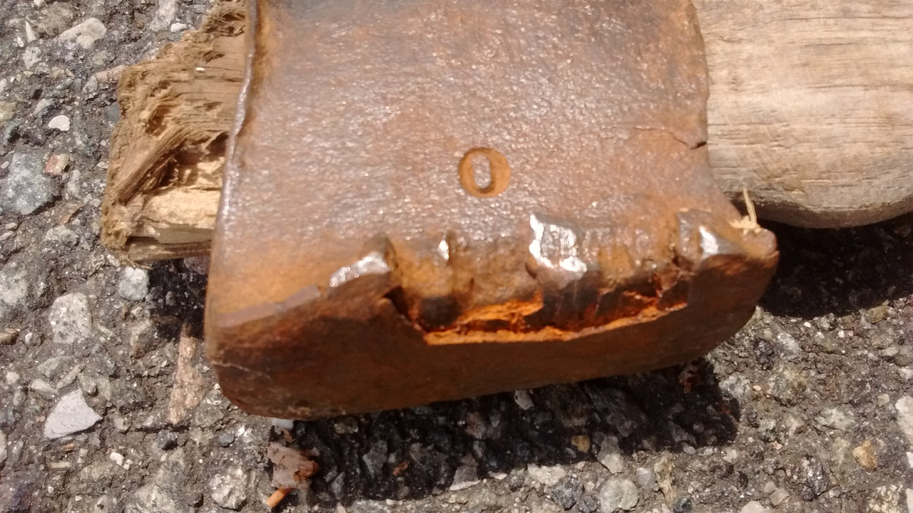

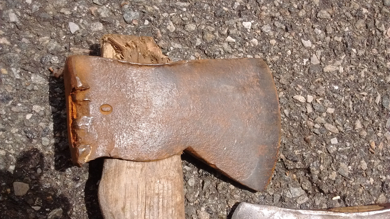

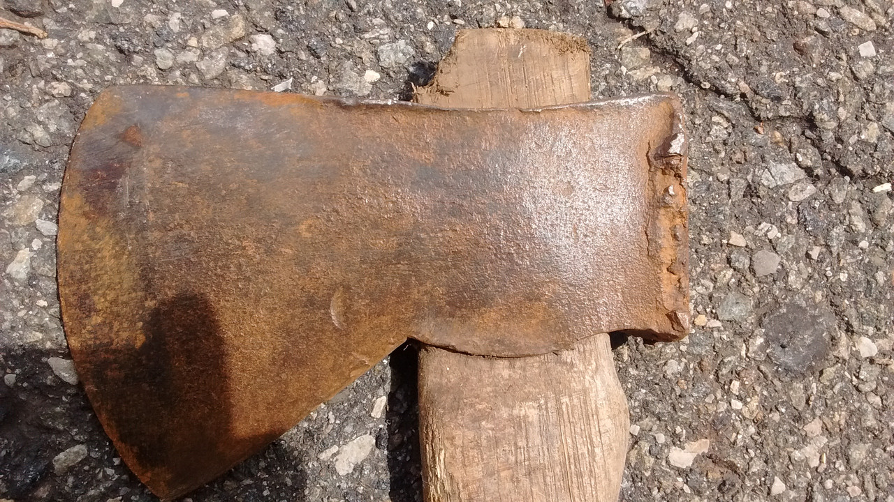

What can I say, I like to buy abused tools. Not sure if this McKinnon bit up poll can give you some new insight about construction of Rockaway pattern axe.
You must be kidding-this is Priceless.Things like this are the absolute gems,rare and extremely valuable...
You're Very wise to obtain these,and lucky to have access and ability to do so.
Thank you SO much for sharing this,and all other valuable data you've contributed.

Another deviation from the process illustrated by Mercer was the steeling of poll After blading(probably not an important difference).
These photos apply rather to that last cracked hard-plating photos of that old Mckinnon.
Plate overhangs the poll by a fraction:https://imgur.com/JT43pmt
And after the butt-weld is done,the edges wrapped around the sides,creating impression of the plate being much thicker than it really is:https://imgur.com/U31cRvW
So that 1/4" +/- thickness starts looking 3/8"-ish +...
