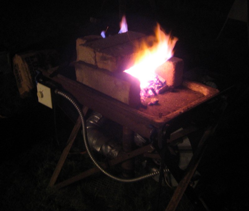

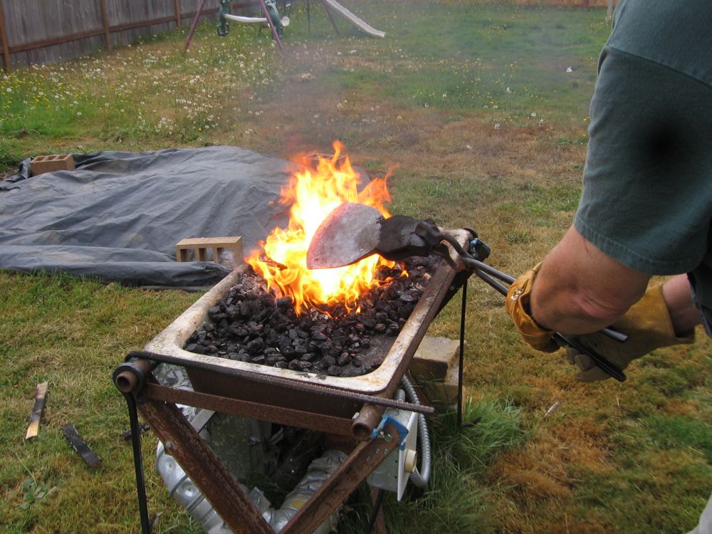

I have mostly worked with hickory charcoal, sometimes fuel coal and sometimes lumps of coal I drag home from local wild sources. Maple Valley is halfway between Newcastle and Black Diamond, 2 local towns named for their historic coal mines. And Maple Valley had coal mines, too. There are still many small lenses of coal showing in outcroppings in the area. Not big enough for commercial mining which is why they're still there. But more than a backyard smith could ever want. I've built a charcoal cooker but never used it as store bought hickory is so readily available here. But it's on my bucket list.
My little home made forge has an old furnace fan for a blower. It's a universal motor that will accept a rheostat (dimmer switch) as a speed control. At full speed I can practically blast the charcoal out of the forge (the small pieces go flying). I enclose the firepot with 16" firebricks when I want high heat fast or to conserve fuel.
Other times I leave it open.
The charcoal is great because it produces no clinker. They say the local coal is no good for forging but it does alright. I'm selective about what I bring home (cleaner stuff) and it works about as well as the fuel coal.
I spring for the anhydrous borax but I've heard it doesn't make any difference so long as you keep what you're using dry.
