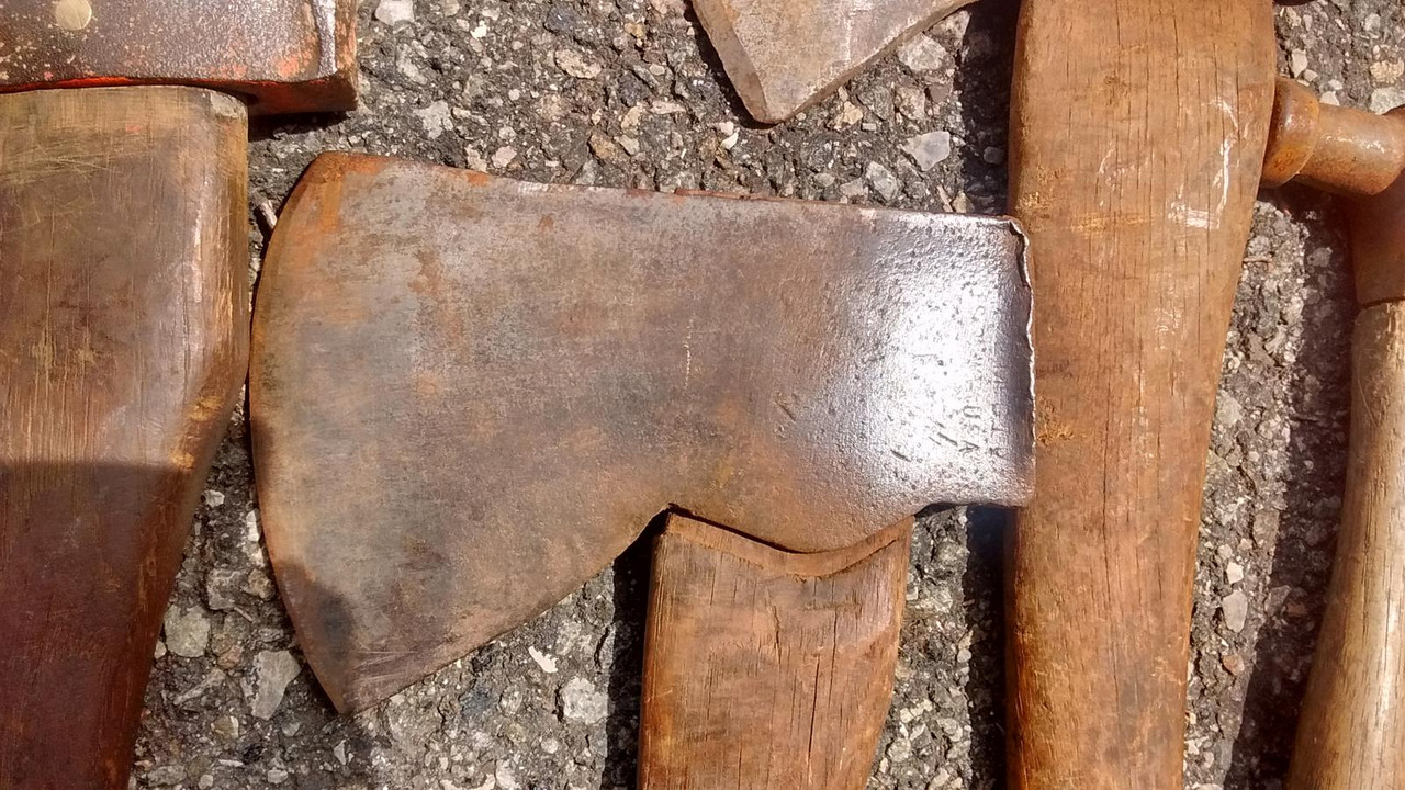

I've never seen boy's size Rockaway. It would be one of its kind.
You are so close!
The line between eye and heel should became a curve.
High centerline forms a wedge when you look from the top.

Actually, once you put it on the handle It screams retro style. The angle on the haft vs the the poll plane reminds me of old Plumb axes(top right).
