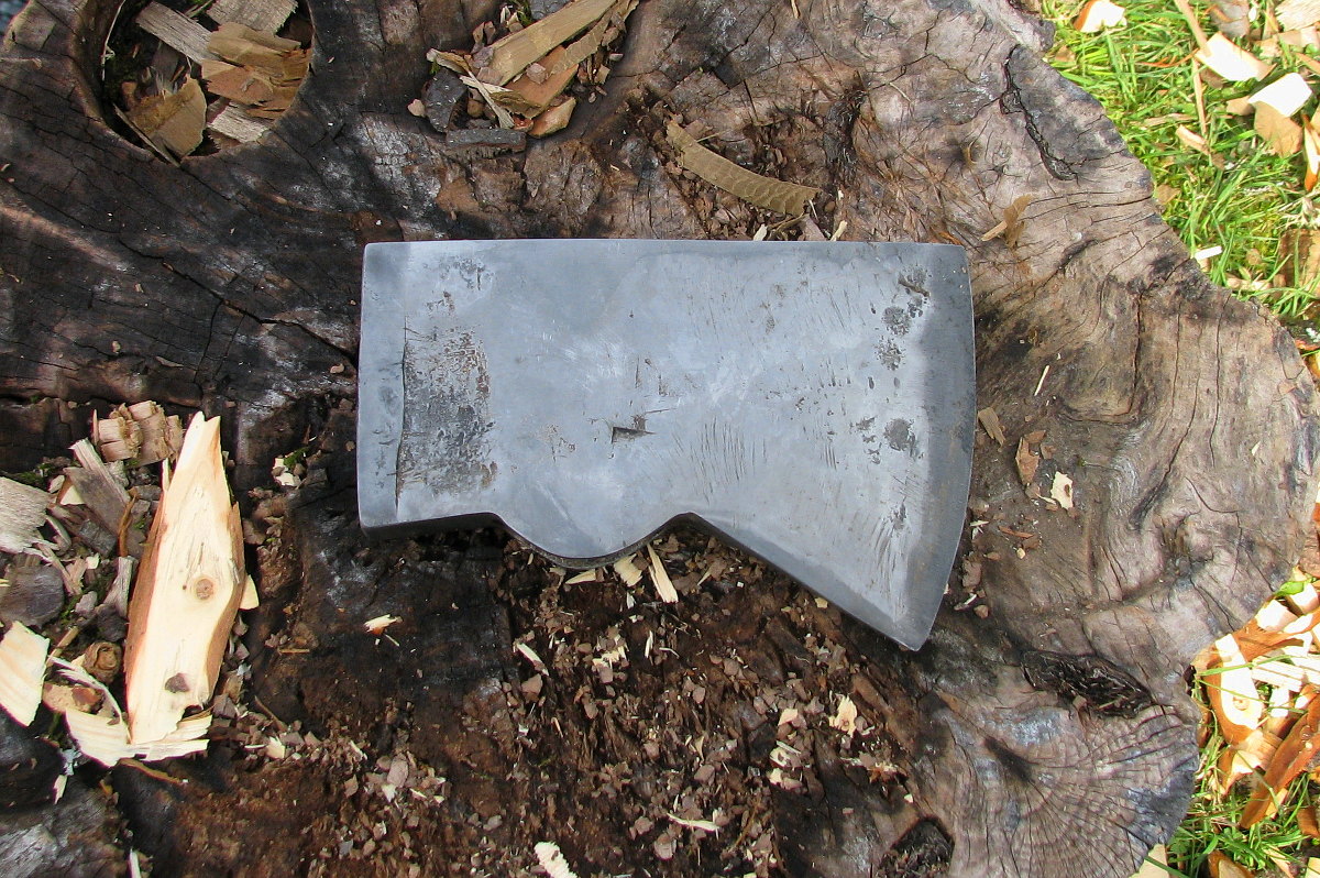

I left it a little rough intentionally. The poll steel is obvious. The dark steel at the bit is the high carbon insert. I have no idea what caused the darkening of the steel along the top and bottom. My guess is that it's how this wrought iron body etches.

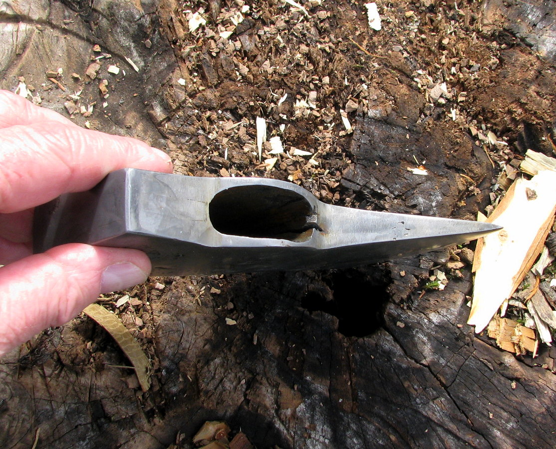

Here you can see the steel filler in the poll and insert for the bit. The weld is open a little in the eye but it doesn't affect the axe. The welds are strong. I had damaged the eye a little while straightening the bit. But it held together well as I fixed the eye with a make shift drift.

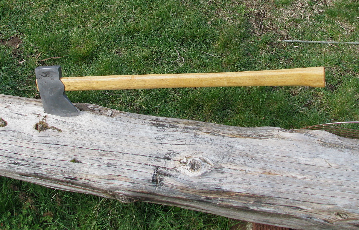

Here it is on its hand made 29-1/2" black locust handle. The finished head weighs 2.7 pounds. I modeled the handle after some handles that Old Axeman put on his historic axes which were made like this axe.

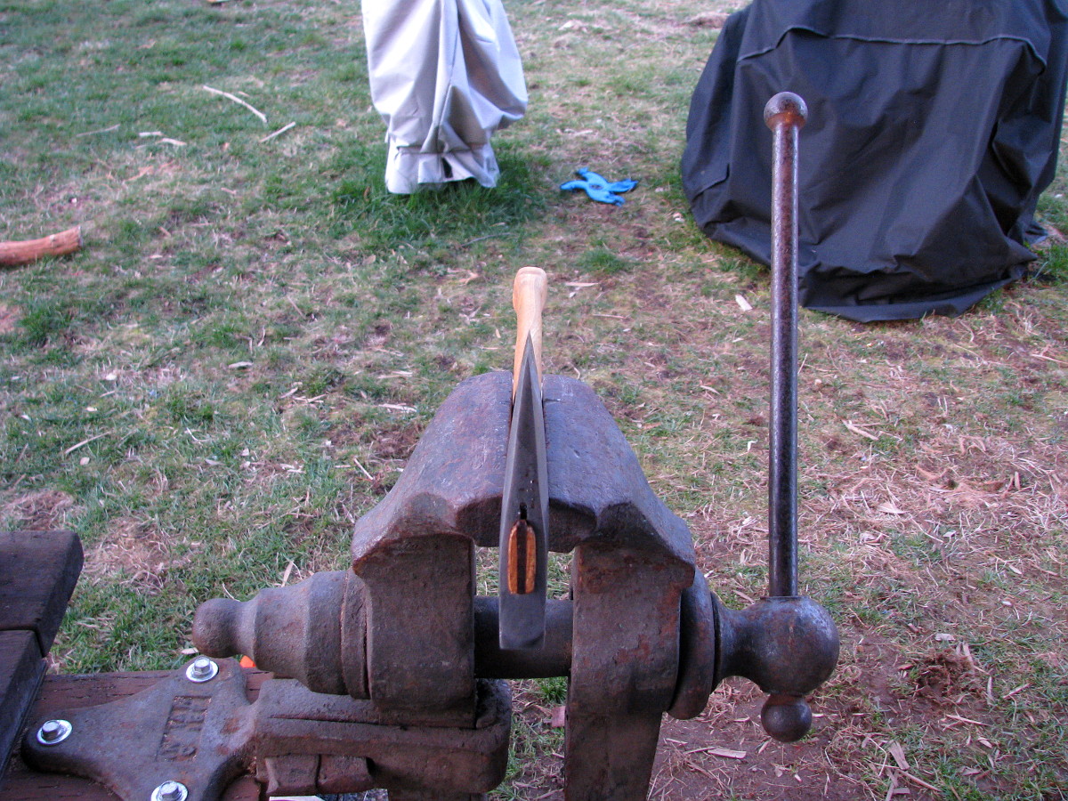

I got that bit well aligned to the haft. You can also see how much I convexed the cheeks in this photo.

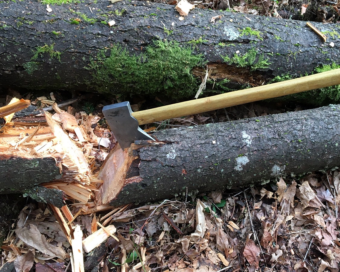

I took it out for a test run today, just a few small sticks. Gawd it handles nice! Cuts like a dream. Good handle length and weight for the trail. I really like it.

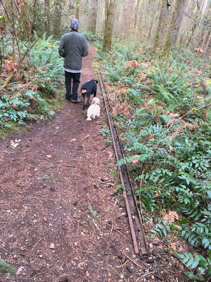

Spotted along the trail as my buddy & I walked our dogs while I made my test run. I've heard a few of you wish you had a chunk of railroad track. This area was logged by light gauge rail 100 years ago and pieces of track remain in the woods to be found. This piece is a little large to haul out. That's my Rottie pup in the middle.
