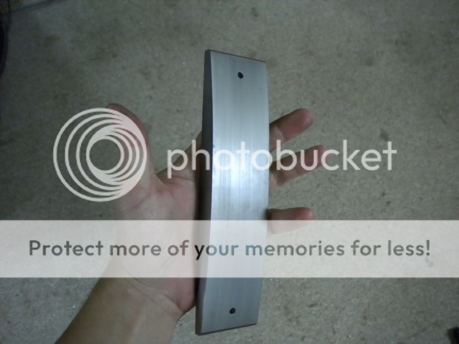

These are precision machined of A2 steel and hardened to HRC 61-62. It is 1/16" shy of 8" to fit between the rollers, 2" wide and has the KMG 1/4-20 6.75" center to center mounting pattern. $80 shipped continental US.
I did an interest thread and 48" was the most popular size, so I that is most of what I made here. There are twenty one 48" for sale. I also have three 36" for sale. This is a total of two dozen platens which should more than cover the folks who wanted one.

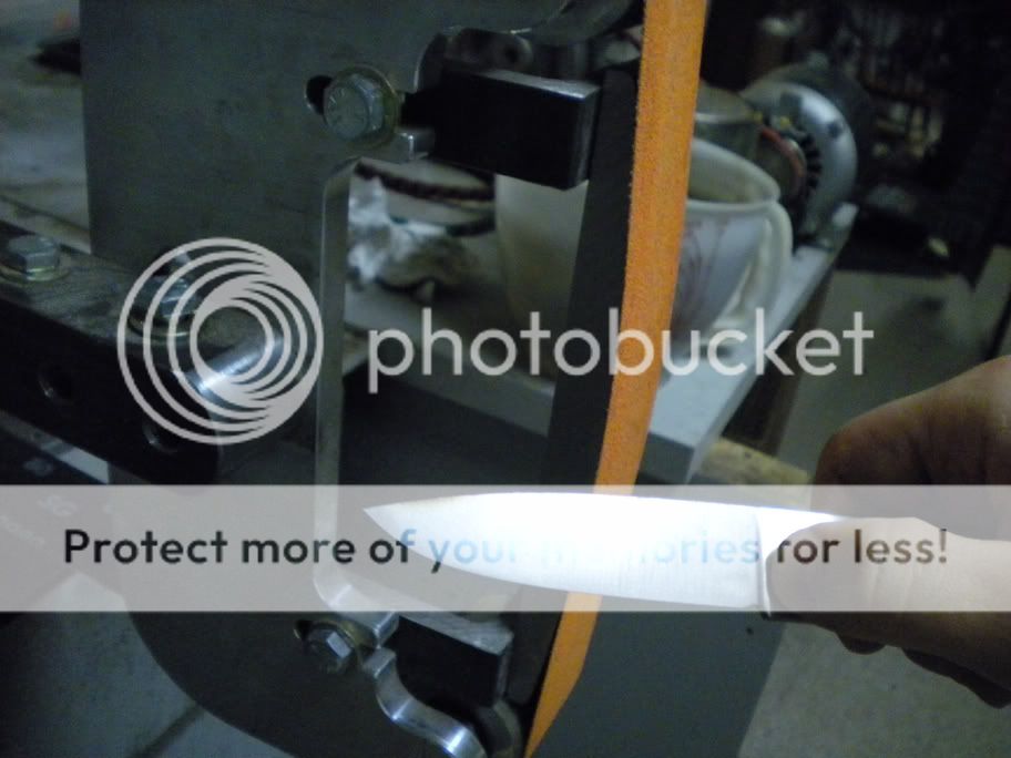

I tried mine out for the first time tonight. I was going to keep a 36, but I had a cull from the 48s, so that what I'm keeping. The effect is subtle, but noticeable. It isn't a flat grind, and it isn't a hollow grind. I believe this is a historically accurate grind for blades ground in yesteryear on really big stones. I see this being a cool grind for blades made in an older style, and blades like kitchen knives that you would want a full height grind on a tall thin blade.
I ground this blade here out quick and dirty, starting on a 10" wheel and then just walked the grind up with the platten. Butch told me he did it the other way around (flat platen, then the curved platen). I ground from 5000 SFM to 1000 SFM. I used a 80 grind Blaze, 120, 220, 400 and scotchbrite. All tracked well. As you can see I set it so only about half the platen was touching. It got hot to the touch, but I could still hold my hand to it. I wanted to try it out before selling it and I'm happy with the way it worked. I did nothing to it, no finishing, just bolted it on.
