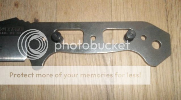

I'm not planning on enlarging the holes.
I intend to make inserts from kydex, or some other substance, and epoxy them to my scales so they fit into the handle cut-outs...then drill my holes in the handle cut out area....using 2 bolts per handle.
I don't quite get what you're describing, but look forward to the result.
I'd use a stepped drill bit specifically for counter-sunk bolts like that - the knife suppliers sell 'em in various sizes.
Clamp the knife atop a piece of scale, drill the shank holes in the appropriate location. Then flip and countersink using the new holes as the pilot. Then, since you don't have registered holes in the tang, I'd clamp the first scale with the two holes in it to the other blank. Then drill the pilots through from the first scale side. Throw a pin in there, then drill the second. Then split 'em apart, countersink the other, and viola - you dance a jig.

thanks, that reinforced what I was thinking, and made at least one step clearer/easier.
What is the part ur not clear on? the insert? I meant I'm gonna make the full-size scales similar to how the zytel for the 14 are, with a raised area that fits into the handle recess to prevent lateral slippage. It may not be needed, with enough force applied to the screws...but I'm a firm believer in Over-Building LOL

gotcha now.
Interestingly, my big beckers have slop in the handles/bolts. I'm sure this is normal - really, the only way to mass-manufacture and avoid hand-fitting. Once they're tight they don't go anywhere. Still, I think it's wise to plan an insert of some kind. Should be cool. :thumbup:
