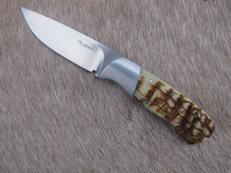

A fixed blade in ATS-34 with Bighorn sheep scales that I ordered from Ron Gaston 20+ years ago as my hunting carry knife. Once I received it, I just couldn't take it out into the bush. So it sits in my den where it gets lovingly fondled from time to time.

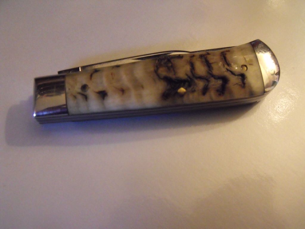

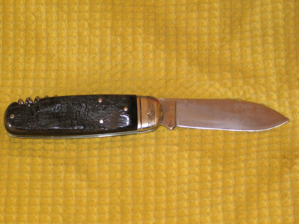

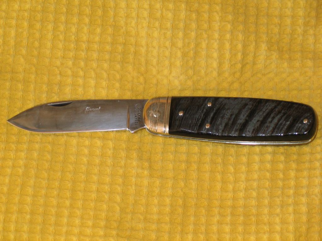

An old "Bouledogue" made by M. Issard with mountain sheep ram horn scales for the cutlery Daniel in St. Brieuc. One side is very barky, both are a deep brown with some lighter streaks. The mismatched scales make it quite unique. The pictures don't do it justice, alas. It's fascinating to look at and pleasant to handle : warm, grippy with a very firm hold.

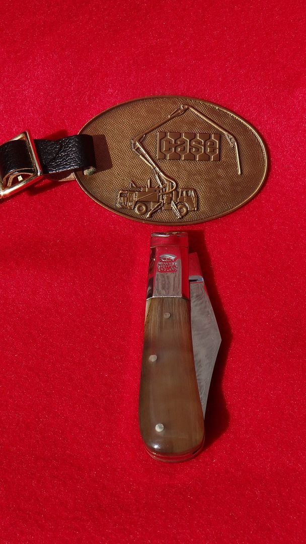

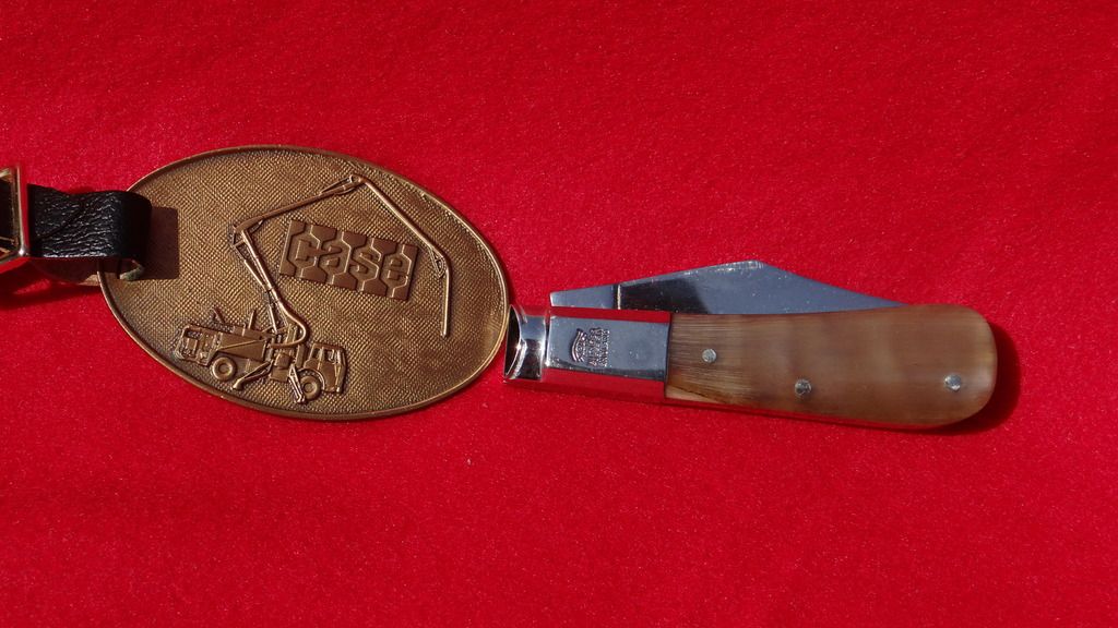

Yes sir Dylan here it is. Ramshorn with a blue liner on one of my Rodeos:

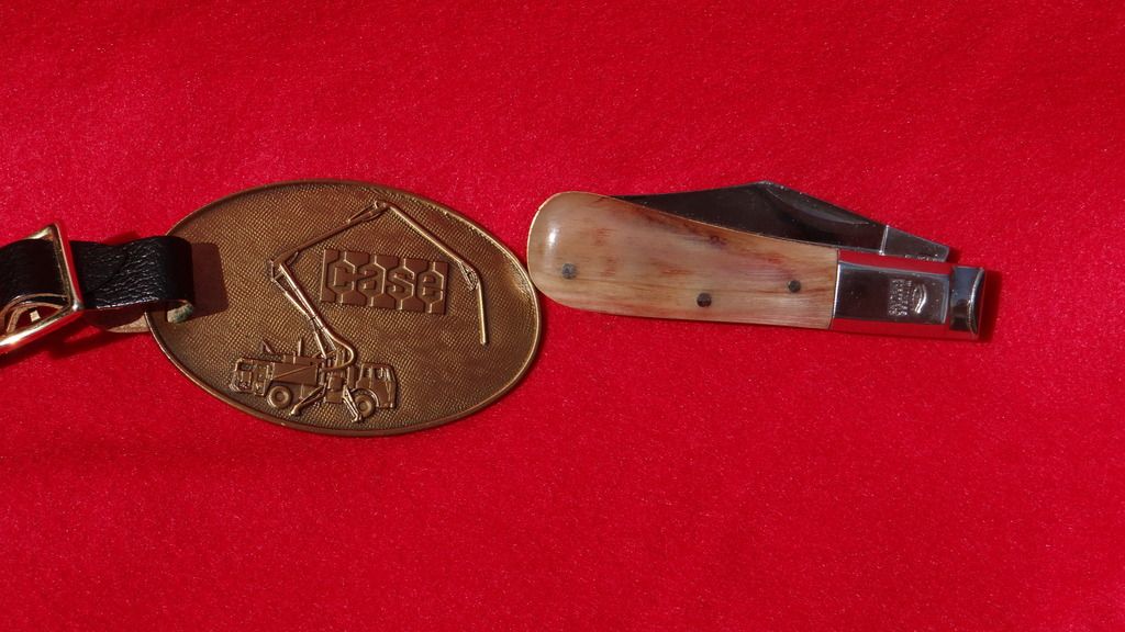

Matching set of Rancheros with red liners:
