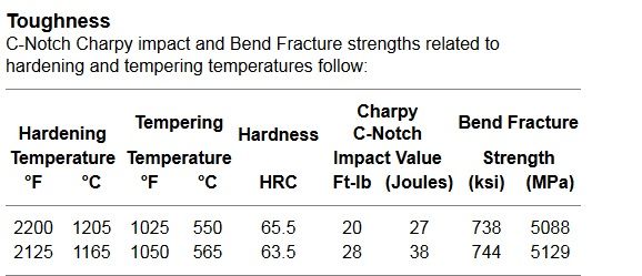

One cannot go on Charpy tests data given in datasheets alone IMO. Why? Because there is a lot of data not given. Here is a post I did:
Unfortunately in most steel data sheets available to us there is no specifications by many manufacturers and one is left with a few questions.

It is also important to remember that one cannot just compare different steel categories to each other. Even similar steel categories such as in the Shock-resisting steels can have different values because of the variables I mentioned above and different heat treatment.
