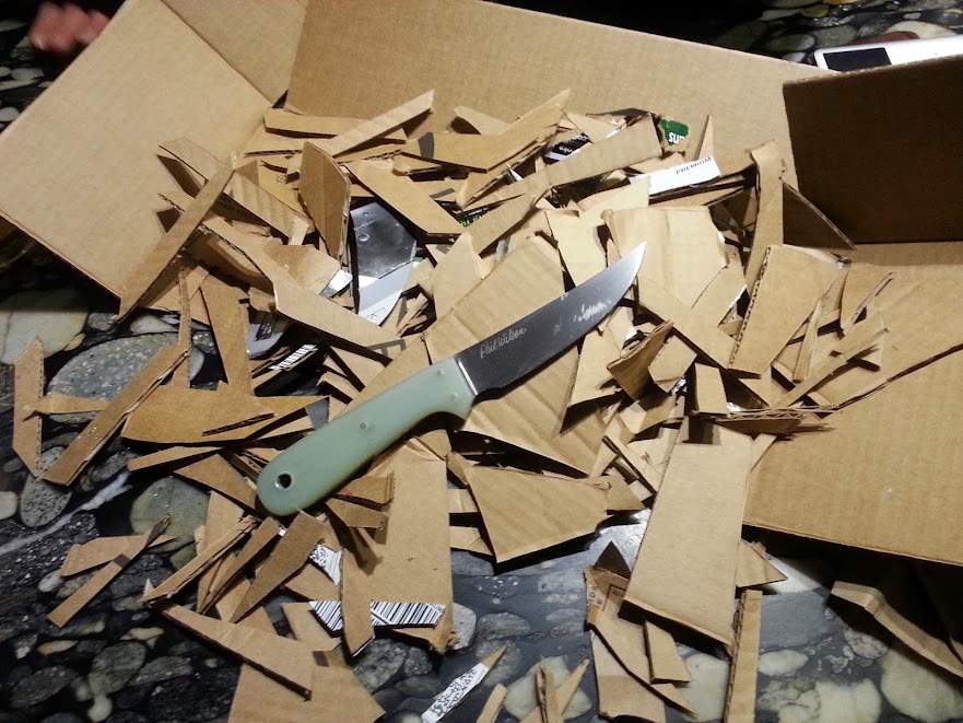

I thought the K390 and S110V would be closer, but then the S110V is softer. Maybe a lot softer. Jim shows the K390 at 62-64 HRc. I believe that the S110V mule is 60-61 HRc. So it's possible that Jim's test is comparing a K390 at 64 HRc to a S110V mule at 60 HRc. Switch those hardness values, and I'd expect the S110V edge to race into the lead.
I was surprised that Spyderco ran the S110V mule that soft. My K390 has really impressed me. It's like a self-propelled Honda going through cardboard. I haven't had a chance to test the S110V mule, but I thought it would be a good cutter. Mine came at 40 degrees inclusive, with a shoulder width of just 0.015.

You will like the S110V Mule a lot, it cuts very well, the HT on it is awesome, dead spot on. :)
Sending the Mule off to get tested so I will know what it is hardness wise.
