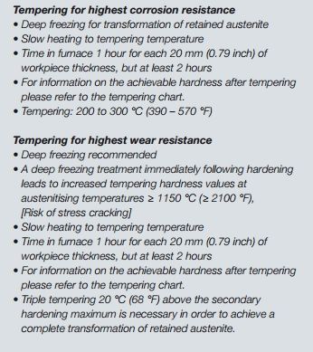

Where did you get that tempering information? From discussing with Bohler SA and many knife makers they go by the recommended information:
BOHLER M390 MICROCLEAN
2100&#8304;F, 20-30 minute soak, Deep Freeze, 2 tempers at 390-480&#8304;F, 60-62 HRC
http://www.bucorp.com/files/KNIFEHEATTREATSUM2.pdf
Or:
With oil quench and subzero treatment they use the following tempering graph:
http://www.bohler-edelstahl.com/files/M390DE.pdf
Tempering for maximum corrosion resistance is between 200 - 300 C and Maximum wear resistance with secondary hardening is 520 C from the data sources I have spoken to.
I did look at your provided link and saw it is page 13 of ?. The rest of the document would be nice to read and educate oneself.
First question: are there two tempering temps where we get the same 61HRC value as 1150/150 vacum (or 62 and above with deep-cryo)?
Give it a look to this file http://www.danieleberti.com/dan/knives/m390_ht.pdf
Probably yes.
But there will be no noticeable difference in wear resistance. Such a wear resistance difference at same 61 or 62HRC, at same austenitizing temp but with different tempering temps would be present and significant ONLY if using 500° tempering, which is secondary hardening.
Exactly. That is my point. If a maker feels that his M390 in the specific design should have maximum wear resistance, temper at the 520 C region for secondary hardening. If he wants maximum corrosion resistance temper at the 200-300C region. Both can yield an HRC of +- 62 but with different characteristics from the same steel.
