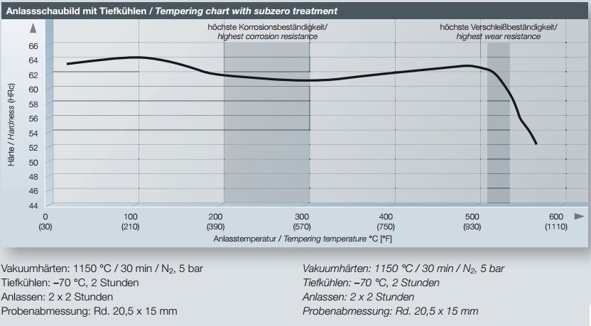

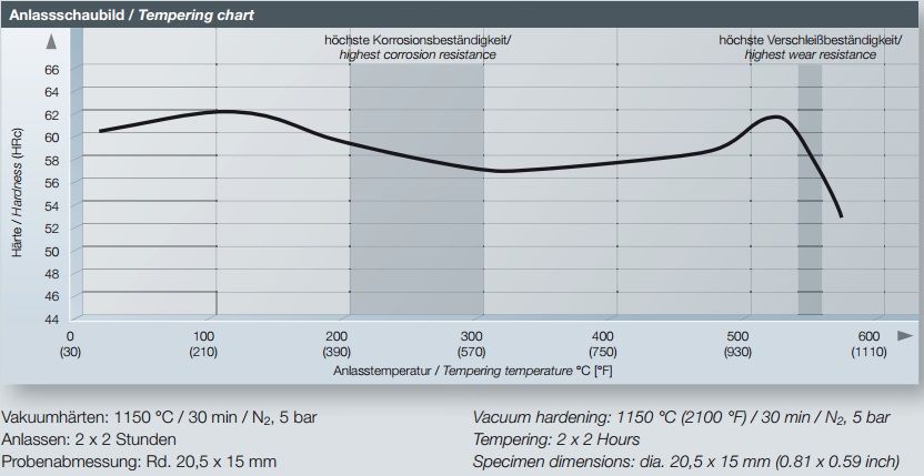

Elmax, M390 and S90V have a distint peak in second. hardening range. As far as Elmax is concerned it will be also the toughness peak. For the other two SS it will not, but you'll be very close to it. No need to Deep-cryo in this case as high temp tempering will minimize retained austenite anyway. Just three tempers instead of the mandatory two.
No hope we'll ever find this HT in production blades, buddy. And very few custom makers are willing to do this as well. To my knowledge and purchase Elliot Williamson and Neels Roos.
Yet for sure an M390 blade could at least be brought to 62HRC via vacuum furnace, decent overpressure quenching (5bar) and deep cryo. It would make a world of difference against the usual 60.5HRC.
Secondary hardening also has disadvantages from my understanding and reading.

For those that have not seen the tempering graphs with regards to M390 here it is from the M390 Marketing pdf.
That's not the problem, the problem was taking a blade that was already HTed and Tempered and running it through the whole process again to get it from 59 to 64 when the chemical changes have already happened the 1st time.....
Actually the changes are in physical structure.

There is a study (above mentioned as well) that has proved that Elmax austenitized at a certain high temp and tempered in SH range reaches its best hardness (63) and toughness (43J).
Elliot Williamson states that once used high aust/SH finally took the very best out of S90V.
You can spot these alloys' composition and I can confirm that none of Elmax and M390 knives so treated in my ownership has ever shown any stain resistance issue whatsoever :)
Taken to the Alps, taken to Tuscany trekking near seashore.
I can confirm, on the other hand that I had a couple of underhardened Elmax blades poorly HTd and with a very poor edge finishing (grit) failing (stain). Four S35VN underhardened blades did the same.
The critical factor being too low austenitizing temps and probably to slow quenching timings.
Anyway, I've quite a bit of knowledge about S90V, Elmax and M390 and less about other steels, yet on SA Blade forums there is QUITE A BIT OF A KNIFEMAKER who made heavy duty knives for special navy commandos in RWL34 right with SH.
Examples mentioned are 154CM and BG-42. None of them PM steels. None of them 3rd gen as Elmax, M390 or even 1st as S90V, which I mentioned explicitly.
Please correct me if I am wrong but is the secondary hardening not affected by the alloy content regardless of the PM generation or if it is even a PM grade?
On another note. I am not against secondary hardening, I own quite a few blades with it and have good experience with the knives I own. I just want others to understand that though it can be done, there are trade-offs, as with everything else. Depending on what is important to the knife maker and the design the maker should alter the tempering accordingly.
