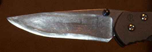

STR
[large visible burr]
STR said:
To me those are a negative and not something I want to see when sharpening ...
Generally not, they are useful for a novice as they let you know you have reached the edge, as moving from shaping to honing is one of the parts which is most difficult early on. Soon though sharpening tends to focus on minimization of burrs so you do things to prevent this build up. For example I will often do burr removal before an edge has been completely shaped, but this would be frustrating for a beginner for several reasons.
However regardless of techniques some steels are very problematic in this regard, especially the soft stainless. It isn't uncommon for me to have to try more than once to get a clean edge on them which isn't visibly burred. By this I don't mean a mm wide strip of metal that you get when filing sometimes, but a small edge bias you can see if you tilt the edge under light. It is readily visible as well under low magnification as a shadow.
Without this removed the sharpness will be fairly low as in less than half of optimal and the edge retention just a fraction, 1/10 or less. Removing this can be very difficult because it doesn't take much force to fold the edge but it can take a lot of abrasion to cut it due to the carbides so it is hard to make it cut without folding. Diamonds are really nice for this as they cut aggressively at low force.
-Cliff
