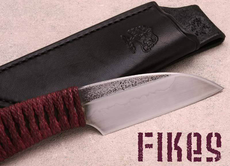

here's my chiseledged Fikes that I just did a sanding and acid etch to bring
out the hamon in it, while it was made as a hard working user, I wanted to
make it a little nicer so worked on the blade recently ;)
G2
Gary W. Graley,
You're a cruel, cruel man for showing your re-etched Fikes Wharncliffe.
Sorry man, lol, how do you like the font for FIKES eh? classy?
G2
