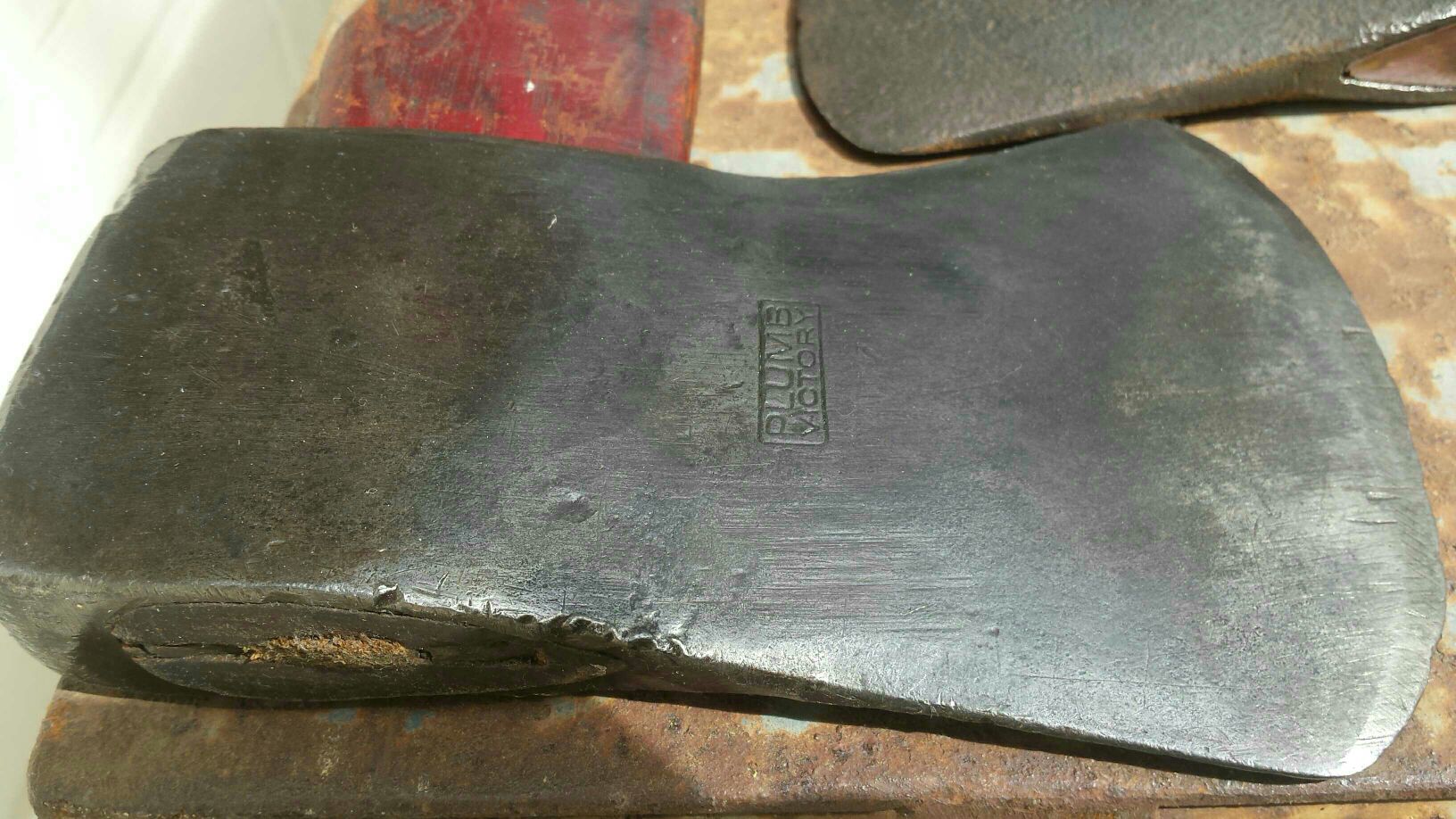

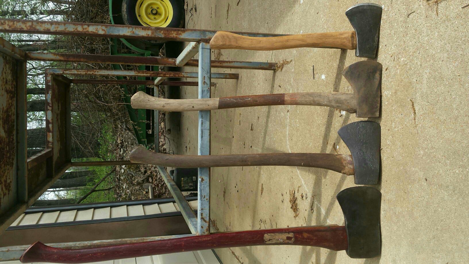

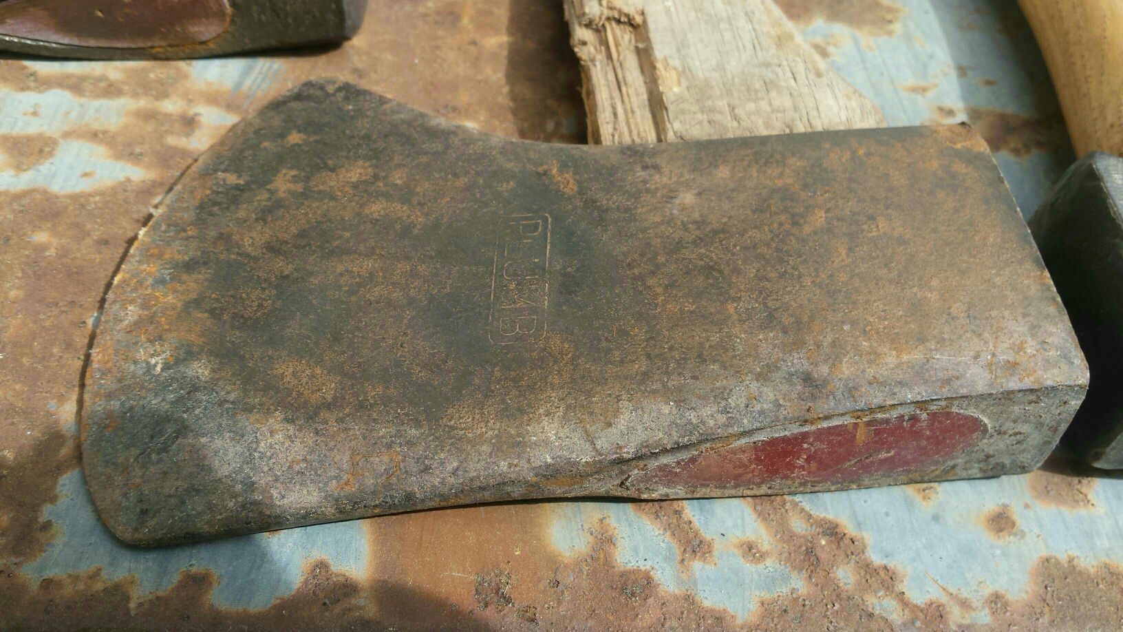

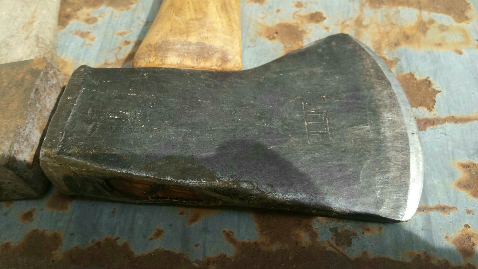

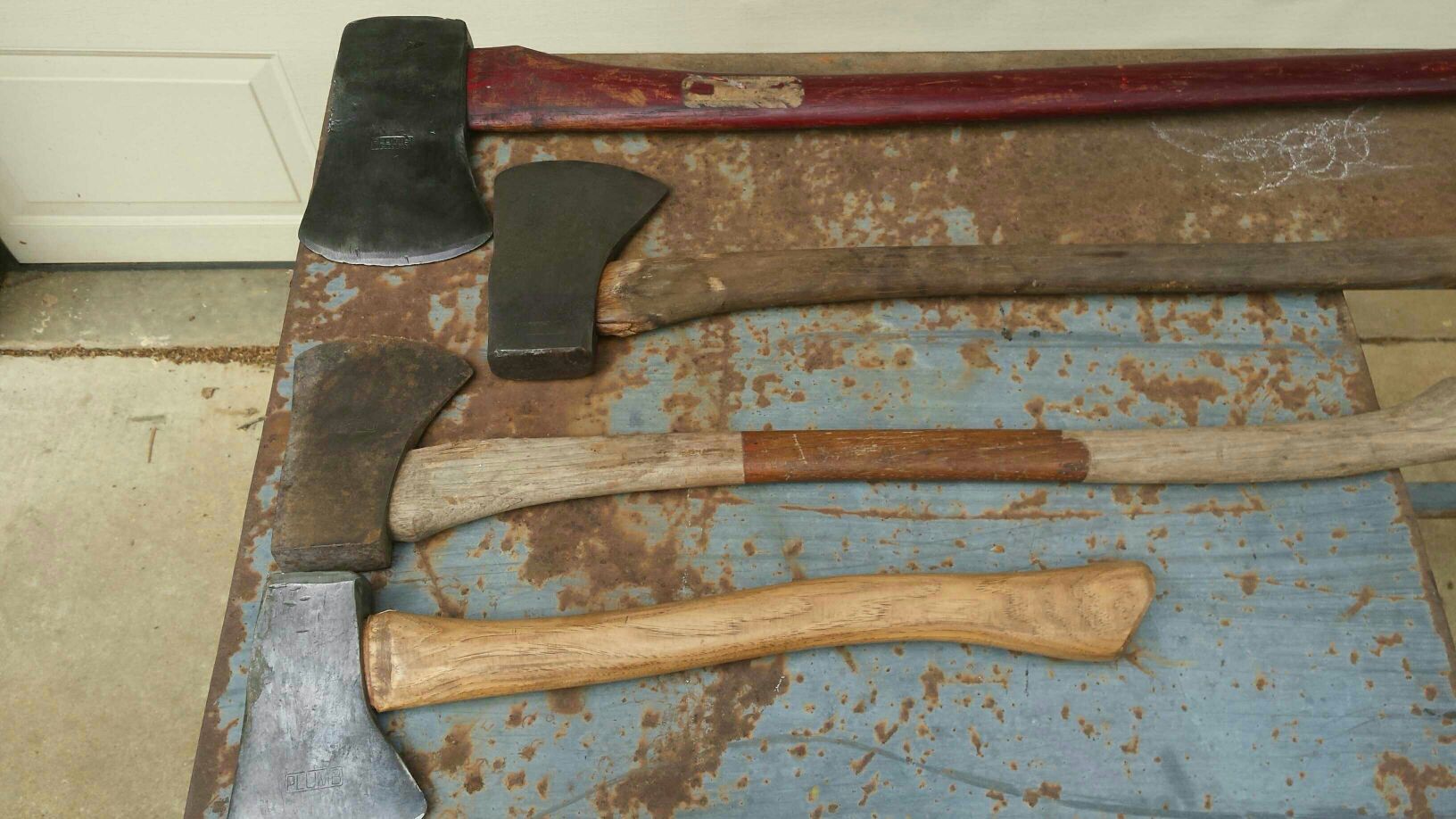

Just found this thread and wanted to post my Plumbs. I just got 3 of them but I've had the small hatchet for a couple years and I rehafted it but the other I haven't done much to yet.
By the way what are the head weights of these?Nice 'gathering' (as opposed to 'collection/school/herd/flock/troop/bevy'...) of axes you've got there. Spying the profile of the "Victory" (1945-1948?), and knowing what the 'Cedar' model looks like, I can see how the 'National' pattern evolved and came into being in 1948. By the way what are the head weights of these?
Steve Tall has theorized that Plumb might have differentiated the factory that made Nationals (there were two Plumb manufacture locations) via stamping on the right or on the left. Two of yours are unconventional (right side) and the third is standard. The Victory is also conventional stamped on the left.
Enjoy those old classics! The Victory model is definitely the oldest one and far as I know Nationals didn't survive The Ames takeover of Plumb in 1971 and for sure not the Cooper Tools takeover of Ames/Plumb in 1981.
I don't know the weights of any of them as they're not marked that I've seen so far and I don't have a scale but the Victory seems to be a 3 1/2 LB.
Its interesting that rbeggs's middle national pattern with the permabond handle does not have the beveled poll. It is just left square kind of indicating a unhardened poll? I do not recall ever seeing a Plumb National pattern like that. But I do not think it is a Cedar axe.
Why some of those National patterns have hardened polls and others don't even though they look like they should with rafting pattern like polls will probably always remain a mystery to me.
I've cleaned the Victory and it's not marked but I haven't got around to cleaning the other ones yet. Yes I clean with a 3" twisted wire cup brush on a 4" Dewalt angle grinder. I've cleaned up probably upwards of 300 axes and hatchets. That's not counting brush cutters, pulaski axes, kaiser blades hammers, old butcher knives, green river style skinning knives......it goes on and on! My wife says I have a sickness....Often they are marked somewhere and 3 2 for instance would indicate 3 2/4 lb. and 1 3 would be 1 3/4 lb. Hardware stores carry various types of wire wheels for use in electric drills. These aren't abrasive enough to grind or damage steel and will clean up those heads very nicely.
I've never had a hardened poll axe that I know of. I "tested " the beveled poll Plumb axe with a file and it doesnt seem to be hardened but I could be wrong. I got excited when I first saw it thinking it might be hardened.You are correct, that one is lacking the bevelled corners and the poll is not as pronounced (ie tall) as a National, and you are right in that it doesn't correspond to the more 'butterfly shape' of a Cedar pattern either. The Permabond definitely puts this head in the 1955 and up era. An experimental, prototype, or a modified Cedar perhaps?
