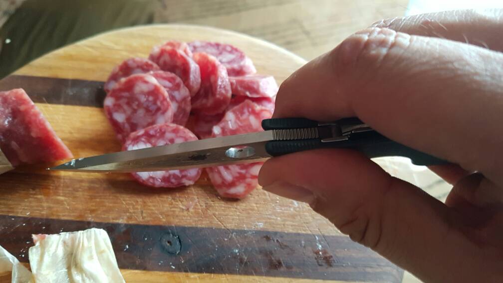

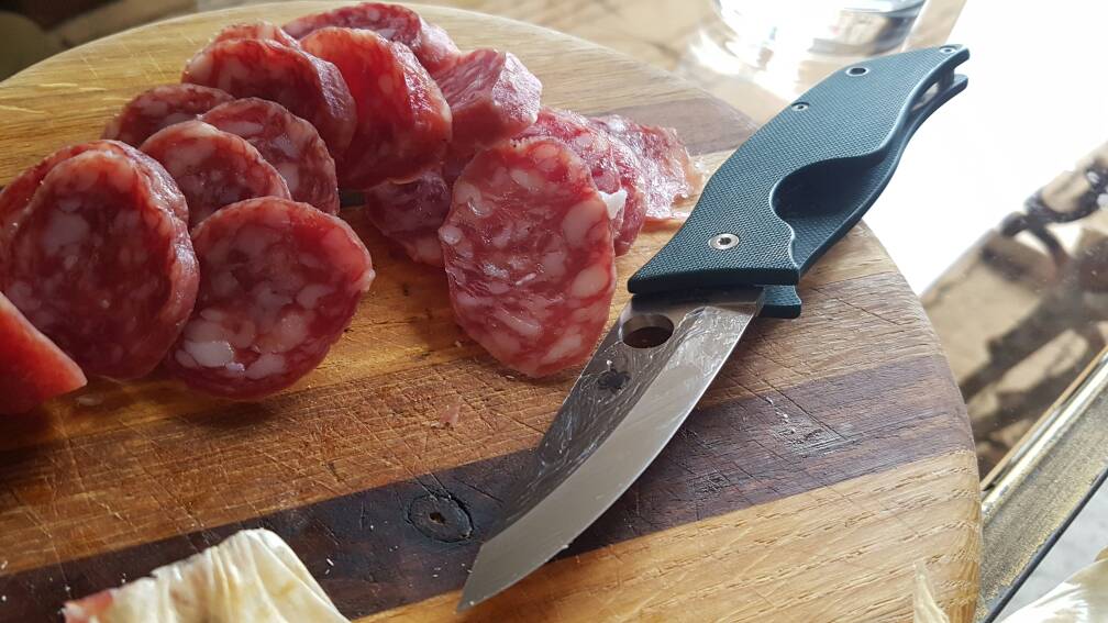

It is a stout knife but much smaller than I was expecting. It would be great in the role of a companion knife to a fixed blade.
This little buddy is slicing (push cutting) in some dry sausage with incredible ease.
The same way the Pekka Tuominen Pukko does.

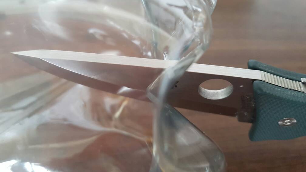

Today I have tried my plastic bottle butt challenge.
It did not get through as easy as a ffg.... But it was able to.
Very solid feel when forcing on it.
Envoyé de mon SM-G930F en utilisant Tapatalk
Thanks for the update Nemo! I was curious about the bottle test...seems like a good result for this grind. Have you stropped or sharpened the edge? Fascinating knife :-)
Still on the factory edge.
But some leather stropping and some elbow oil for getting it to razor sharp. A very hungry edge. . . ☺️
Not the best tool in my box for that test for pure geometry reasons.
The Bush crafter in O1 could not go easier through the plastic.
