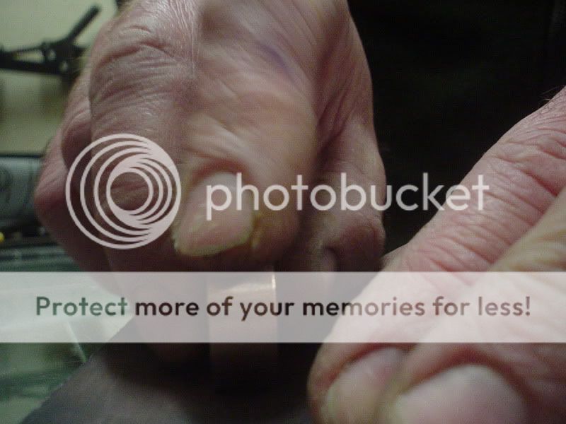

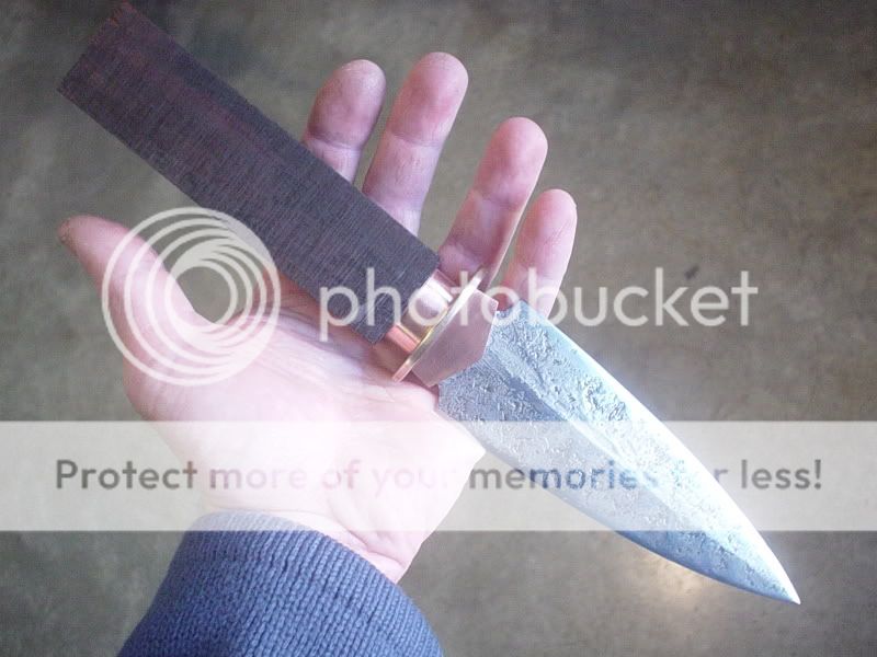

at this point, the guard is pretty close to done. Still finishing work to do, but the shape has been chicken-eyed to being close to symmetrical and all the edges are finished about how I want them.
I still can't believe how well the parts fit together so far. Very close tolerances. I can install all the parts by hand by 'walking' them on, and they come off similarly. Nice and tight!:thumbup:

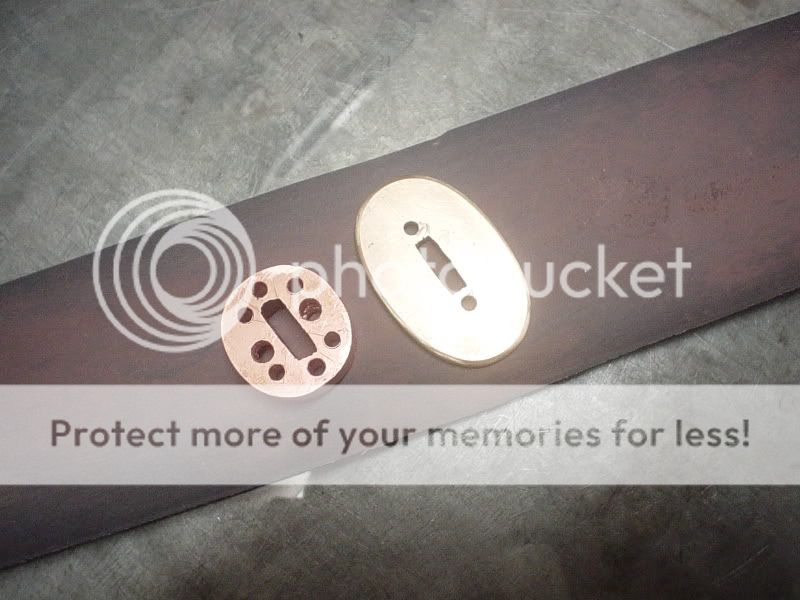

I spent hours working away on the copper spacer. There is some work to do at home tonight with the drill press, but almost done with it.
I really hope to have all these parts epoxied to the tang sometime tomorrow. I'm really looking forward to getting the handle on and especially to coming up with a complete knife. I think it's going to turn out really nice.

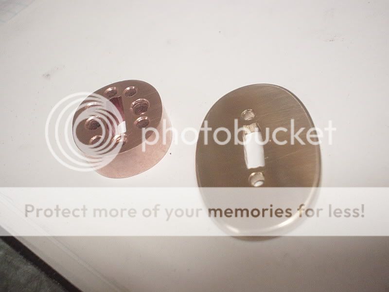

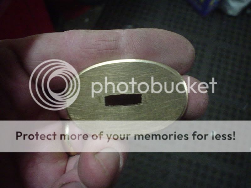

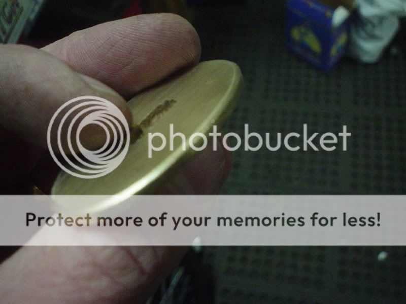

the fittings are heavy man. Heavy.

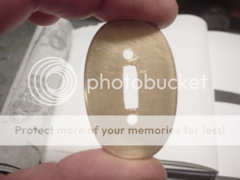

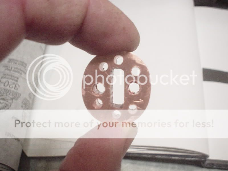

So, I filled them with Drillium...
I doesn't matter because it will never be seen, (or does it?) but the next time I do something like this I will use a center punch and align the holes before I drill them. That way, I can maximize the amount of material that needs removed. This is good though, I'm trying to get it to balance at the guard. There is the concentration of mass which I hope will make this somewhat heavy weapon feel lighter than it is.
Another thing which I've discovered is going to be crucial to my enjoyment using the drill press, is a vise. It was quite scary holding these little metal chunks under the press. I discovered that cutting fluid is VERY important, as is low speed and a lot of patience.

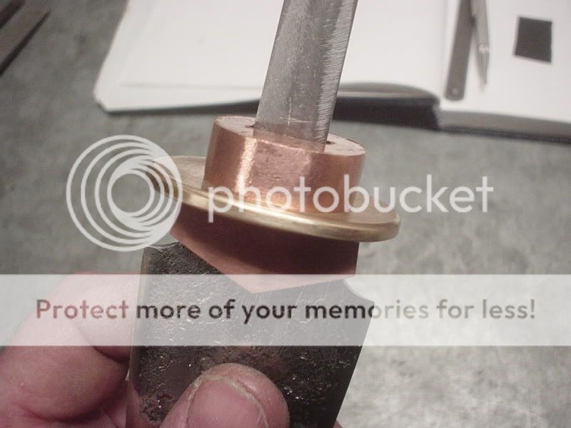

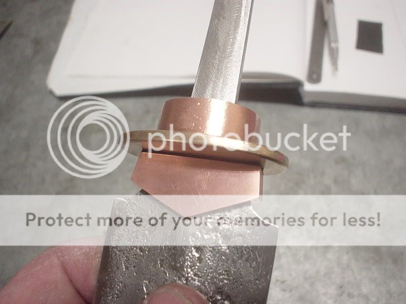

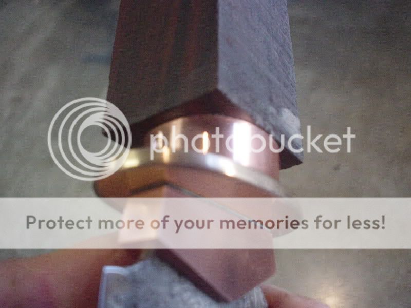

My hope is to finish up the fittings and get them all glued on by the end of the day. I'm so pumped to get this finished! Of course, then it's sheath time...

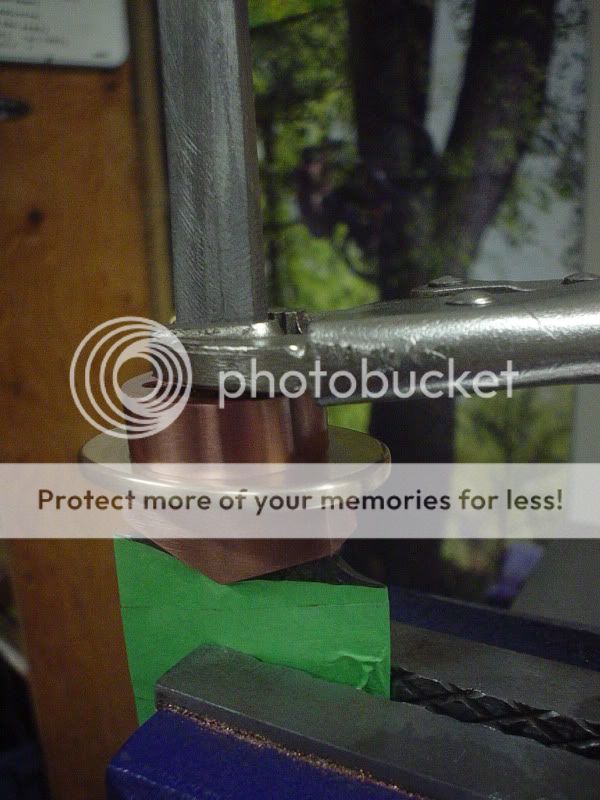

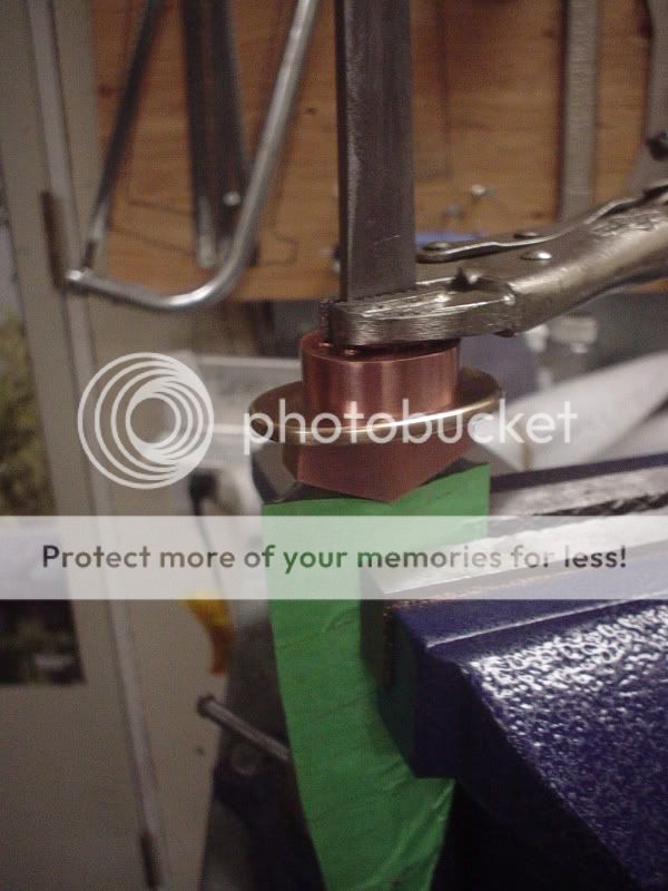

ye olde JB Weld hath bonded mine fittings!
I'll let er sit overnight with some heat and hopefully get that handle going pretty quick here.

so she's all glued up now. Last night, I noticed that epoxy kept squishing out in little blobs between the handle material and the copper spacer. I used a razor blade with thin fabric over the point to wipe away the epoxy. It did a pretty good job of keeping everything clean and fortunately no more epoxy squeezed out over night.
I'm filing the profile into the handle now, but being cocobolo, I'm taking my time. The stuff can make a guy feel like shit if he breathes too much dust in.
Looking forward to bringing it home tonight and keeping the fingers crossed that I'll get that hole drilled right.
Lorien if you wax the outside of your handle parts before gluing them up, you don't have to worry about cleaning up epoxy afterwards. It just pops off when you nudge it with a piece of wood or plastic and leaves the guard and spacers clean.
yet another great tip Harry:thumbup: I used wd40 to clean off the epoxy, it seemed to work pretty good, but next time I'll go and wax it all up first, that's a great idea.
Acetone is the best for cleaning up epoxy but that wax trick is a good one. I'll have to try that.
