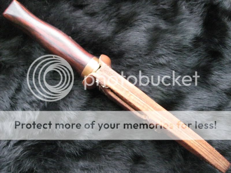

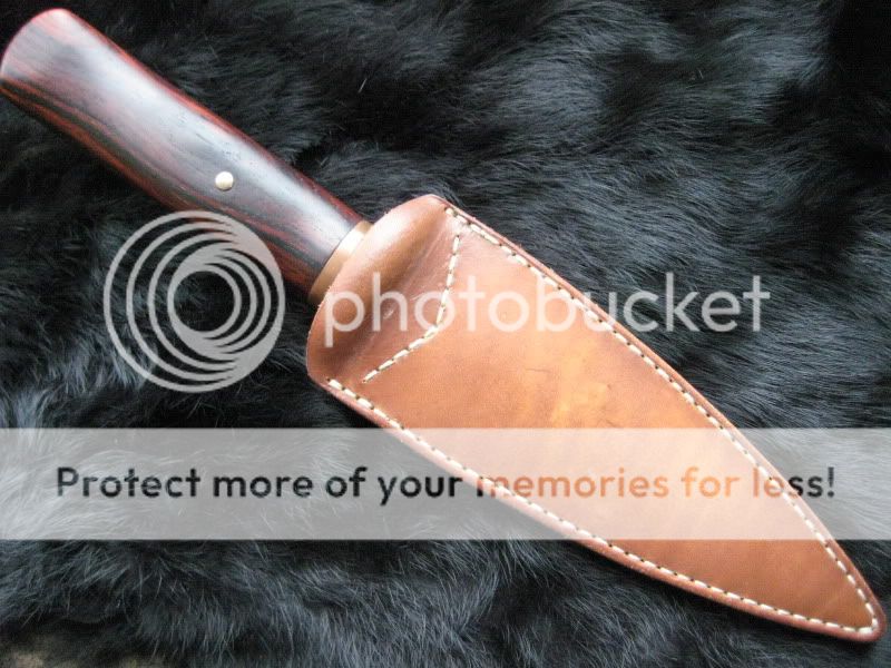

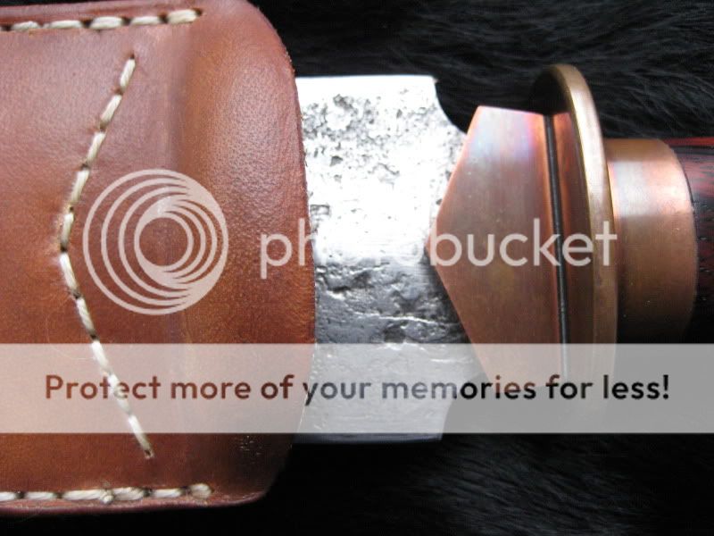

sorry to resurrect this old thread, but to be fair it was a WIP thread and now that the sheath is made, this process is complete.
While this sheath ain't a beauty queen, it is quite serviceable and I learned some new skills in making it. It is the first sheath I made using a drill press to make the holes for the stitching to go through and the quality is quite a lot better than past efforts. The thing I'm most pleased about is the retention of this sheath in that the knife 'clicks' solidly into place and the sheath holds onto the knife really well once it is in there. Kinda like kydex, but in leather.
The leather is around 10oz and is treated with a mixture of pure bee's wax and parrafin wax. Usually I'd use straight up Snoseal, but I didn't have any and this concoction seems to work pretty well.
