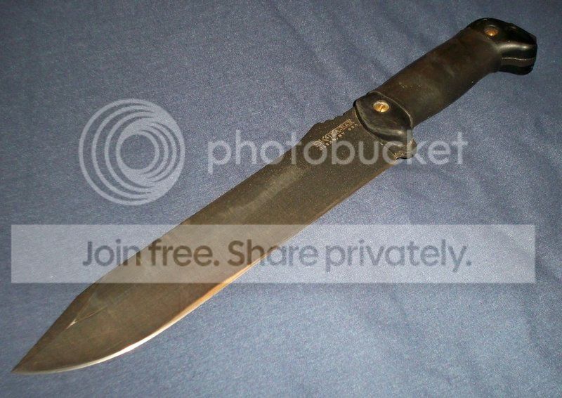

Becker BK9

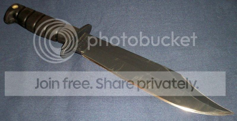

Ontario SP10

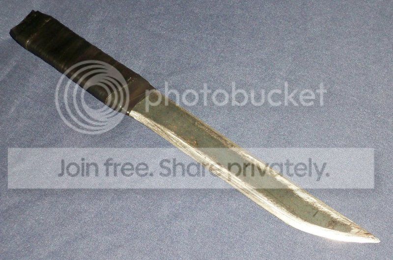

13 inch long blade, 1.75 inches wide, around .275 thick at the ricasso, hidden tang threaded with cut down large Corby nut silver braised to the underside of the butt cap. It balanced about an inch in front of the plunge cut. ;)
