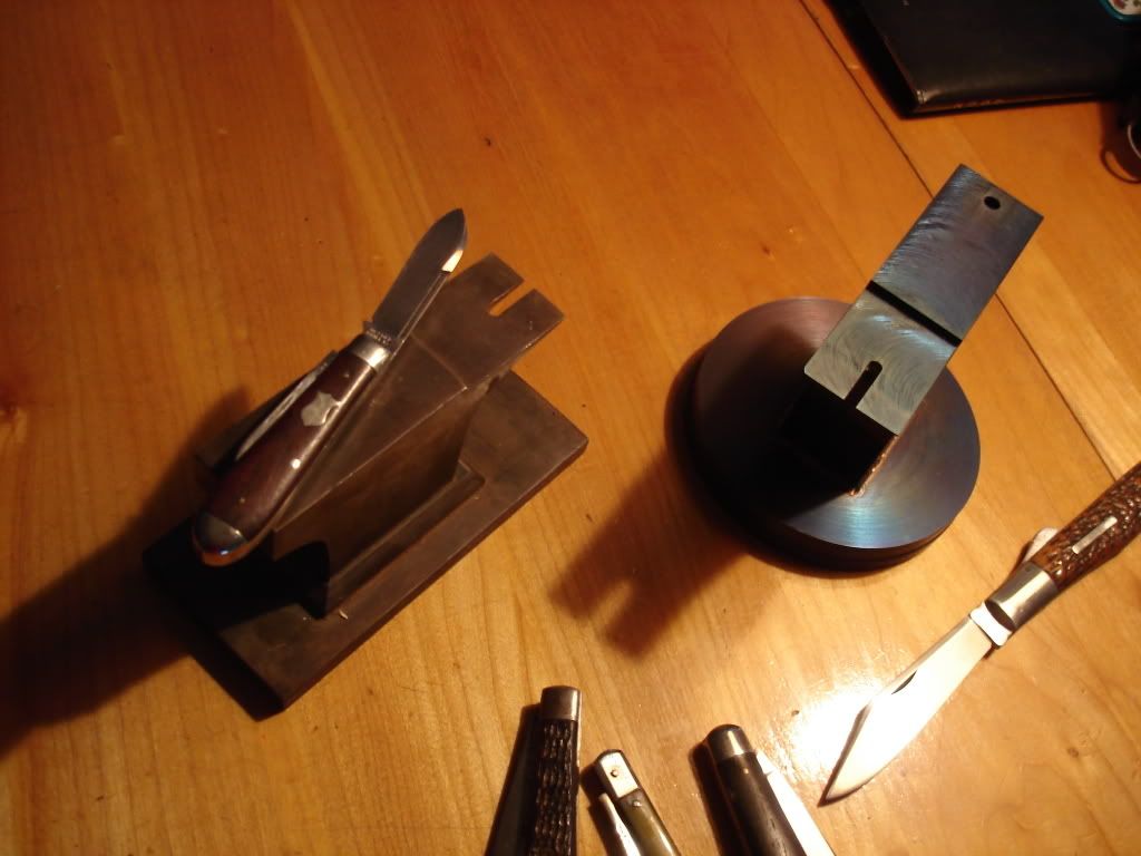

Is there a way to recenter a blade on a slip joint?
New Case Bose Lanny’s Clip for sale at local gun shop. It’s severely off center. Blade is practically resting on one side, knife is laid on its side. I’ll try and get pics of it. Just wondered if it could be done and if it would be worth the trouble- perhaps you'd achieve a little more help and guidance if you let members know what it is, who made it, and some photos.
Best o' luck![]()
I thought I was doing it right, but snapped a blade in a nice Remington Muskrat!!
Also, I brought a Queen special Cattle knife to Queen, where a pro cutler snapped a blade right in front of me, in two places!! You gotta know what you are doing, and sometimes it doesn't work out!!
(signed: Bladeless in Vancouver - not!!!)![]()
I've also done it successfully. Never broken a blade. But, this is a very small sample size. I don't like to test my luck... It took more force than I would've liked and it didn't change things as much as I would've liked. It also introduced blade play which I then had to tighten up in a vise, peen the pin a little bit, sand the bolsters flush, and polish.Yeah... I've done it a few times mostly just to see if it could be done by a hamfisted clod. My success rate is about 80% or so, I'd never try it on anything valuable. Lucky for me blade centering isn't high on my looooong list of obsessions, so curiosity satisfied is good enough.
I have a Case Bose Wilfred lockback with a blade that was rubbing one of the scales. I sent it in to Case and they fixed it, but it isn’t perfectly centered and can wiggle when closed. Also the lock felt very different after getting it back. It used to be crisp and now it is…chewy?
Hooy....I think lockbacks are a whole different animal to correct...NOT like the slipjoints...I have a Case Bose Wilfred lockback with a blade that was rubbing one of the scales. I sent it in to Case and they fixed it, but it isn’t perfectly centered and can wiggle when closed. Also the lock felt very different after getting it back. It used to be crisp and now it is…chewy?
I never considered that lockbacks should be treated differently. And, I had never seen this method. Added to my mental notebook, thanks for sharing that video!!Hooy....I think lockbacks are a whole different animal to correct...NOT like the slipjoints...
I'm not going to pretend to be an expert and hope someone better can chime in...but...to my understanding, 'some' lockbacks are designed in a way that the blade tightens when closed (no side to side movement) and loosen up (not by much) when closed (with side to side movement). My Case/Bose Lanny's, and Buck 110s are a good example of this.
On the other hand, some are tight, regardless of blade being open or closed. Some are loose open or closed. My Rough Ryders and a custom lock backs are the other examples.
I would think the way to correct blade centering on the above examples will differ depending which way it was designed/built.
