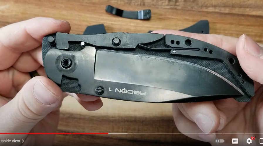

great....we all just encouraged David to make one better and build a knife I'm gonna buy from him down the road.....just what i need another recon 1 but improved on......thanks a lot y'all.......I just let gravity do it. I may not have mentioned yet in this thread that I also tweaked the lock spring stiffness so that the lock was easy to actuate, but still lock up solid. I one hand closed my modded knife by depressing the lockbar with my index finger positioned inside the finger groove where it would catch the tang and the blade closed with inertia, then closed it the rest of the way once I moved my finger. Worked just fine after my mods, and now that I've learned I can move plunge lines at will, I'm even more likely to redo one of these. There's no profit in this for me, it's just the hobby I have loved for the past decade. Will I get a MagnaCut one? Now I really don't know.![]()
But there is no question at all that it would work perfectly. Here are some YouTube screenshots, the last of which I have drawn the new plunge line and scale profile onto to demonstrate the soundness of the planned mods, and their compatibility with the one handed closing method I described above.
Of course, I know once I do it, I will eventually get rid of the knife unless I can come up with a way to do this to it as well:
But if I succeed in doing that, I will drill and tap the scales for tip down carry and actually carry and use it, because I will actually enjoy doing so.
David Mary , am I wrong,
or would removing that much material from the front of the scales expose the giant gap in the tang for the lock tooth and stop pin?
I assume that’s why it’s so large, to cover that when the knife is closed.
Fair enough.No.
Yes.
I guess only Andrew Demko knows if that's the actual reasoning behind it. But if that would bother someone, then needless to say they should not perform this mod.
Many of the other models have that gap, so not sure why they were worried about it on that one. Maybe as a selling point for military (reduce snagging and/or debris)?David Mary , am I wrong, or would removing that much material from the front of the scales expose the giant gap in the tang for the lock tooth and stop pin? I assume that’s why it’s so large, to cover that when the knife is closed.
Yeah, it seems to have been better addressed on other models like the American Lawman, which has a full finger choil in the blade, and the AD10, which has allllmost a full finger choil in the blade, and the point of the handle between the blade and the first handle choil covers that gap juuuust enough.Many of the other models have that gap, so not sure why they were worried about it on that one. Maybe as a selling point for military (reduce snagging and/or debris)?
